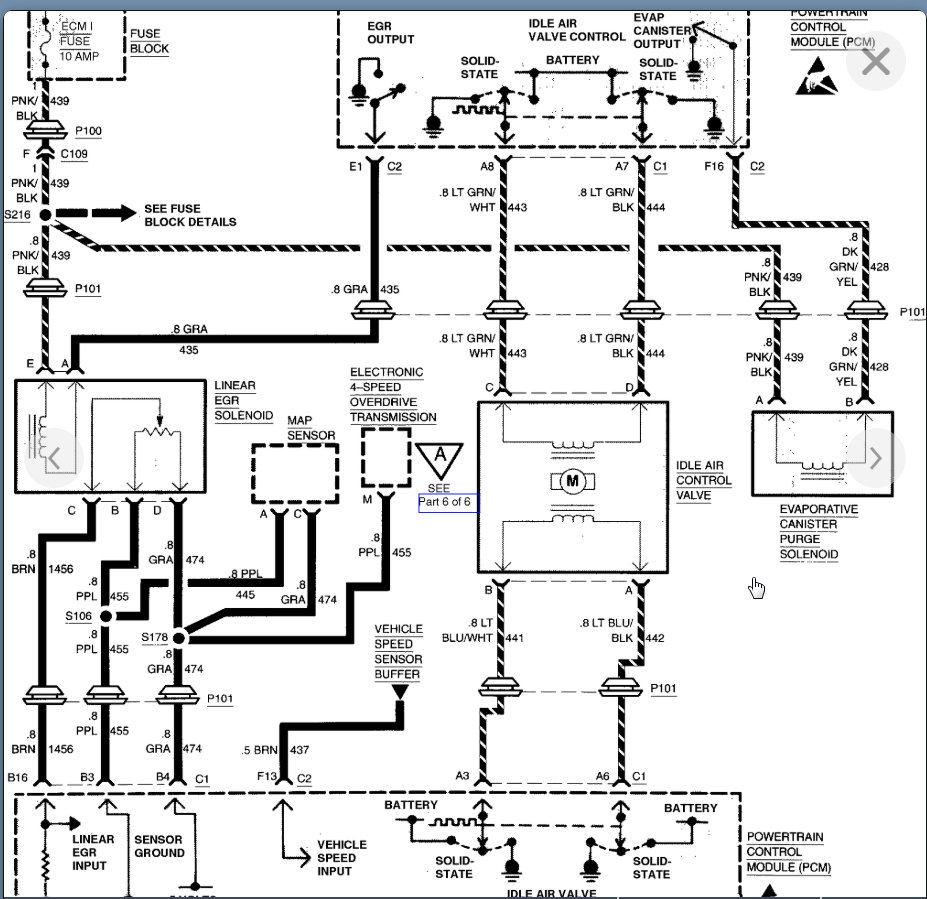

My van will run a good while but will shuts off after 20-30 minutes of just running on its own. When I think it's going to run just fine, I hop in, put it in drive and get about a block away then it will shut off and not start for a day or two. New pump and filter. I'm at a loss.

When it cuts off, does it restart right away or do you have to wait a bit?

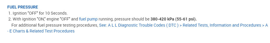

I am thinking we need to monitor fuel pressure while this happens just to make sure it is not dropping. Then I am thinking the Idle Air control valve could be your issue.
Also, this could be a PCM issue but we need to start eliminating things before we get there.

I am right now going to try to my best to give it a fuel pressure test I wanted out I went out and rented a kit and hopefully I can get some from that. Because I got nothing.

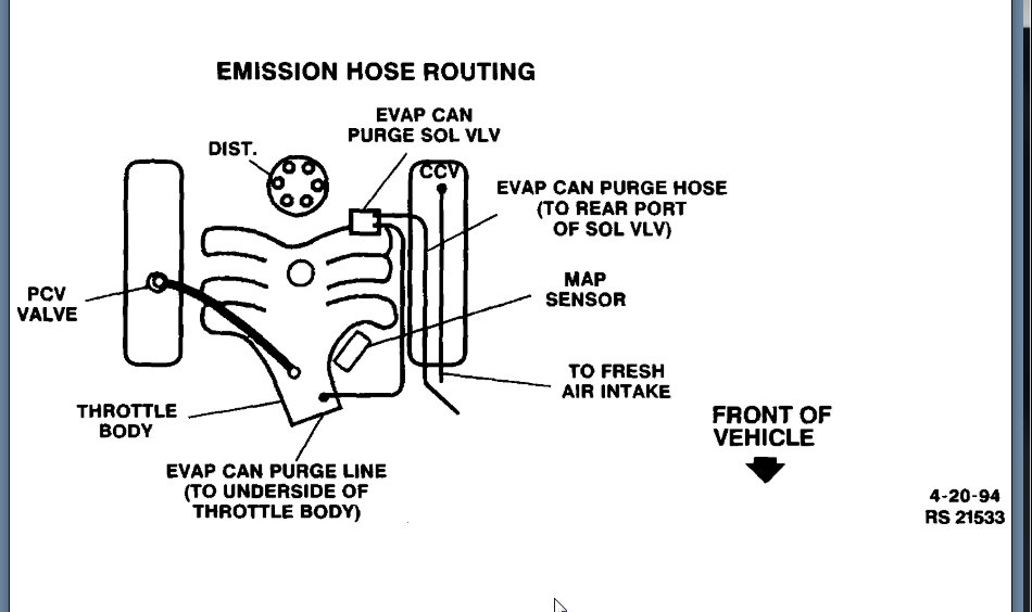

Also and not this has anything to do with what's going on for sure, but I do have a disconnected but seems to be vacuum hose coming from the transmission from top of transmission. I don't know if that's an issue or not, but it's not connected to anything. Looks like it's been cut off and I have no idea where it goes.
Saturday, January 11th, 2020 AT 1:21 PM
If by vacuum hose, you mean a rubber hose that they use for vacuum line, then more than likely this is a vent line.
I looked for any vacuum lines that may come off the transmission but didn't find any. Plus transmissions don't require any vacuum lines so I am sure it is a vent.
If you want to get a picture of it, maybe I can recognize it. Let me know what the fuel pressure is and we can go from there. Thanks
