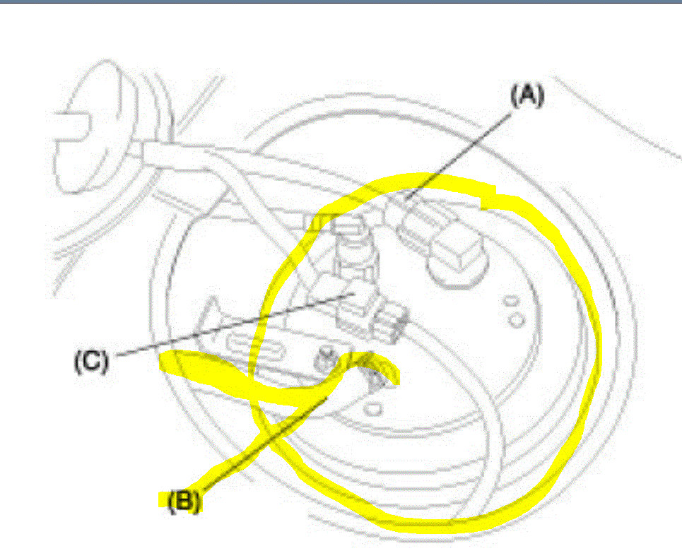

Tell me, has it been confirmed that it is the tank leaking and not one of the hoses from the tank? You can check it somewhat easily. Under the rear seat is an access port to work on the fuel pump. There you will see the fuel lines. I would first confirm it isn't one of them that is the problem and not the tank.
Once you remove the rear seat, you will find an access port. Open it and inspect the top of the fuel pump and around it to see if there are any leaks that are visible. Pic 1 shows what you will see. Letter B is the fuel supply line.

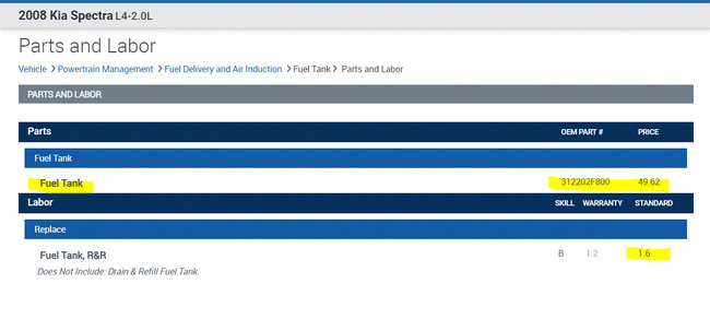

Even if the tank is bad, a new original equipment one is under 50 dollars (OEM part number 312202F800) and labor is under 2 hours (1.6 hours). Unless the vehicle is in really unsafe condition, I would likely fix it. I don't know the labor rate, but multiply it by 1.6 and that should tell you what to expect for a labor charge. There may be a few other miscellaneous things, but nothing too expensive.
If you look at pic 2, it shows the retail cost of the fuel tank and the number of hours allowed for replacement.

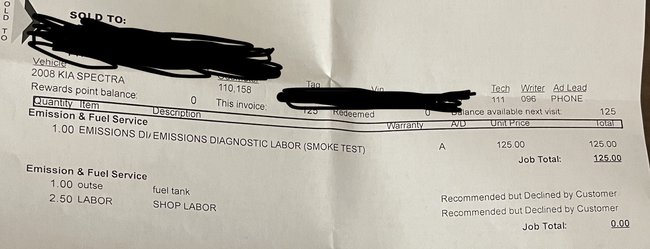

Here is what was on the invoice. Thanks.
Jan 26, 2022 at 5:34 PM
  • 110,194 POSTS
Hi:
Yes, the smoke test makes sense for the code. As far as the receipt is concerned, all I can tell is they charge $125.00 an hour and are indicating the tank and additional labor.
So, you own them $125.00. Let's say they double the price on the tank, $100.00. Then, charge an additional 2 hours labor, $250.00. That totals $500.00 including the diagnostics. If there is a broken hose in the EVAP system, it shouldn't be more than $50.00. Why are they telling you $1,400.00? That is what is upsetting me. The labor and parts costs I attached above are from a certified manual for parts and labor prices.

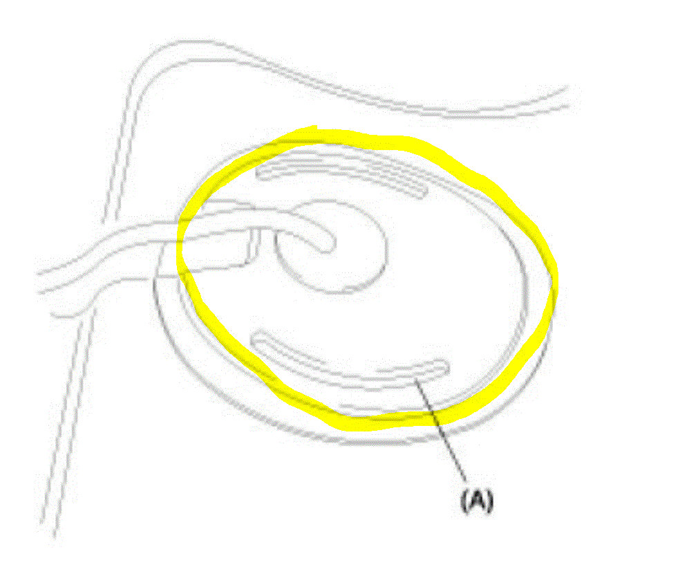

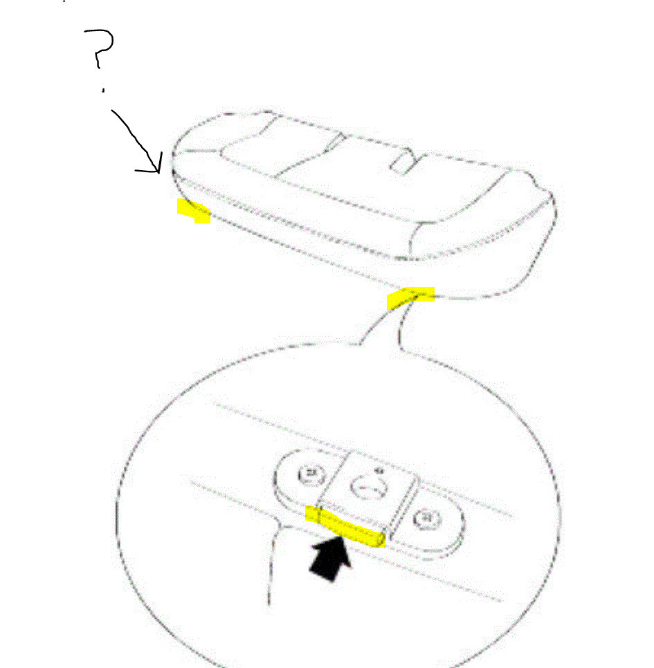

It has been some time since I've done one of these, but I don't think you need any tools other than maybe a screwdriver. There are release buttons for the seat cushion. There is either one or two of them. See pic 1 below.
Press the release button and pull toward you and then up to remove the seat cushion,

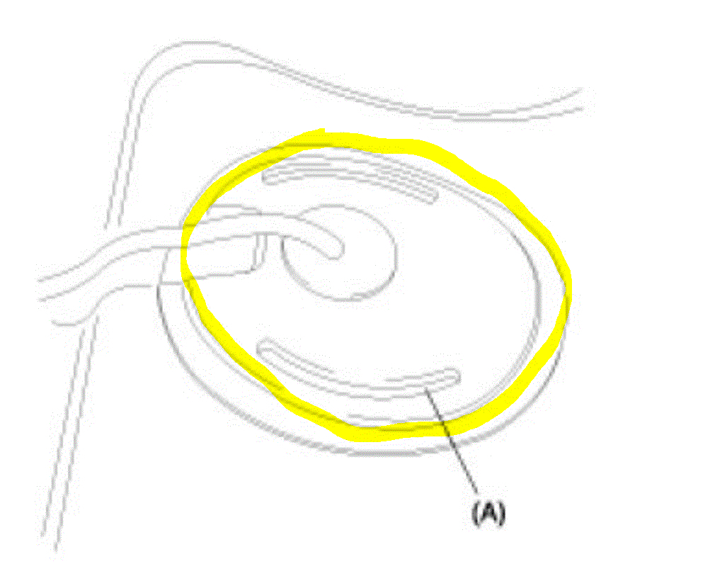

Once it is removed, you will see the access port. See pic 2. Some of these had a screw holding them and others were secured with an adhesive. If there is no screw, gently pry upwards at each corner with a flat screwdriver to remove it.
