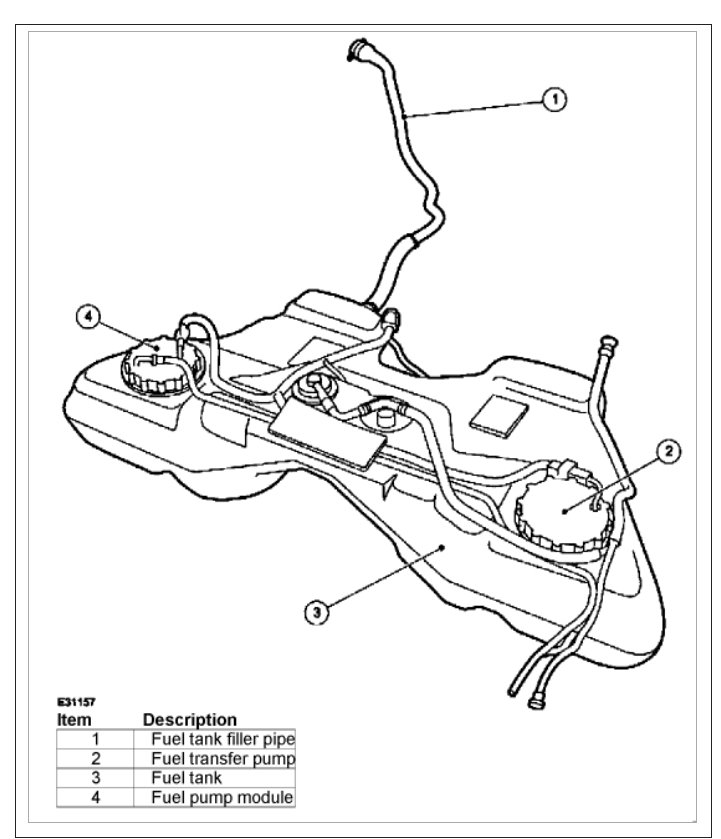

I found this information for you and diagrams below.
Fuel Tank
The fuel tank is of a plastic construction and is retained to the vehicle by means of two steel support straps. The fuel tank support straps are mounted onto the underside of the vehicle chassis towards the front of the fuel tank and bolt to the vehicle towards the rear of the fuel tank. Fuel tank ventilation is achieved through a fuel tank roll-over valve into an evaporative emission canister which absorbs fuel tank vapor. The fuel tank roll-over valve is integral to the fuel tank and will prevent fuel loss from the fuel tank if the vehicle becomes inverted.
Fuel Filter
The fuel filter is of a conventional construction being that of a paper element sealed within a steel canister. The fuel filter is located behind the left-hand front fender splash shield.
Fuel Tank Filler Pipe
The fuel tank filler pipe is of steel construction and is retained to the vehicle by means of one lower retaining bolt and three upper retaining bolts. The fuel tank filler pipe is fitted with a twist-fit filler cap, which seals the system.
Inertia Fuel Shutoff (IFS) Switch
The inertia fuel shutoff (IFS) switch is designed to cut power to the fuel pump in the event of an accident. It is located behind the left-hand cowl side trim panel.
Fuel Pumps
The fuel pumps are electric turbine type pumps and are located inside the fuel tank, one on the left-hand side and one on the right-hand side on supercharged vehicles-. They both feature an integral fuel tank sender unit and each is retained to the fuel tank by means of a locking ring.
As the fuel tank is of a saddle design, a fuel pump module and a fuel transfer pump are incorporated. The fuel pump module located in the right-hand side of the fuel tank transfers fuel to the left-hand side of the fuel tank. The fuel transfer pump located in the left-hand side of the fuel tank transfers fuel to the fuel pump module and then the engine.
