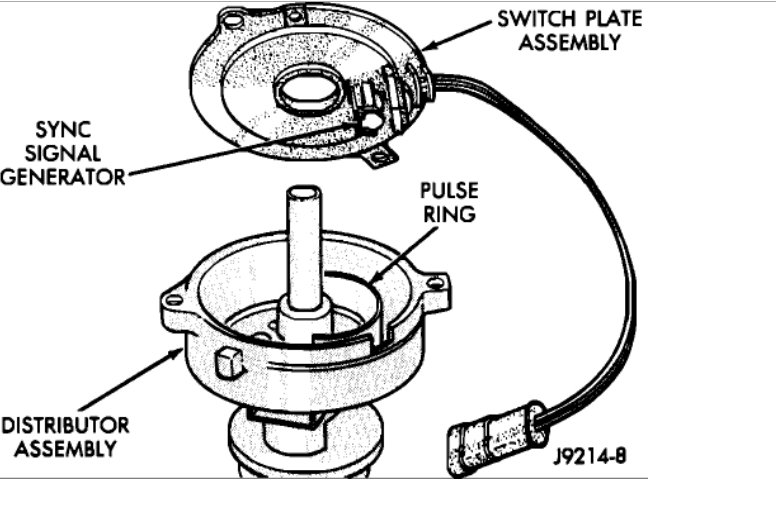

The Dodge B350 van will run at idle for ten to fifteen minutes then shuts down. It will not start for one to two hours then will crank and again. Shut down after the engine heats up to normal operating temperature. No smoke in exhaust smooth running. Replaced relays for fuel system. The van had been sitting up for five to six years prior to me purchasing it recently. Fresh gas and fuel system additives were put in the tank. What can be checked now? No check engine light and no codes will cycle through after turning ignition switch on -off on- off -on.

The best suspects are the crankshaft position sensor and the distributor pick-up assembly. Those often fail by becoming heat-sensitive, then they work again after cooling down for about an hour. When there is no fault code to direct you to the circuit that needs further diagnosis, you need a scanner to watch those sensors while you crank the engine. They will be listed with a "no" or "present" to indicate whether their signals are showing up at the engine computer.

Thanks, I will look for it on eBay. The engine is a 1992 / 5.9L/TBI, I looked for the crankcase position sensor and could not locate one. Does a TBI engine have this sensor?

The crankshaft position sensor is located inside of the distributor.
Here is a diagram so you can see what I am talking about (below).

There should be a second one in a notch in the transmission bell housing, right behind the right cylinder head. Not all engines used both of them every model year. I never memorized which ones use one and which use two.
