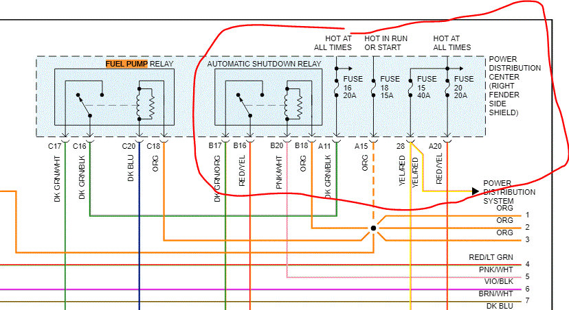

I don't get any fuel pressure. I changed the relay, and pump. I checked for clogs.
I am wondering if it is the security, and it is in the "no-run" mode.

Does the security light stay on? If not, then I don't think we have a security issue. Have you checked fuel pressure and if so what is the PSI? Also, confirm a fuel issue by using starting fluid in the intake and see if it fires.
Clearly it appears you are sure this is a fuel issue but we just need to double check.
As for overriding the security system, you can just do an internet search for PCM's that delete this system. I have not had success with these so I would not recommend it but others say they work.
Let us know this info and we can go from there. Thanks

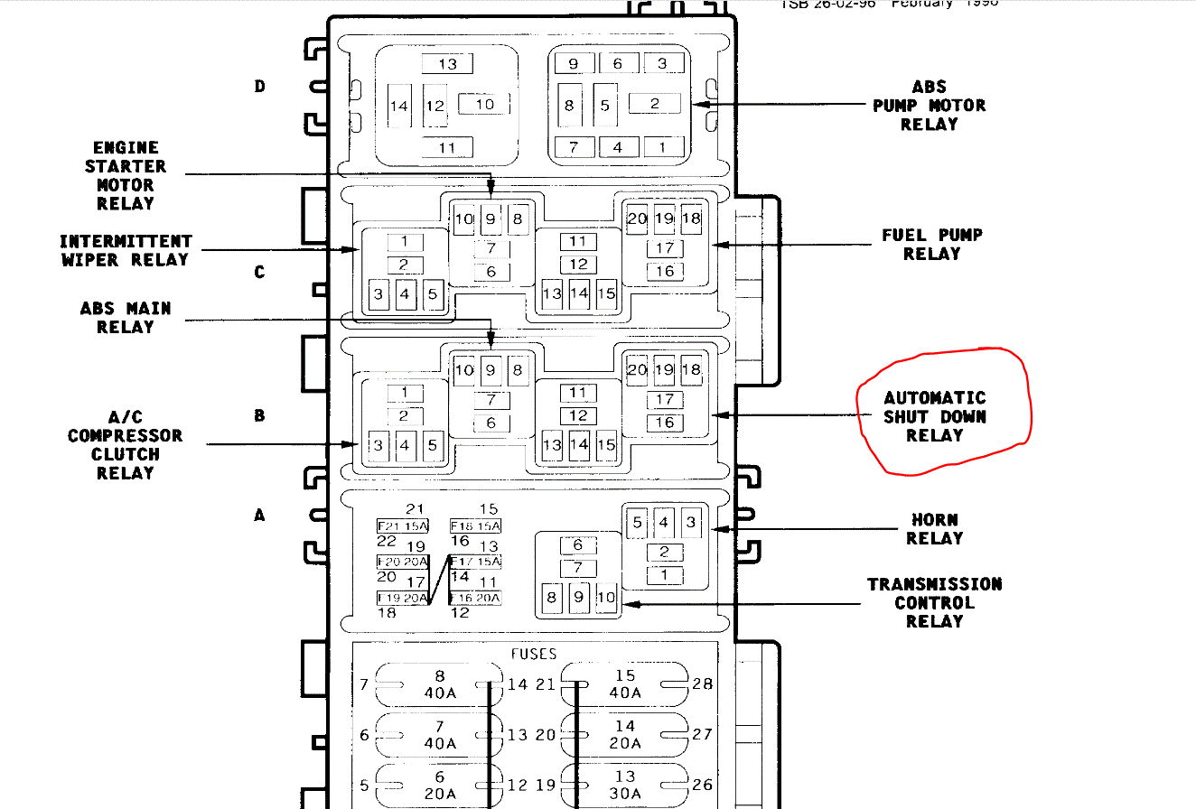

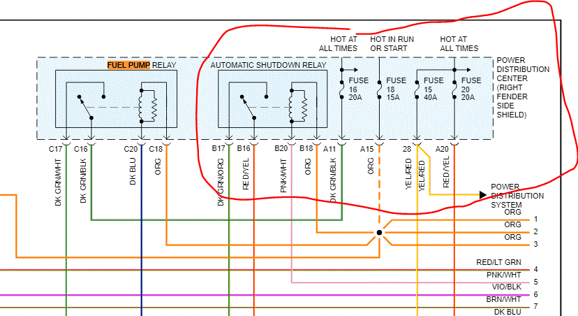

Have you checked the automatic shut down relay? It is near the fuel pump relay? (see pic 1)

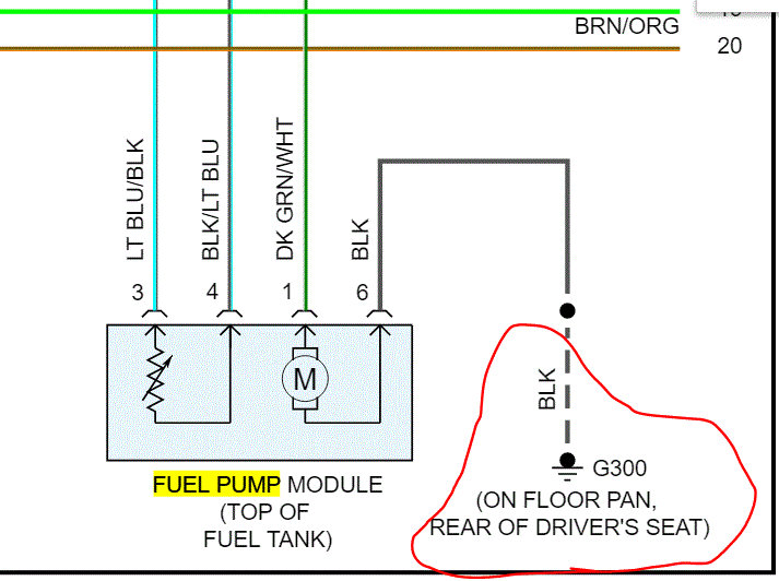

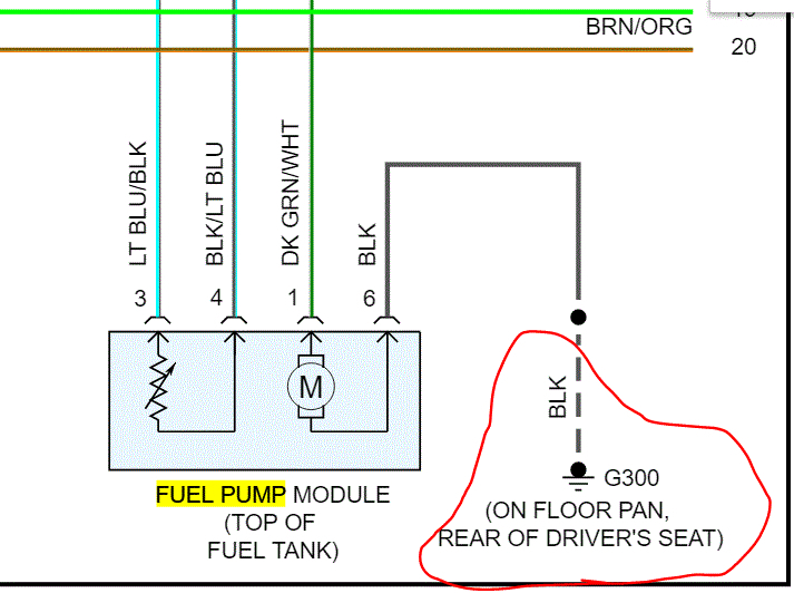

Also, Check the fuses in pic 2 and the ground in pic 3.
