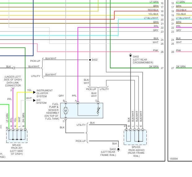

I'm wiring up a new fuel pump and I got to plug up a 1999 GMC Jimmy and the wiring colors don't match up to my 2002 Chevrolet S10 pickup. I was wondering if anybody could help me. The colors on the truck are black and orange, gray, purple, and black and then all my new plug or gray, purple, black, and black and white.

The truck listed above is a 6 cylinder not 4.

Sure, here are the wiring colors that go to your truck's fuel pump just make sure the correlating colors match up to the plug. Check out the images (below). Let us know what happens and please upload pictures or videos of the problem so we can see what's going on.
