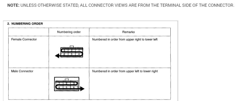

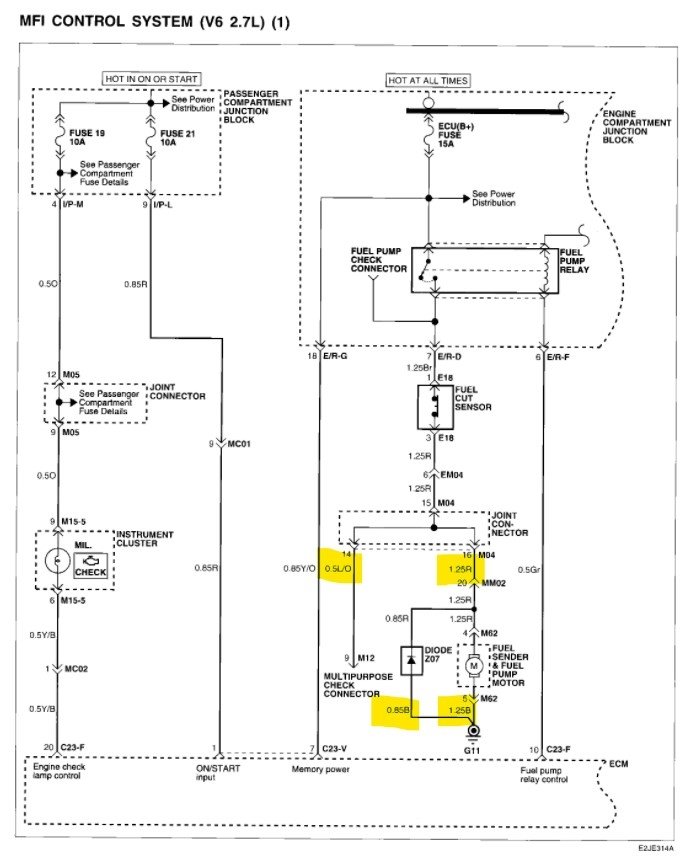

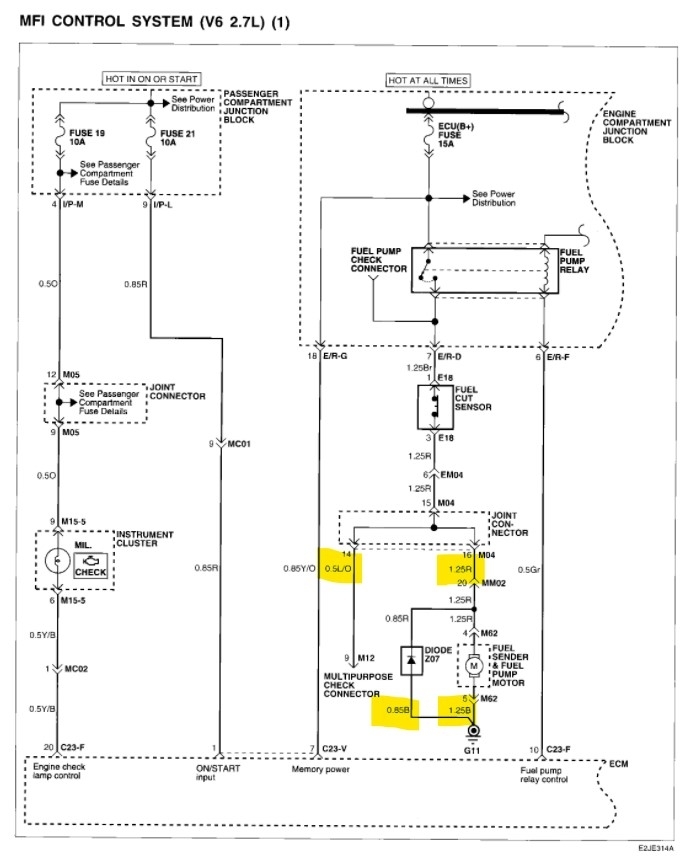

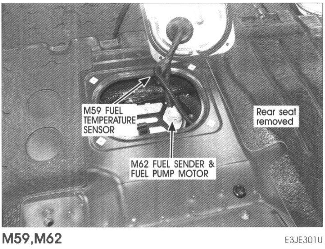

I removed the five-wire plug and three of the wires red, black and pink I think are not connected. I need to know where the five wires go in the tank plug.
Feb 20, 2022 at 4:04 AM
WENDY W
  • 86 POSTS
Hello!
I’ve attached diagrams for the fuel pump motor and sender unit (below).

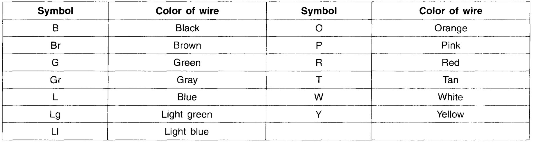

I don't see a pink wire at the connector. Is it possible it could be faded red?
It seems like the wiring order could be:
1. Blue with orange stripe
2. Blue
3. Black
4. Red
5. Black
Please feel free to attach a photo of your connector and wires.
