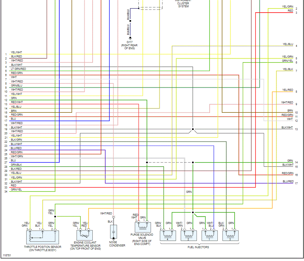

Originally suffered head gasket failure but was reluctant to start with ­out a spray or two of ether, once running it be fine until turned off then it just cranks with the odd backfire pop in manifold.. Checked timing checked firing order etc. But once started it will run fine.

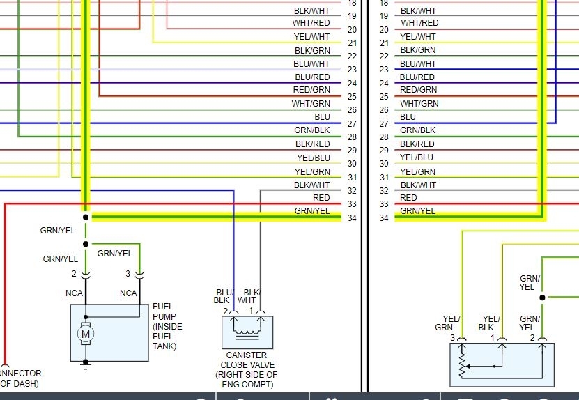

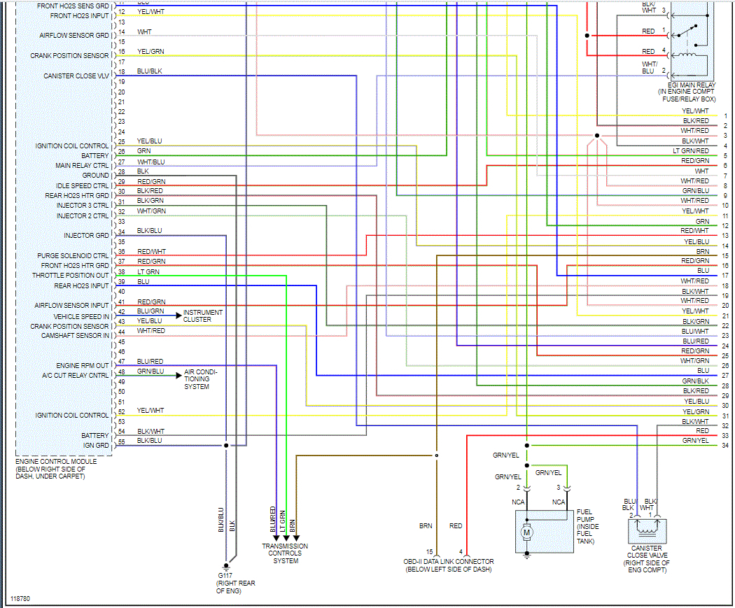

Now, I attached a small portion of the fuel pump wiring schematic. The schematic simply shows the power supply and ground. There are several things that tie to the pump, but I don't believe that is the issue.
If you could, let me know if the first link helps and if you can check fuel pressure. As far as testing the ECT, you need a live data scanner that shows the temperature the ECT is indicating and then comparing it to the ambient temp.

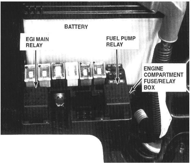

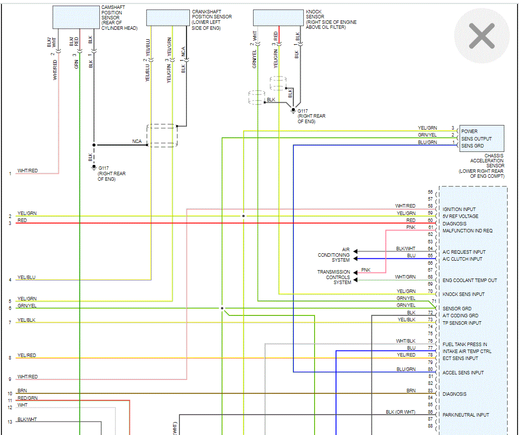

Last, I suggest checking the fuel pump relay. I attached a picture of it (pic 2). It's near the battery. Here is a link that shows how to check the relay:

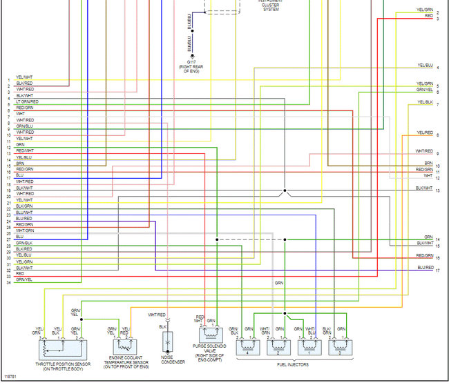

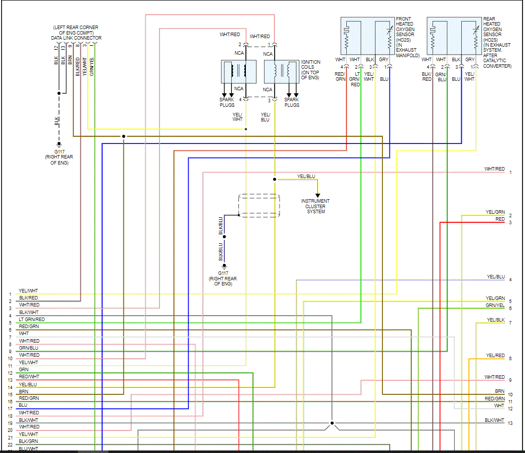

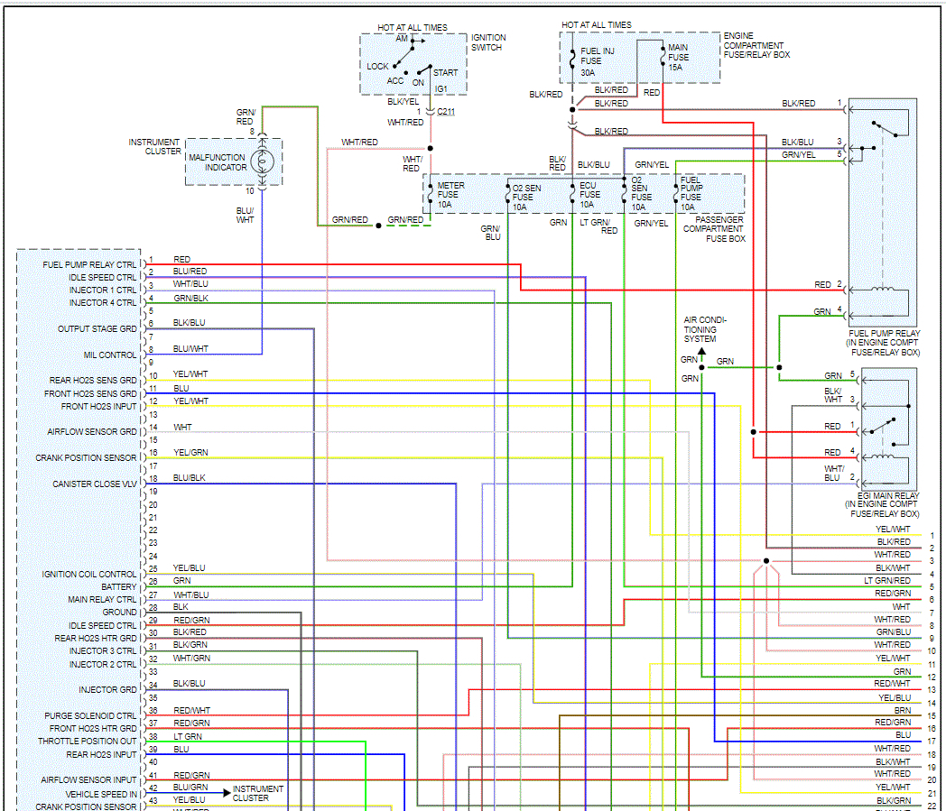

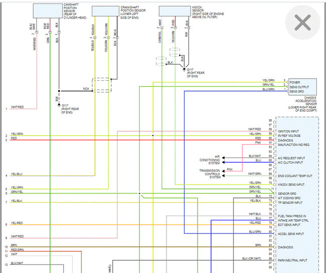

Hi:

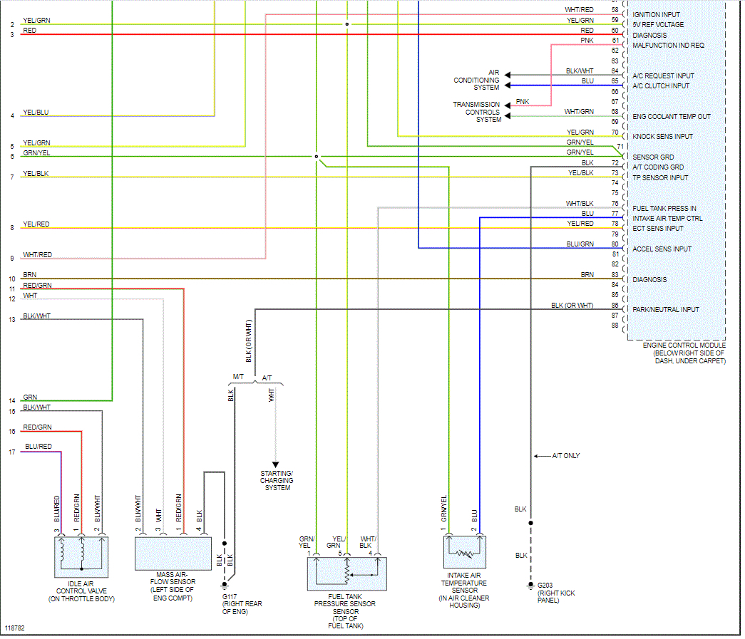

I thought I would add the entire powertrain management system for you. I had to cut the pics in half to make them readable. I did overlap them so you can follow them easier.
I hope this helps.
