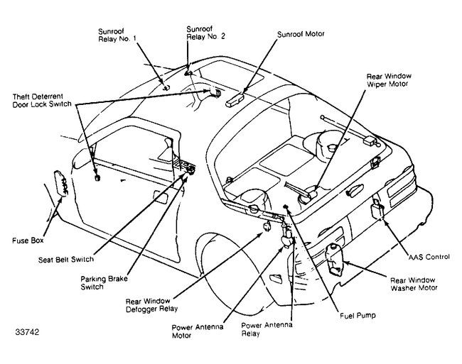

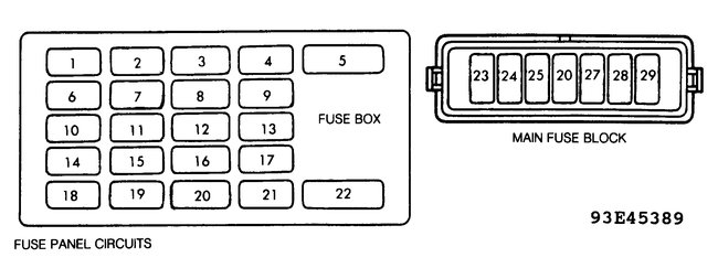

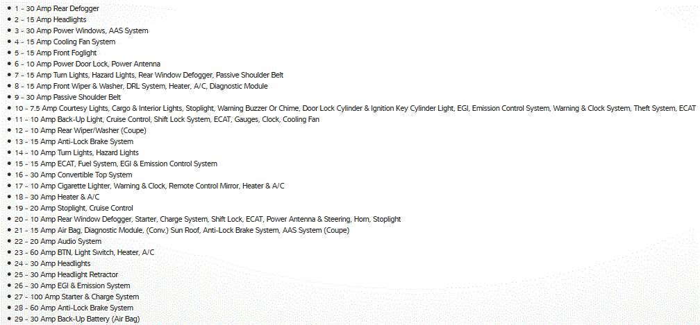

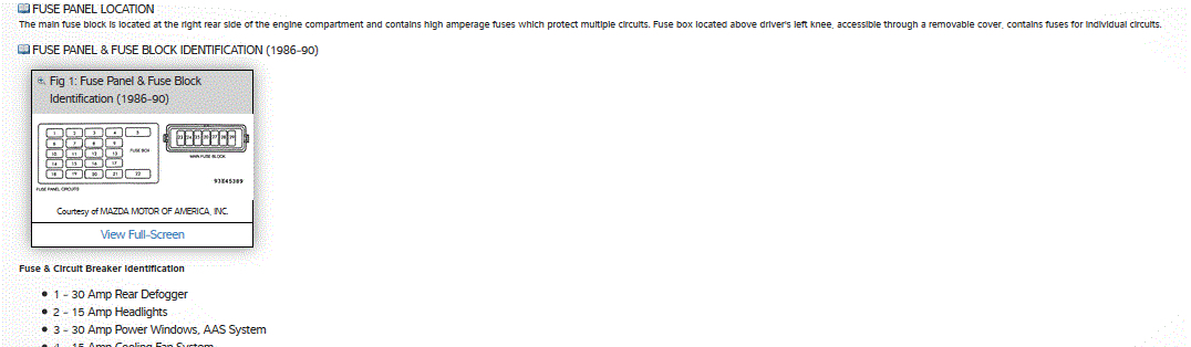

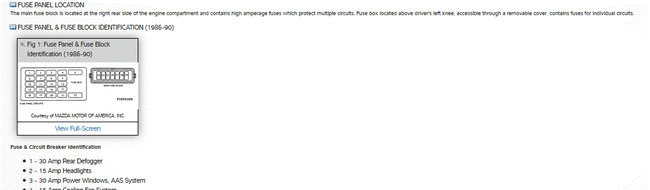

Always start with the simple things first. Personally, I'd check to make sure that that test connector is receiving power. Just probe it with a multi-meter and see. Also, check your fuses. Particularly #15. A blown fuse there and your car will be dead in the water. Then, just because you have power to the fuse doesn't mean that you have power at the pump. So you'll have to check for 12 volts at the connector while someone turns the key. If there isn't 12 volts consistent power, then the problem isn't your pump, it's in the wiring somewhere.

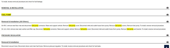

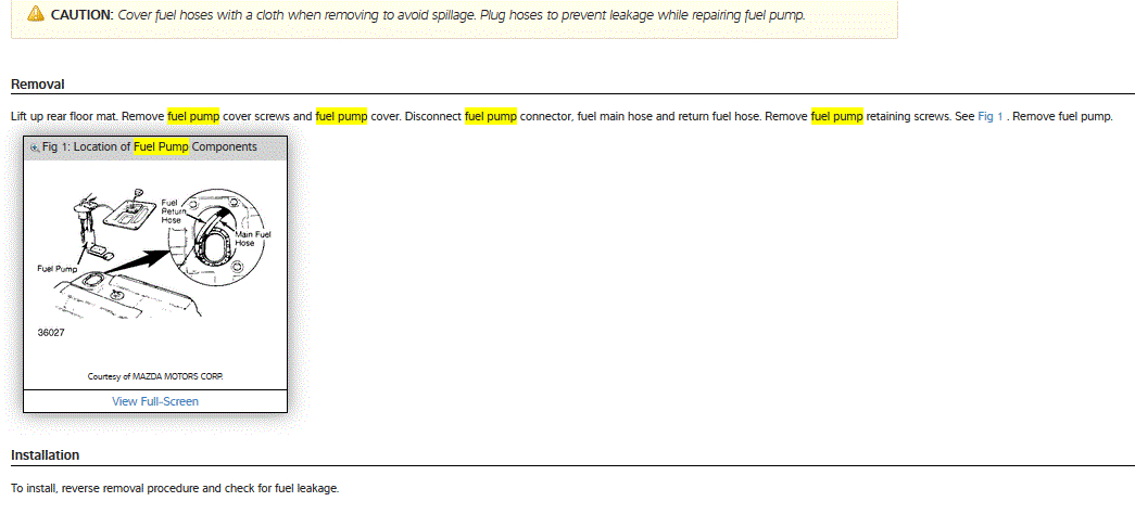

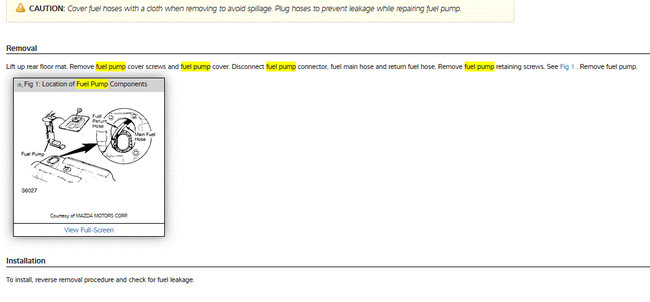

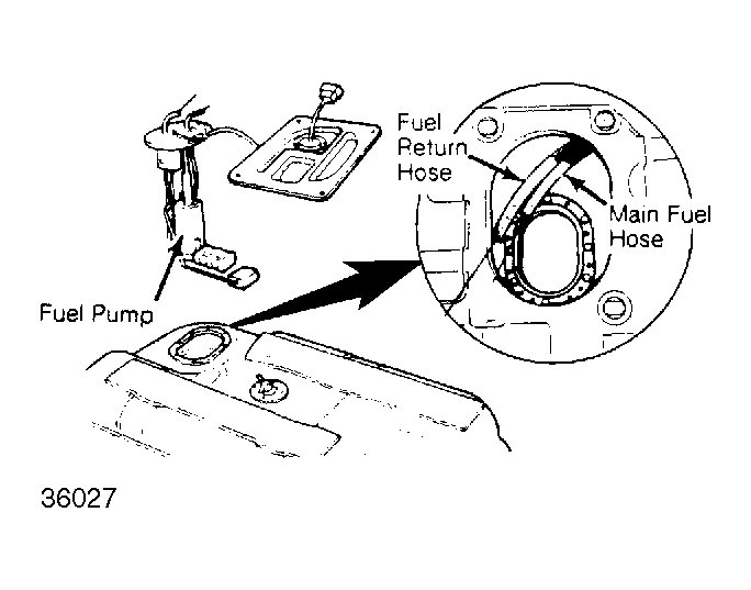

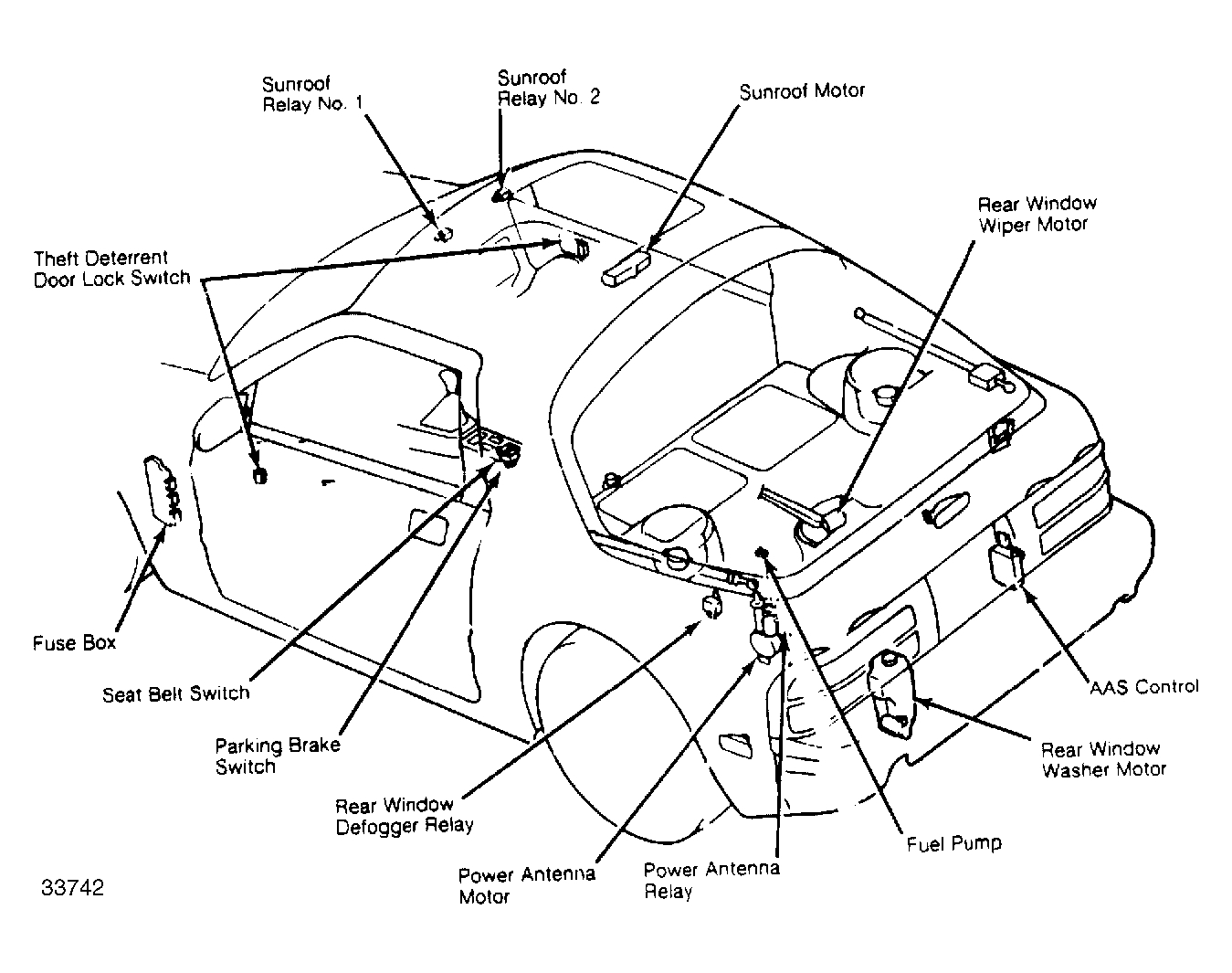

As for testing at the pump, the good news is that you don't have to drop the fuel tank to test it out. I've attached all of the pertinent information in the images below. Let us know what you find and we'll move on with troubleshooting.

1987 and 1988 are both S4 cars, so they should be the same setup. If you're able to jump the prongs and get fuel flow from the pump, then that means that the pump is working on some level. If memory serves, these pumps should put out somewhere near 80 psi. So, in short, it wouldn't just be flowing into a bottle/bucket/catch pan. It would be spraying in there with real force. On my old 2000 Chevrolet Blazer (which puts out about 60 psi), when the fuel line popped off (previous owner didn't get it clipped in right), that sucker sprayed gas a good ten feet forward. So 80 psi would really spray with force.
Now that I looked it up, the fuel pressure should be between 64 and 85 psi for a non-turbo car, and between 71 and 92 psi for a turbo car. So basically, it would spray like a fire hydrant.
If it didn't spray like that, then I'd highly suggest borrowing a fuel pressure test gauge from the local auto parts shop and running the proper fuel pressure test. I can't seem to find any pictures of the fuel rail, but if there's a valve on there, then what you'll do is relieve the system of it's fuel pressure. Start the car and then pull the fuse for the fuel pump. The car will die. Then crank the engine for a couple seconds, at least five times. Next, hook up the fuel pressure gauge to the valve. Turn the key on for two seconds, then off. Turn it on again and observe the pressure reading. If it's not high enough, then it's time to replace the pump and filter.
Check it out and let me know. We'll go from there. Good luck.

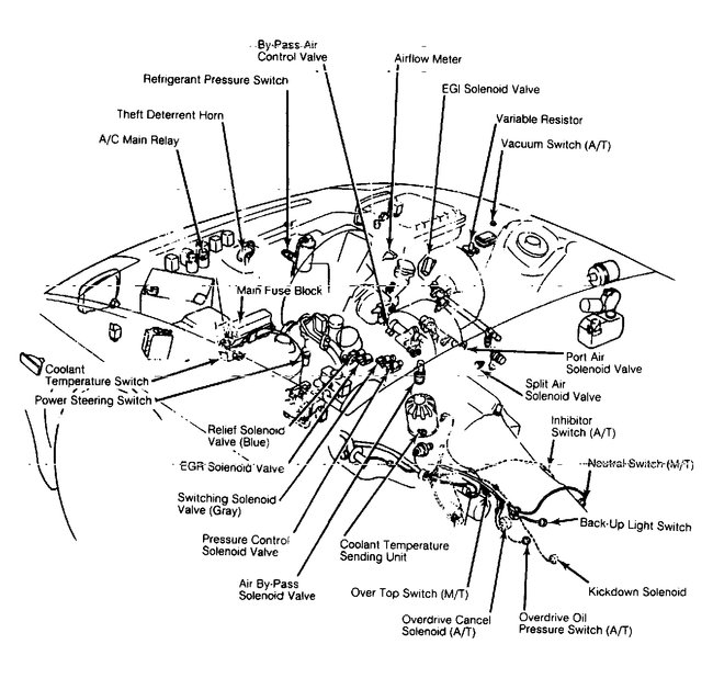

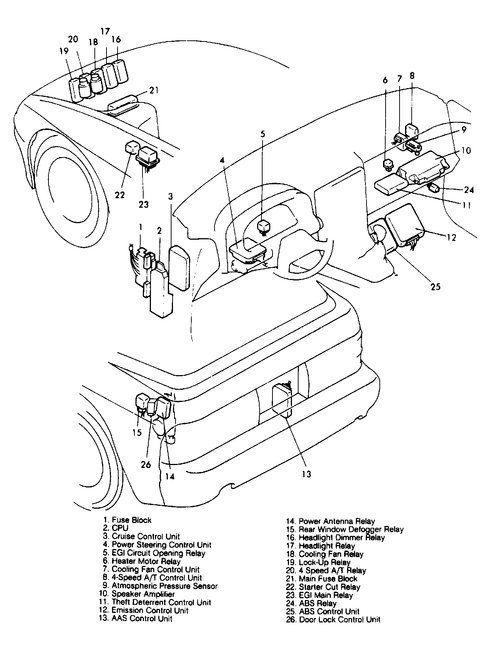

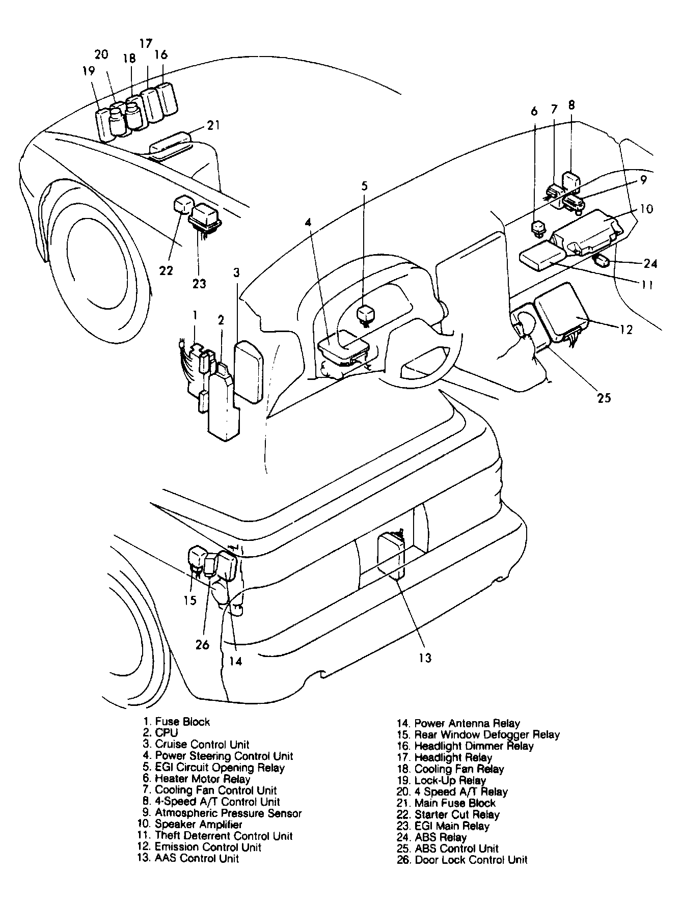

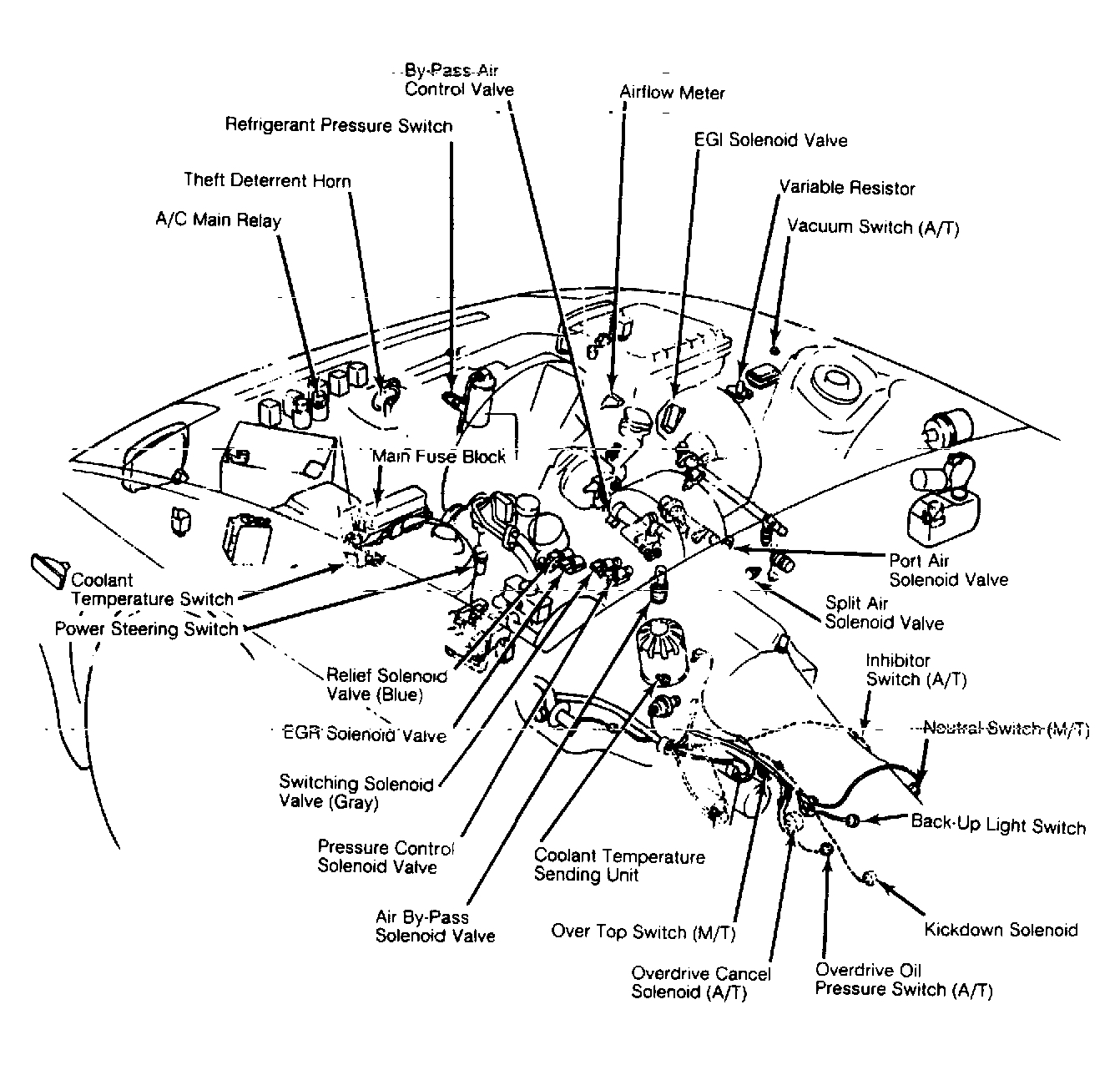

I wanted to give you an update of what I found. Under the hood, near the coolant reservoir, a relay with its cap bolted in that area often comes out of its cap. I reinserted the relay back into its cap (but it is still susceptible to come off its cap, need to secure it tightly later). After I recapped the relay, I was able to get the car started. Is that relay related to the function of the fuel pump? Assuming it is: why would the cap off prevent the relay from doing its job? Ground maybe?
Jan 13, 2019 at 2:10 PM
HARRY P
  • 2,292 POSTS
Hmm, I'm having a hard time finding it. Do you see it in any of the attached pictures? Also, is this a turbo car? Or any trim level for that matter?
