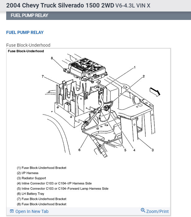

Would I be able to take a hot wire ran directly from my battery to my fuel pump so I can have a switch to manually turn my fuel pump on/off? Would my truck still run if I did this?

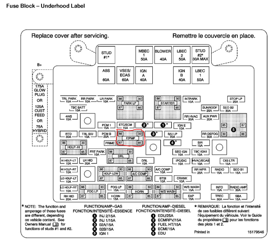

If it started this issue after the ignition switch replacement, then it is likely the issue is with the switch. Could have a shorted pin or not getting proper connection.
Also have you checked the fuel pump relay?
It is in the under-hood fuse box.

Hi folks. SQM is right about running a hot wire being dangerous. That can lead to a serious fire hazard and liability issues. Might I suggest considering whether the ignition switch hasn't been learned or programmed, and the system is in theft mode? That shuts down a number of systems including the fuel pump. Hot-wiring one circuit isn't going to get the others up and running. If you can hear the hum of the fuel pump for one or two seconds right after turning on the ignition switch, that proves the entire pump circuit is okay and the Engine Computer has control of it. That makes the fuel pump a valuable observation or clue, but not the suspect circuit.
