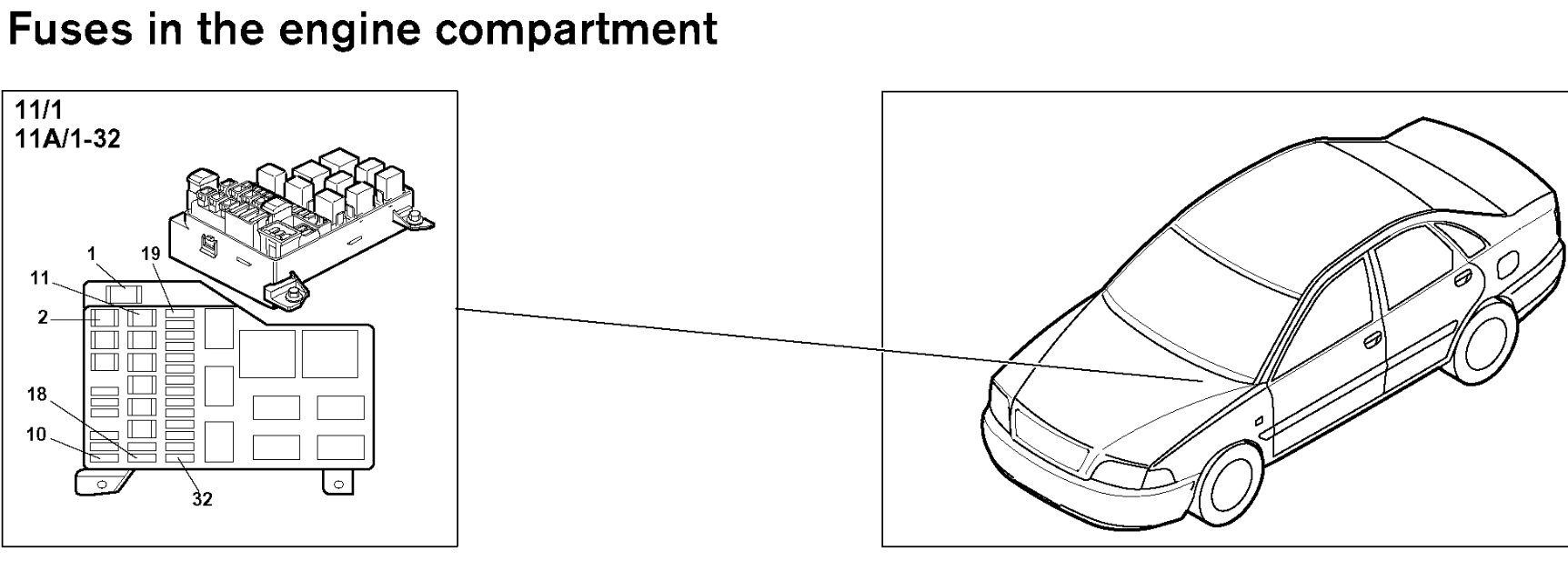

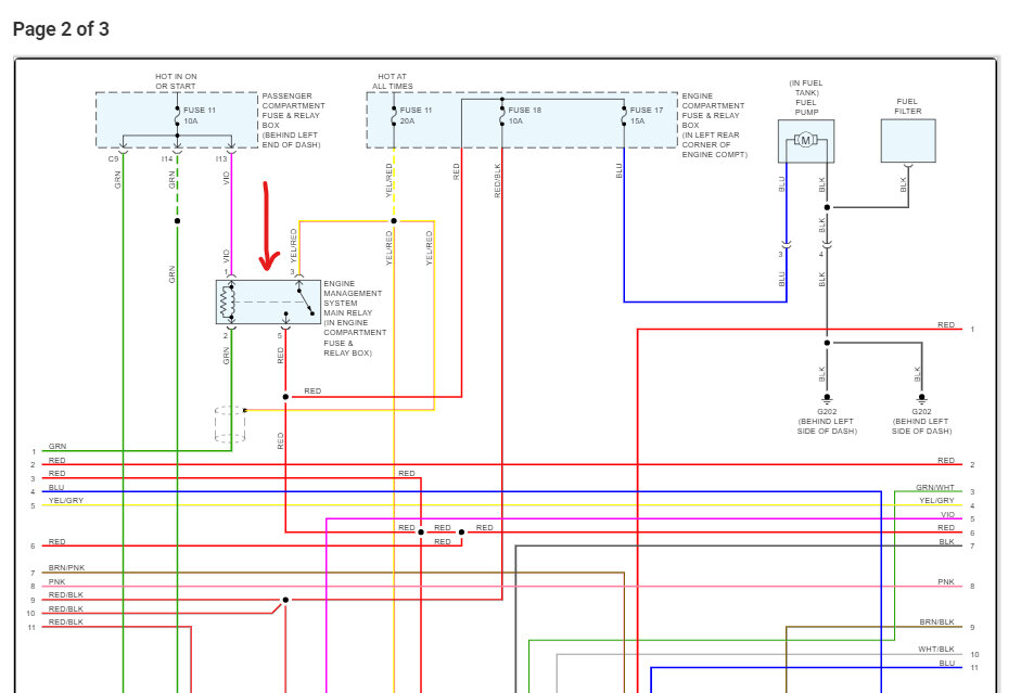

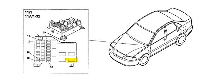

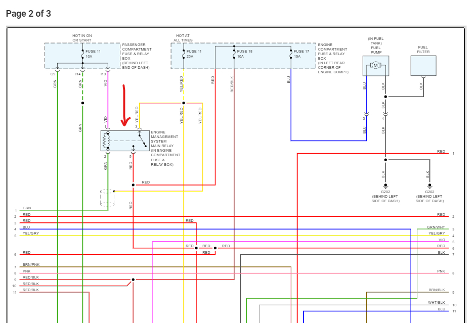

This car does not have a fuel pump relay instead the engine management relay controls the fuel pump, here is the wiring diagrams for the fuel pump so you can see what I am talking about and the relay location as well. Check out the images (below). Please let us know if you need anything else to get the problem fixed.

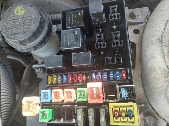

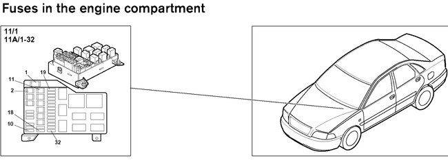

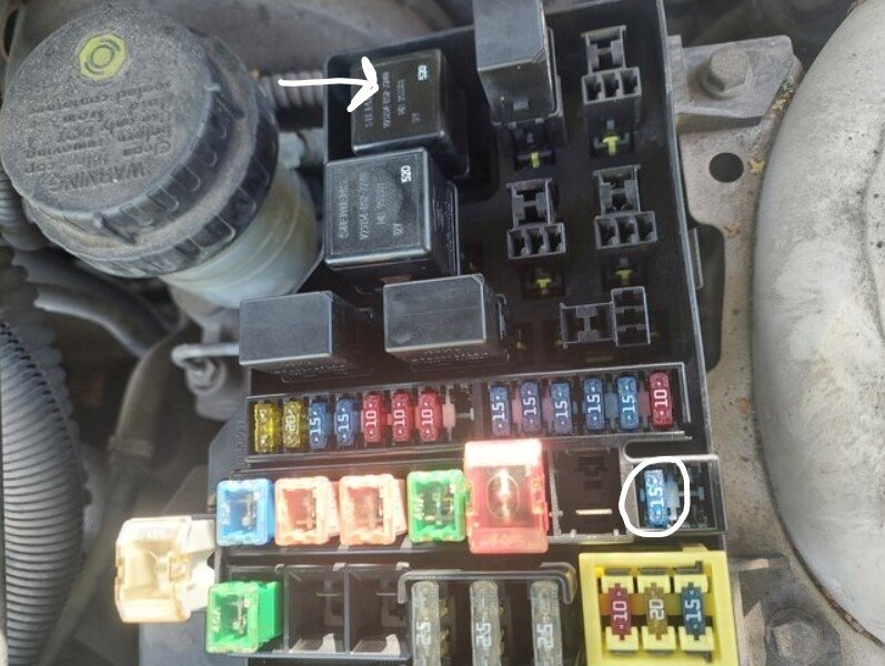

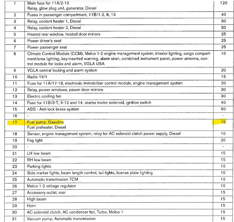

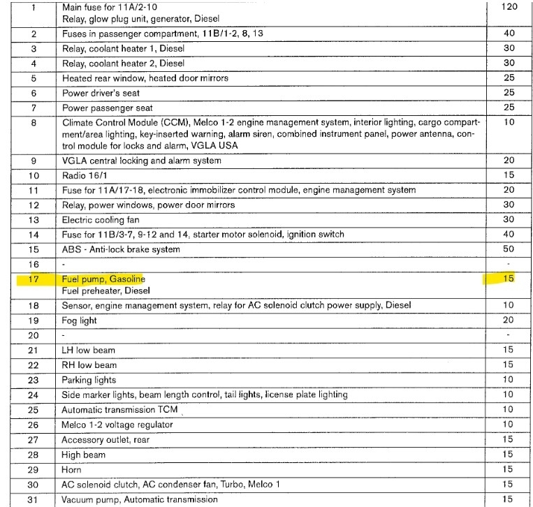

The relay is located in the engine management fuse and relay box, which is in the left rear corner of the engine bay. The relay is labeled R9, and the fuse for the pump is #17. I attached some diagrams below to help, and highlighted where they are. Also, please refer to the guides below in case you get stuck.

As you can see there are multiple configurations for your car, and Ken's answer seems to match your configuration. There is no dedicated fuel pump relay for this configuration, instead it is controlled by the engine management system main relay. This should be relay R7 in your picture, I wrote an arrow pointing to it below. Also check fuse 17 for power going to the pump. If both of those are good, we should check voltage at the fuel pump connector.

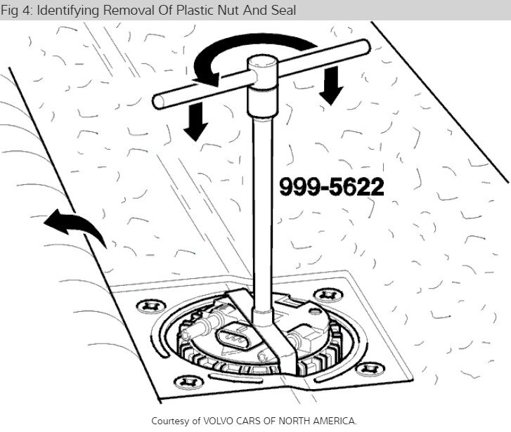

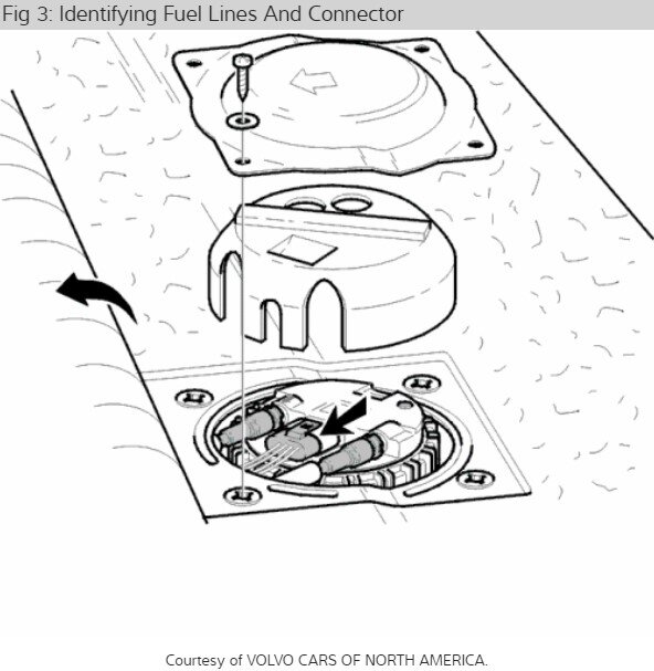

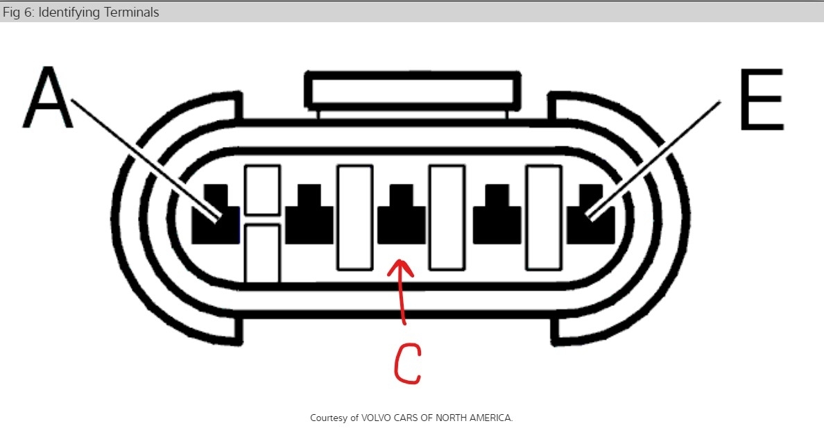

You can test the pump at the connector by removing the rear seat cushion. You should be able to lift it straight up, or at least push in and lift up at the same time. I attached some diagrams for you below. When testing the pump make sure the voltage between terminals A and C have approximately 5v.
If you feel like you need to remove the plastic nut for clearance (second picture), just use a screwdriver and a hammer and lightly tap it left to get it started to release it.
