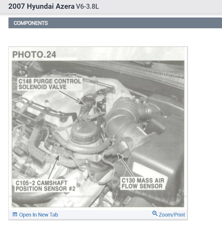

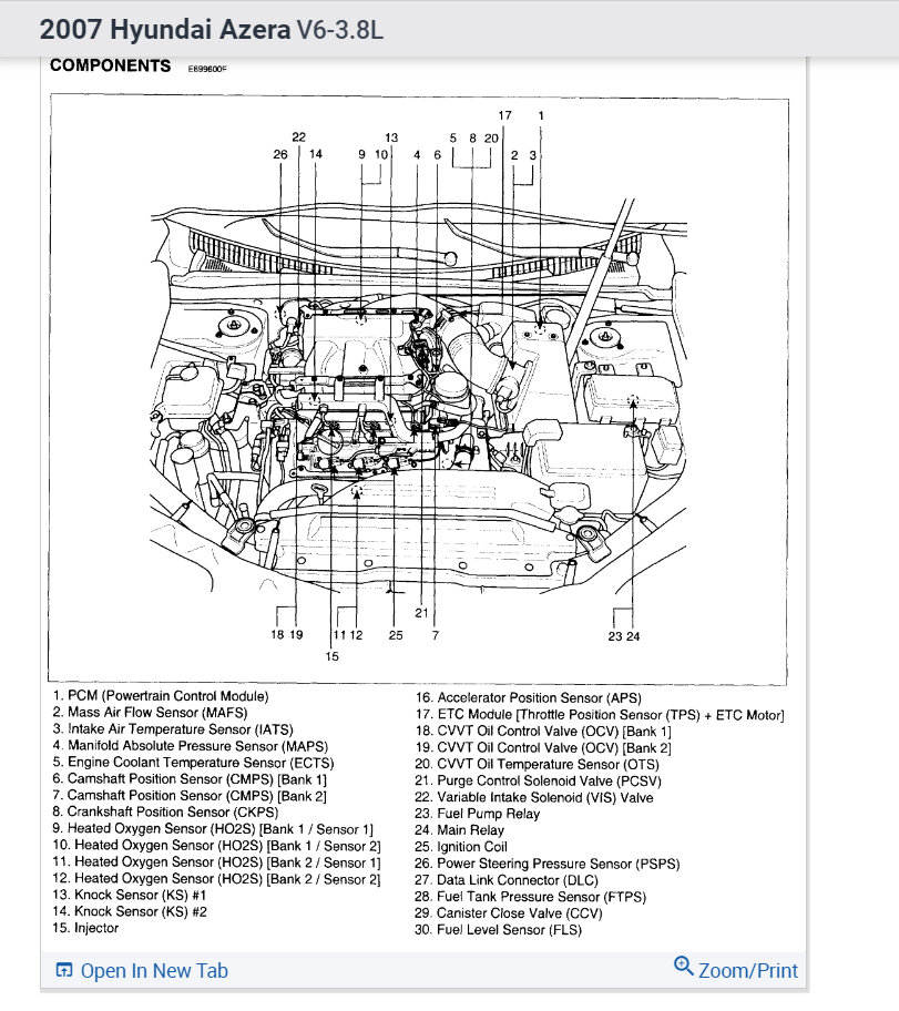

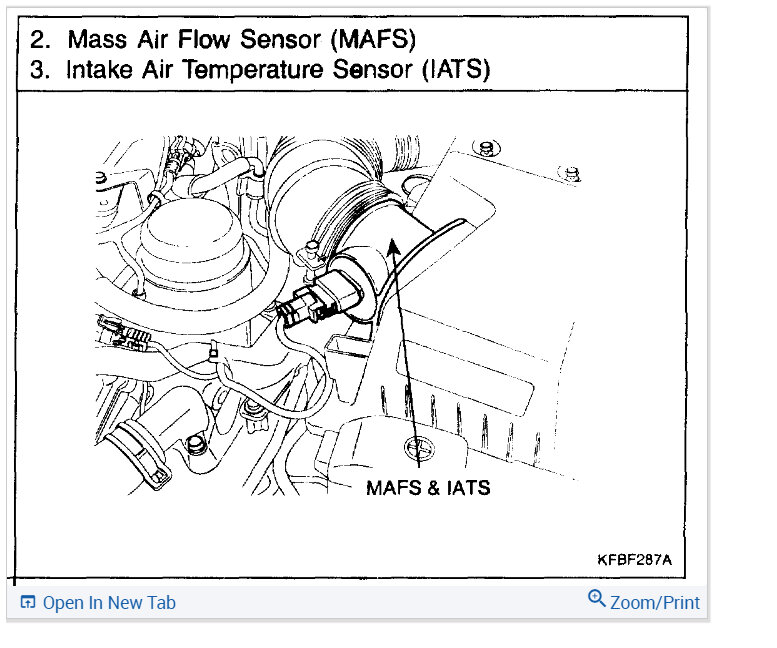

If so, I would run the codes to see what comes up, but I can tell you I have seen a bad MAF sensor cause the fuel pump not to turn on. Also check all fuses and ground leads that attach to the engine and battery.
This guide may help as well:
https://www.2carpros.com/articles/car-not-running-advanced
Here is the location of the MAF sensor, try to unplug it to see if the engine starts. Check out the images (below). Please let us know what happens.

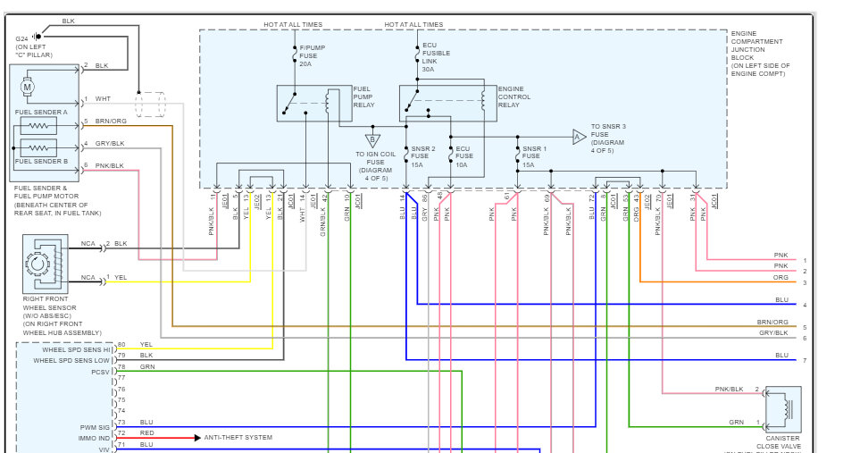

Okay, I have spark from the ignition. I chose to check the fuel pump by going to the fuse box under the hood and taking the fuel pump relay out and us in a bypass wire I used the wire by putting one end into the hot contact slot and routing to the positive flow slot to the fuel pump. The fuel pump came on and distributed fuel to the motor and allowed the car to start. I'm not sure but I'm thinking that the relay may be bad, so I took the relay from the same car I took the motor from and swapped the two but still a week power flow to the fuel pump. I just don't know what else to do be sides chasing wires from fuel pump to fuse box to see if they are touching
Apr 27, 2023 at 2:42 PM
  • 55,051 POSTS
I would check for power at the fuel pump you could have fuel contamination, or a bad fuel pump this guide can show you how.
Here are the fuel pump wiring diagrams so you can see which wire to test for power. (White wire) test the wire while cranking the engine over.
