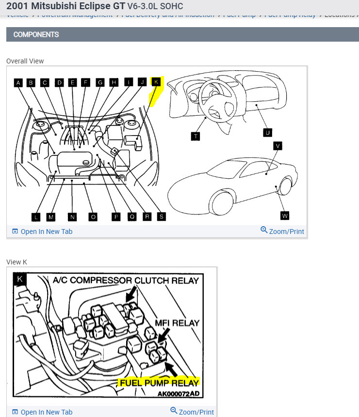

Fuel pump is not coming on and car will not crank.
Mar 9, 2022 at 9:09 AM
SQM
  • 6,383 POSTS

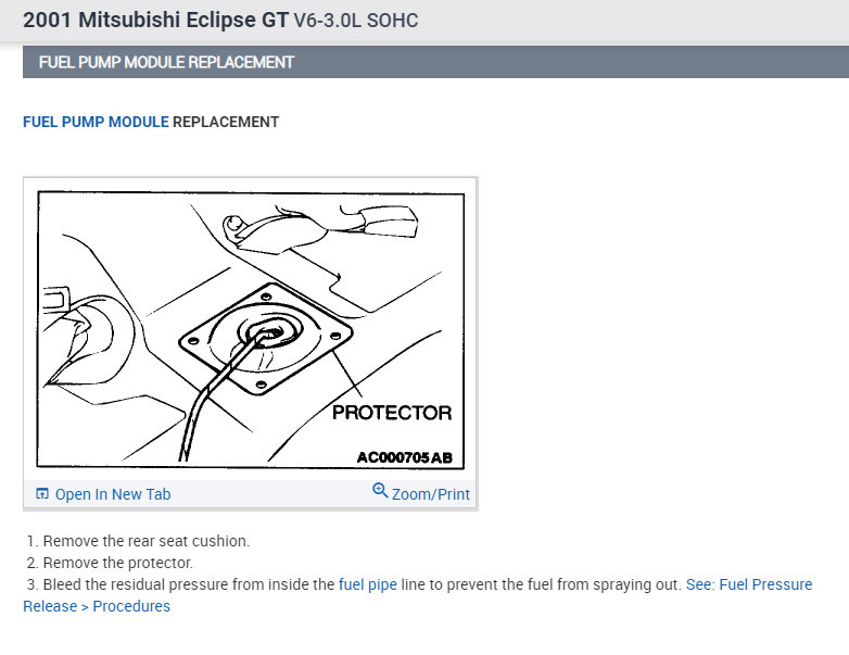

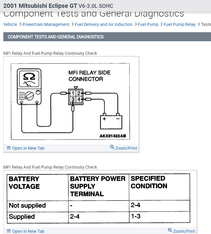

An inoperative fuel pump can be due to a faulty fuel pump relay, bad wiring or a defective pump.
First check the relay, it is located under the hood in the fuse box. I have attached diagrams below.
Look for any burnt pins or corrosion. You can also test the relay.
If the relay is good and you are getting power to the fuel pump, then the issue is likely a bad pump.
