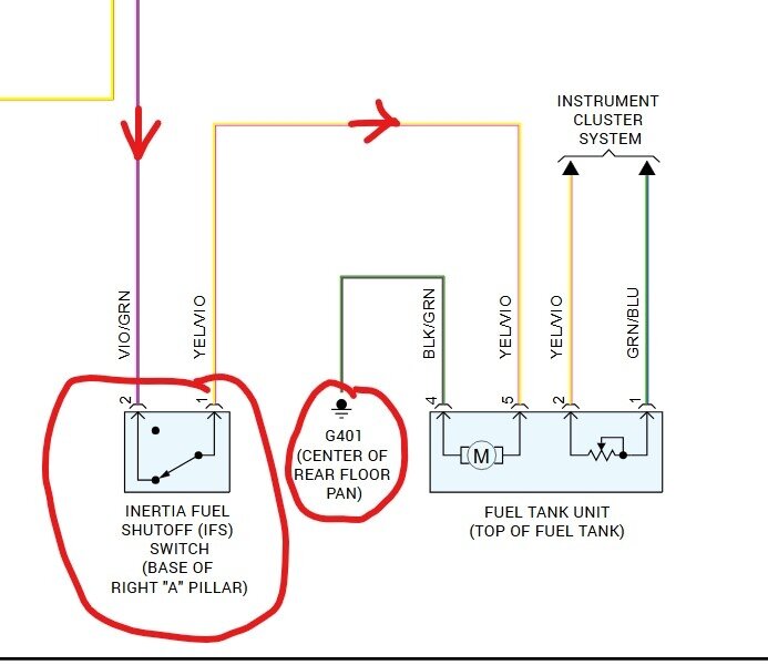

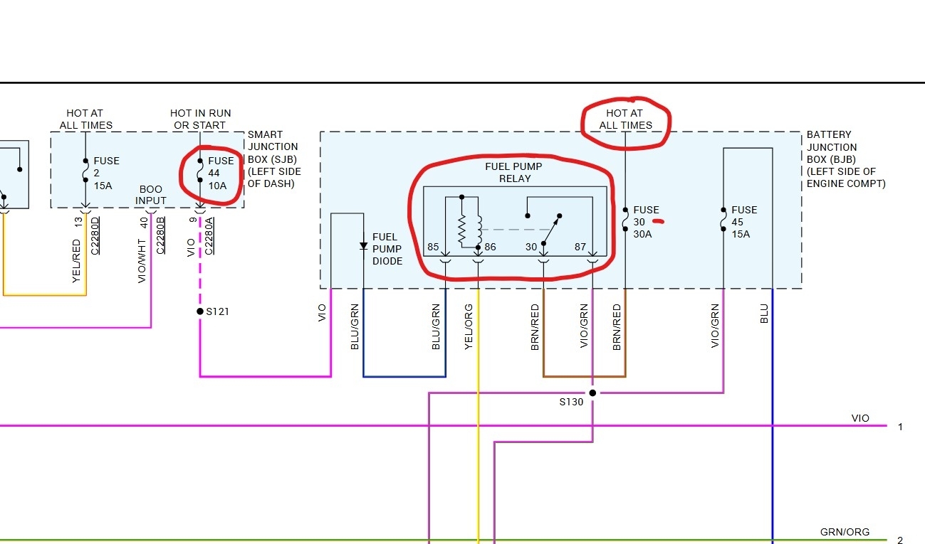

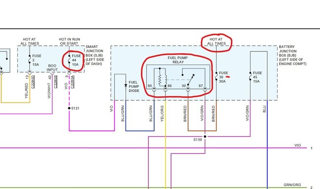

That car with the 3.5 should only have a simple relay to control the pump and not a pump control module. The power comes in from fuse 30 and to the relay the relay is turned on by the smart junction box, Power then goes through the circuit and to the inertia switch and out to the pump. The common failures are in the connector at the pump that gets corroded and the grounds rusting.
