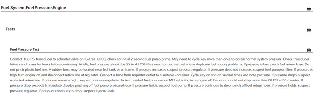

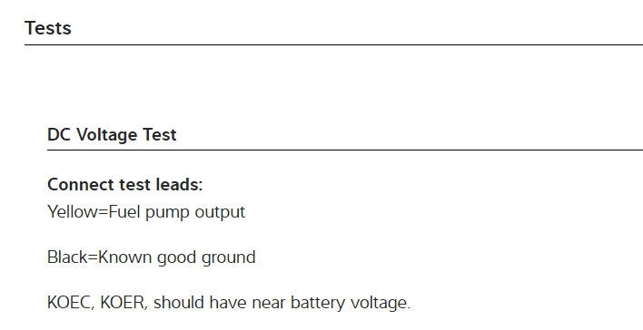

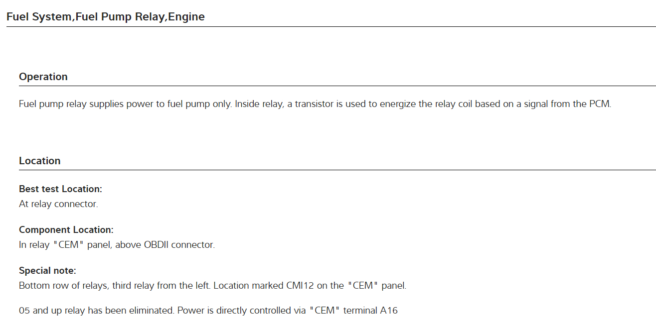

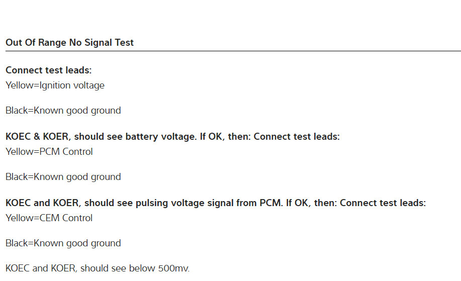

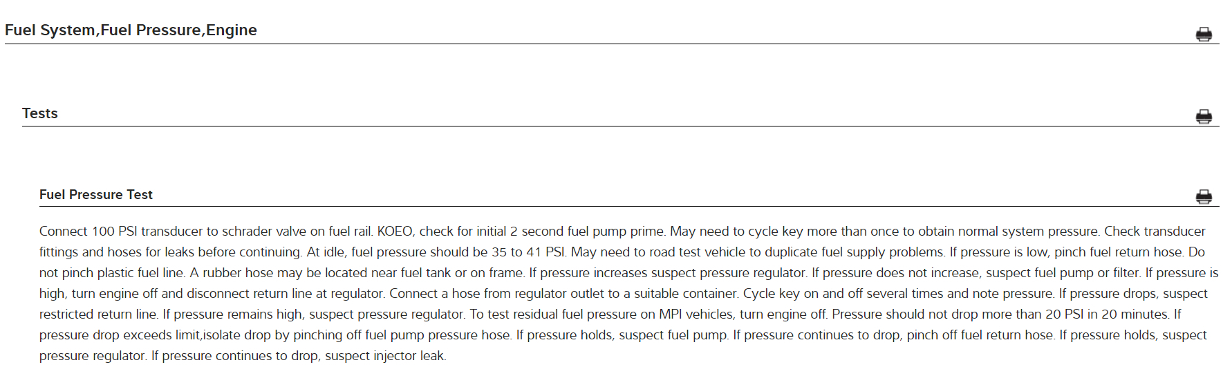

This does sound like a fuel pump issue. Could you do a favor though and go to the link down below and follow the guide?

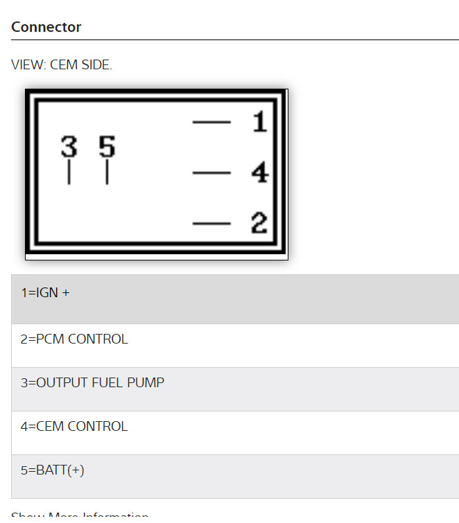

Then if that checks out okay I have fuel system troubleshooting for your vehicle listed below in the diagrams. Let us know what you find out.

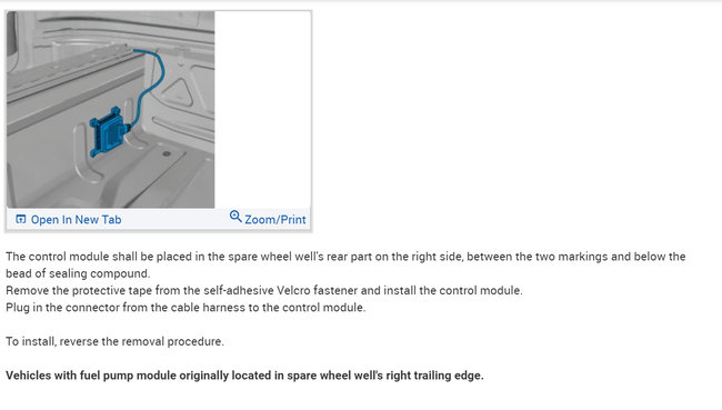

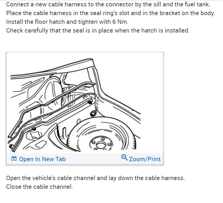

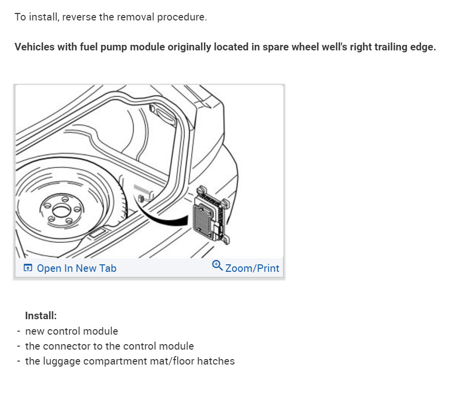

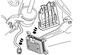

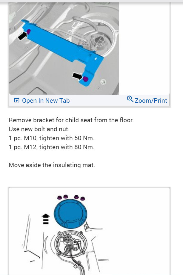

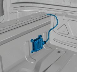

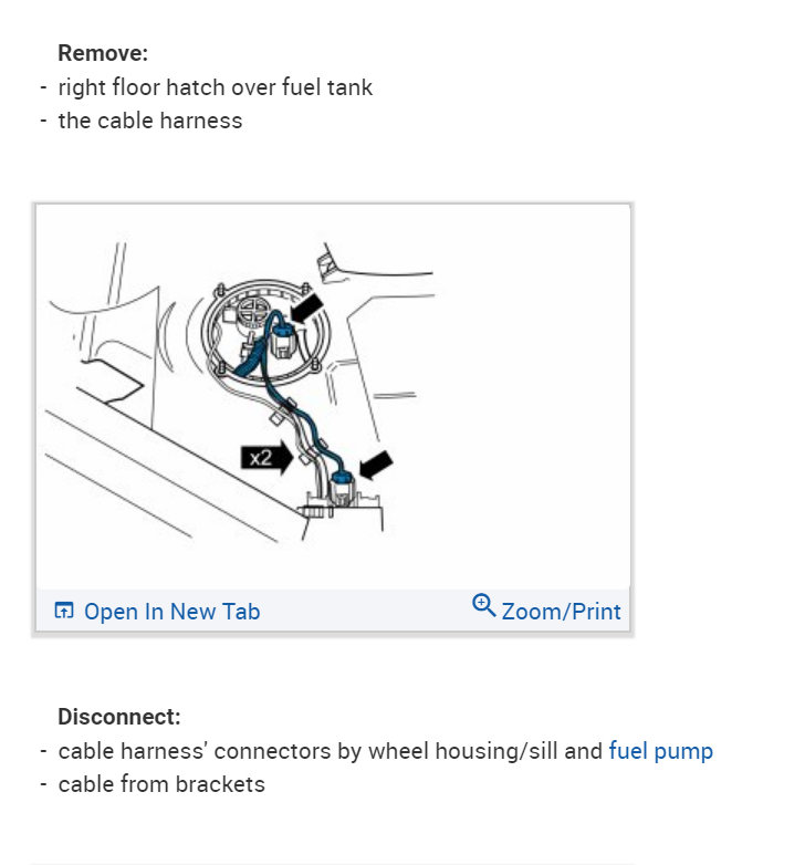

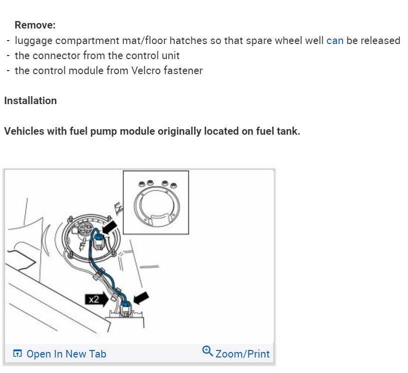

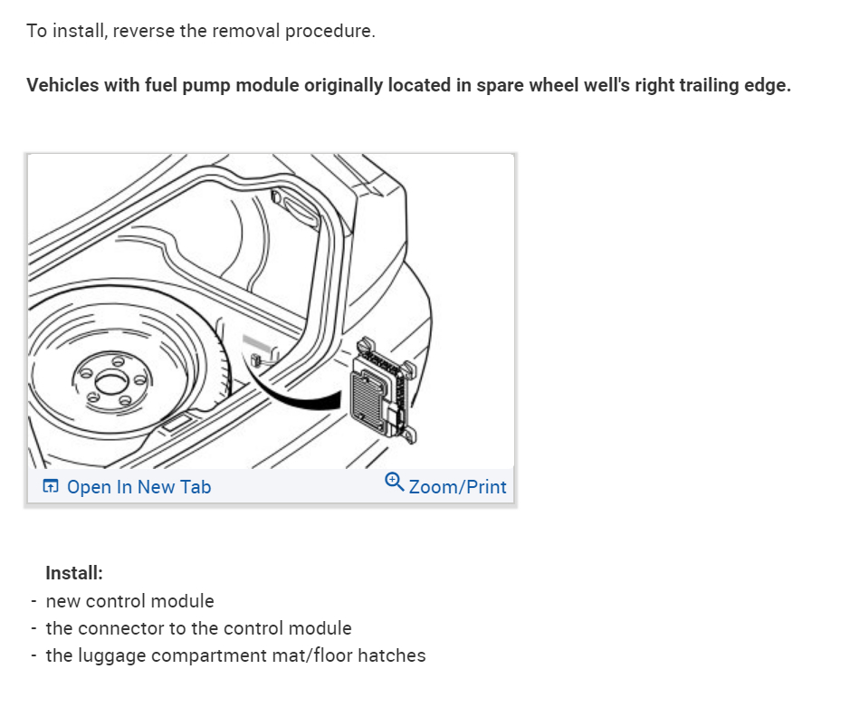

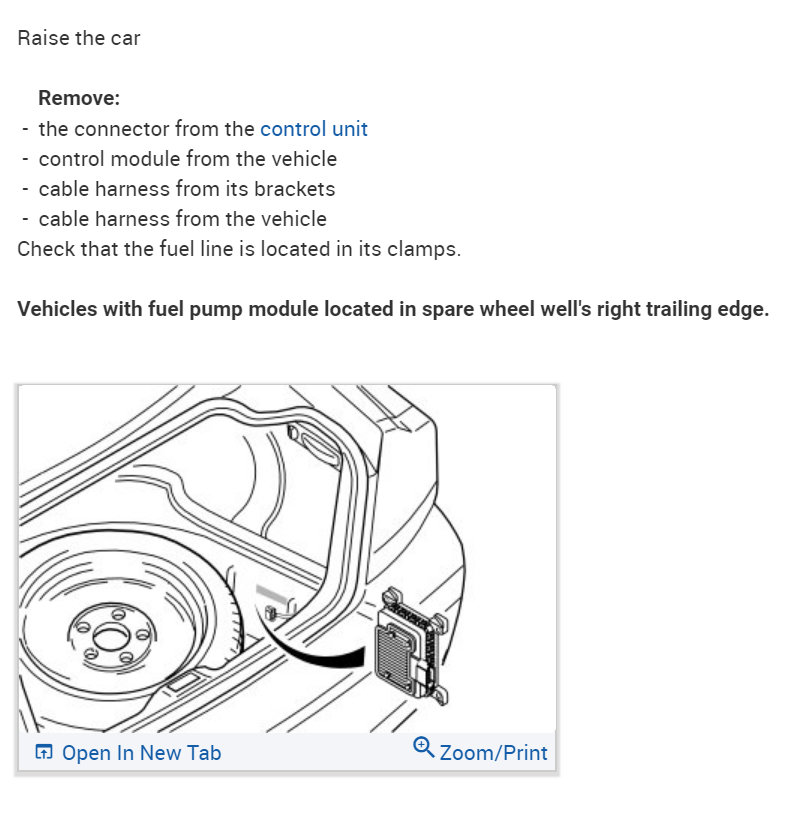

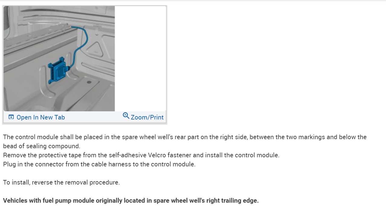

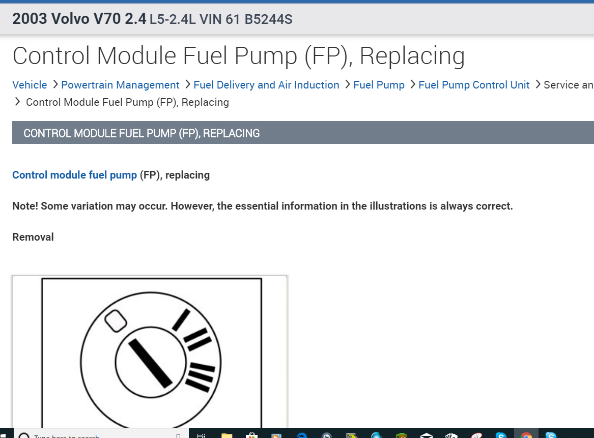

What does your fuel level guage read? You may have just run out of fuel? If you are out of fuel then one of your sending units could be giving you a faulty reading? If you do have fuel then either the fuel pump or fuel pump control module is defective if your vehicle is equipped with it.

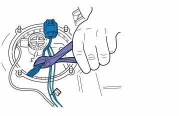

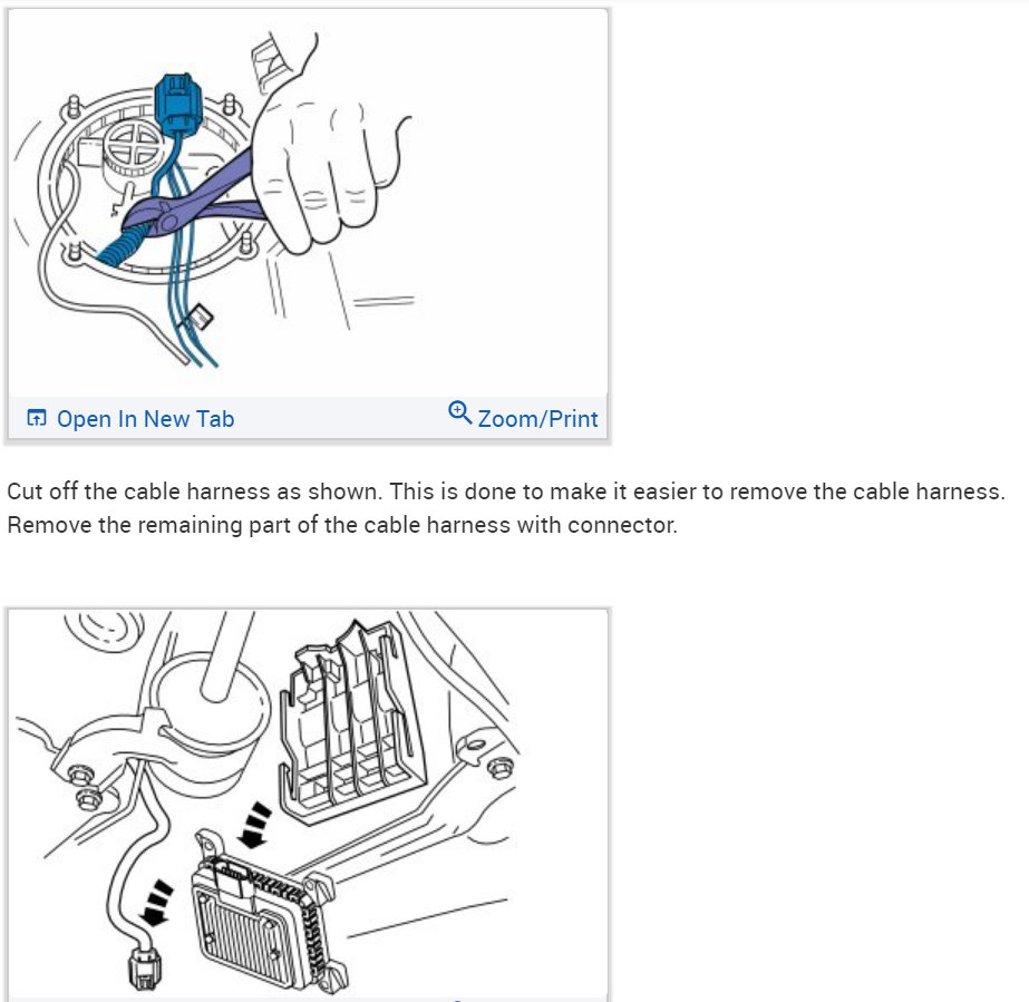

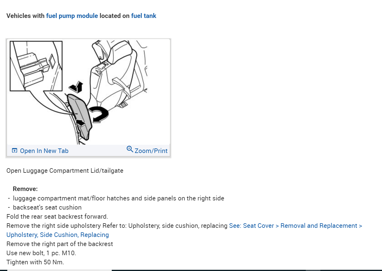

When I was at Volvo the module was located outside the vehicle so water and snow would damage it. The repair procedure would have you.cut the harness and relocate the module inside the vehicle. See images.
Let us know if you have that control module near the filter if you do, remove the connector and see if it is corroded. If it is then that is the issue.

I forgot to note, the control module will be behind the wheel well of you do not see it.
