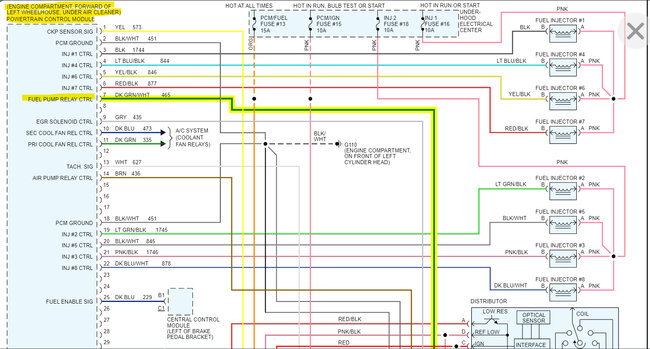

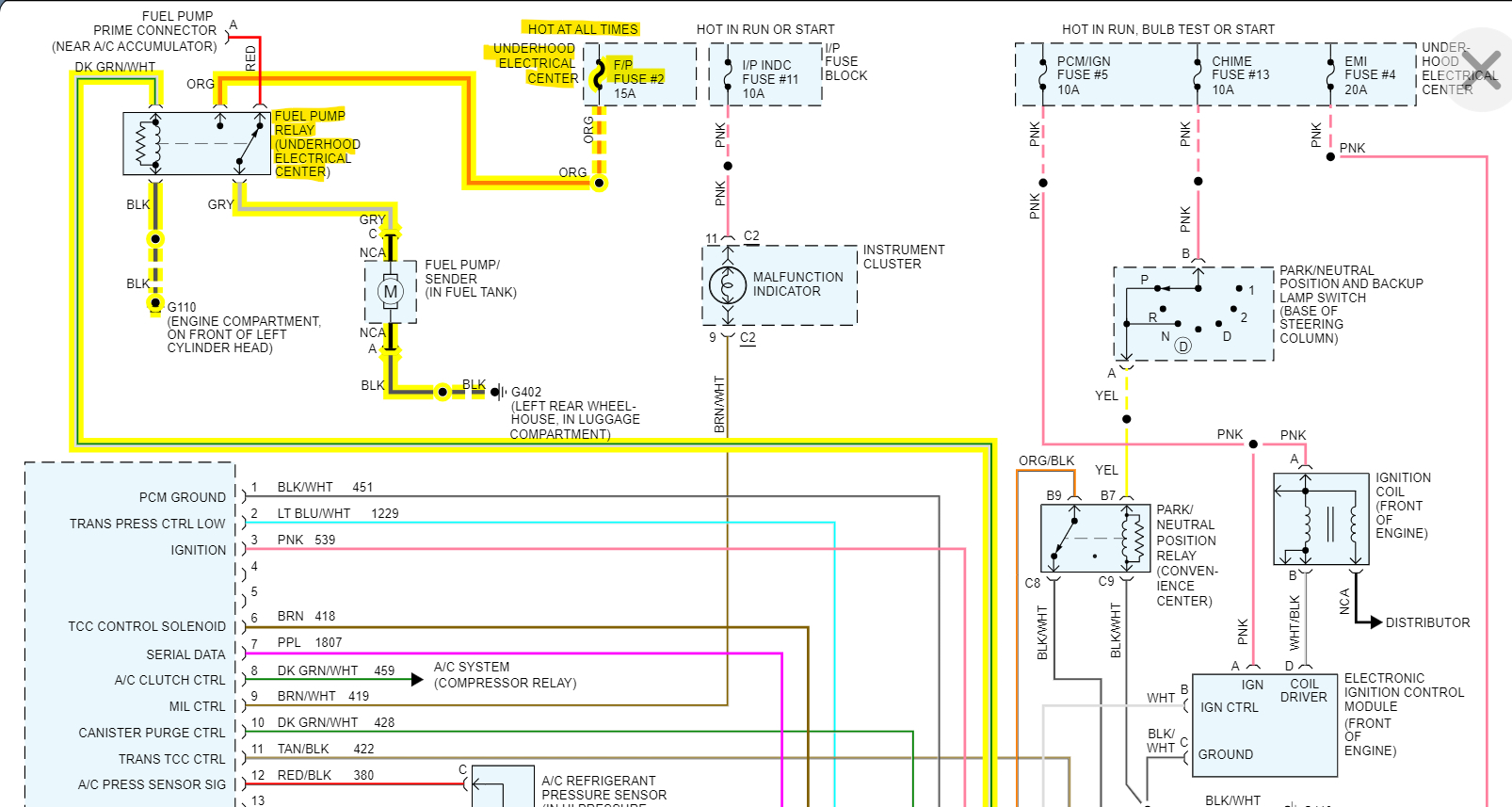

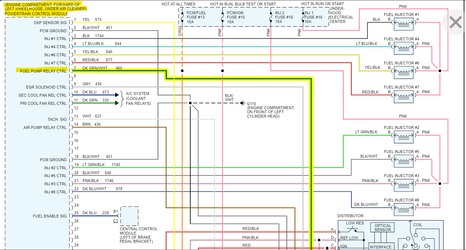

Here are the diagrams for the fuel pump and relay. The power on the orange wire comes from F/P Fuse #2 15amp, the other power feed comes directly from the engine computer (PCM). You can see on the Black wire the Ground G110 and the Grey wire runs to the Fuel Pump which is Grounded a G402. So, if you are missing any of these grounds or powers with the key on, or cranking the engine we can track down the circuit that's missing and not allowing the Relay to power up.

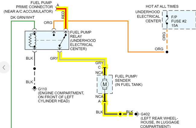

There's a red wire that's not connected, is that supposed be connected to anything?

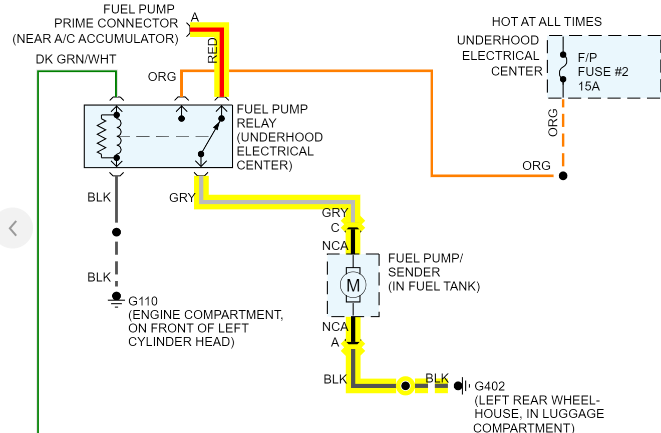

I do see that red wire, its labelled as a Fuel Pump prime feed. I believe that is to power up the fuel pump for testing purposes. Service information states the Fuel pump relay should be active with the Key On. But I have seen the relay pins on the bottom side of fuse panels in the engine compartment corrode and break off many times. They are just in a bad location where they are exposed to moisture too much. If these wiring diagrams are correct, you should technically be able to put 12volts to that red wire and power up the fuel pump. But we should find the real cause of the relay not coming on instead of doing that right now, especially since you just replaced the fuel pump and relay. Do you have a test light or basic multimeter?
Some of these diagrams are reading incorrectly, so I don't want to see you power up a circuit that is incorrect and burn something out. So, we'll just stick to figuring out what's going with the relay control circuits.

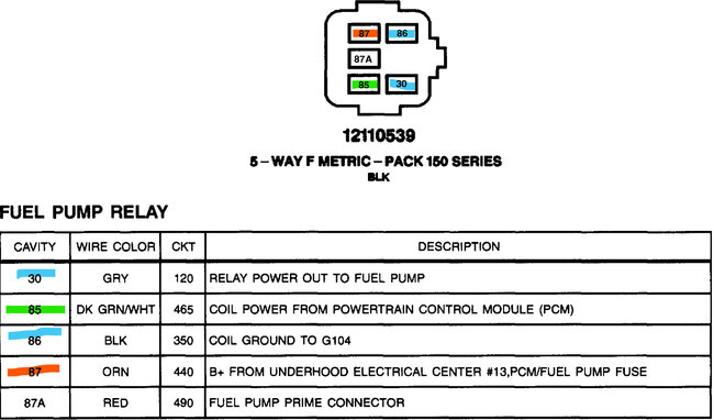

You did power it up by the red wire and it powered up the Fuel pump? This is a pinout of the fuel pump relay location. With a test light connected to Battery Negative, and the key on you should have power at pin 87 and 85, Also try this while cranking. If you have power, there (12volts). Then hook the test light to Battery Positive and the test light should light if you touch pins 86. If you powered up the fuel pump by the red wire, then we already know the Fuel pump has a good ground of its own. Because that red wire runs directly to the pump (diagram 2 shows that circuit)
The tests are with the Relay Out I should have said as well.
