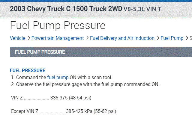

Can someone tell me the fuel pressure spec is for my truck listed above 1500 z71?
I need specs for;
Key on engine off.
Key on and engine running.
Thanks
Jun 28, 2022 at 8:46 AM
  • 110,240 POSTS
Pressure on this is different based on the VIN. The 8th digit in is the engine code. If you look below, they only provide the pressure when the pump is commanded on. So, that would be engine off. It will drop a little with the engine running, but I wouldn't expect more than 5 PSI.
First, identify the 8th digit in your VIN and then refer to the attached pic.
I hope this helps.
See pic below.

Yes, tested I had 49 PSI key on engine off and 49 engine running. I guess this this is problem with random misfire.

Thanks for your help got pump ordered.

Okay, Joe. Heads up changed the fuel pump and fuel filter and starts right up, no more random misfire or knock sensor codes. test drove over 100 miles on trip I had to make ran great no codes of problems. Thanks for the help.
