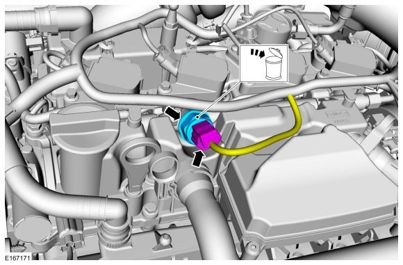

Figured the problem out and later found out the engine was different from what I was told. Was wondering where the location of the fuel pressure sensor is on the 1.5l EcoBoost engine?

Welcome to 2CarPros. The pressure sensor is next to the oil fill neck. What is the problem you are having?

Lost of power, hard time starting and I had a friend check my fuel pressure and he said it read 45 but the computer was putting out 85. I was told it was a 1.6l and figured that was the pressure sensor but the one I got didn’t match up. I ran the VIN and it’s a 1.5l.

The low pressure side on that car should run 46 - 80 psi
If you have a scan tool that can read live data a quick way to tell if it's the sensor is to watch the Low side fuel pressure, with the engine running it should read 70-80 psi and change rapidly within those numbers.
Also monitor the high pressure fuel pump command and desired and actual pressures. Start the engine and get it into boost. As soon as it hits boost the command should drop to zero. Monitor the desired and actual high side pressure as well. If it shows a desired pressure 2000+ but the actual pressure drops into 100-300, the sensor is bad.
Look up Ford TSB 14-0216 on this issue. Be advised that a bad sensor can easily cause engine damage, so with the symptoms you already have, replacement is probably a good thing to go after first. It also may be a good idea to call Ford, I think this might be covered under the emissions warranty.
