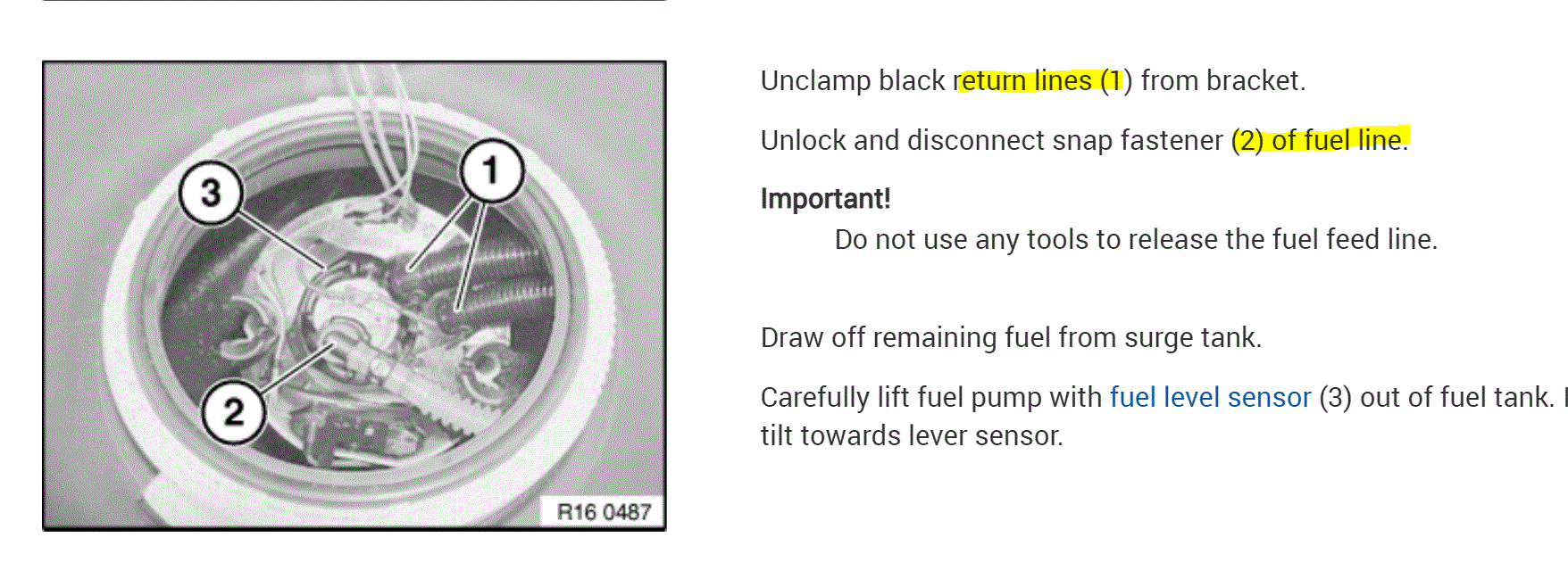

When you say no fuel on the fuel pump side, you are referring to the return line, correct? Also, how are you adding fuel to the fuel pump side?
As far as the regulator is concerned, is anything preventing it from getting fuel? I ask because if you are getting fuel on the return side, where is it coming from if there is nothing on the supply side.
I attached a pic below of the fuel pump sending unit. It shows the return lines and the supply line. Which ones have fuel, and which don't? Also, let me know if that is what you are seeing. That is the US version. I just need to be sure we are on the same vehicle. LOL They change things based on destination.

Yes, there is no fuel on the side where the fuel pump sits, and there is lots of fuel on the side where the sending unit sits. When i put in some petrol it will start for a while and it will shut off, and when i open the tank i find all the fuel has been transferred to when the side where the sending unit sits. Yes, the picture you have shown is the right one, it is similar to the one I am talking about.
Form the little knowledge i have, i know the fuel pump pumps the fuel to the sending unit via fuel line (2) as you have shown and then to the injectors, but when it is supposed to return the excess fuel back to the other side it doesn’t do that, I don't know what causes that.

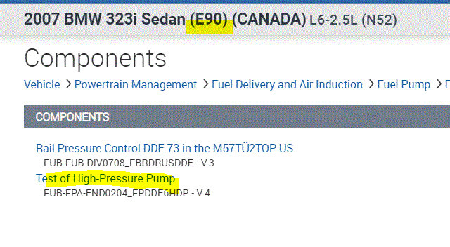

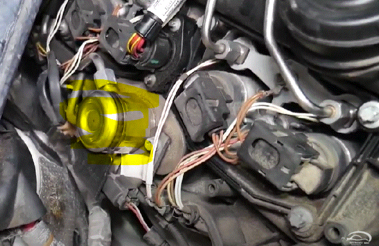

Okay, it sounds like an issue with the high-pressure fuel pump. If you remove the engine cover, locate the HPFP. See pic below. That is what you are looking for.
Is that where fuel makes it to and then stops?

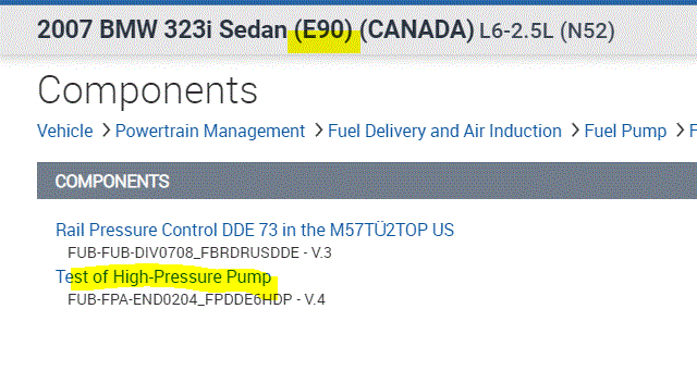

As far as I'm seeing, it should have a high-pressure fuel pump. By chance, are you located in Canada? I ask because the 323 isn't offered in the US, so I am much more familiar with the 335. If you look below, you'll see why I assumed it has one.
Feb 6, 2022 at 12:09 PM

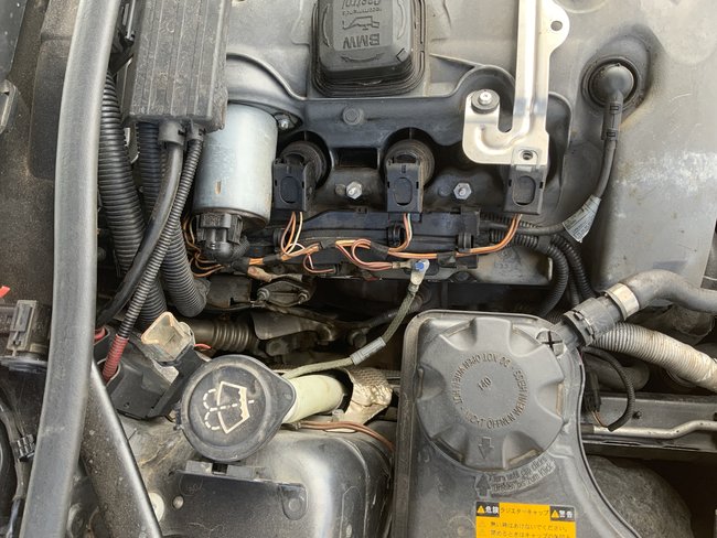

Do me a favor. Locate the fuel supply line to the fuel injectors and follow it as far as you can in the engine compartment. If the vehicle does have an HPFP, it will be mounted on the engine. It will be a mechanically operated pump. It will have electric connectors to it, but the pump itself is actuated off cam lobes.
Let me know. Also, if you don't find one, take as many pics as you can and upload them for me. Hopefully, I'll be able to help you determine the issue and what to check.
