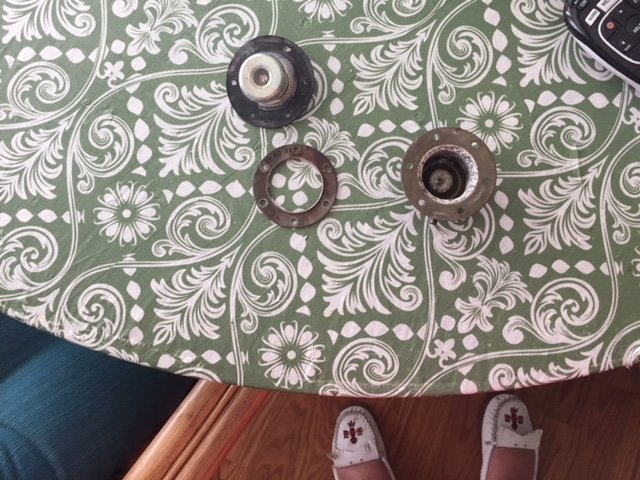

Is it possible to install a fuel pressure regulator incorrectly? I have hunted high and low to find a picture or text on how it goes in. I do not remember what it looked like when I put my new one in (the fuel rail location) but I have a fuel pressure problem. KOEOff I get 70 PSI of fuel pressure measured at the "out" side of the fuel filter and at the supply line quick disconnect at the engine. The problem is I only get 30 PSI out of the fuel rail schrader valve. Vacuum line connected or disconnected and a slight drop engine running. I am in the process of pulling the plenum/fuel rail back off and look for a crimped metal fuel supply line or an obstruction in the fuel rail somewhere. I am going to check the fuel pressure regulator, but I want to make sure I know what I am looking at. Install pictures or diagram would be great.

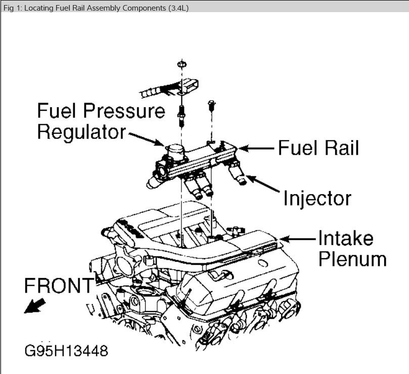

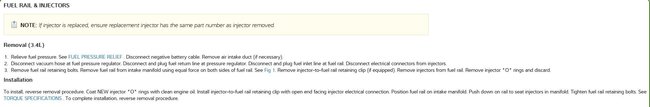

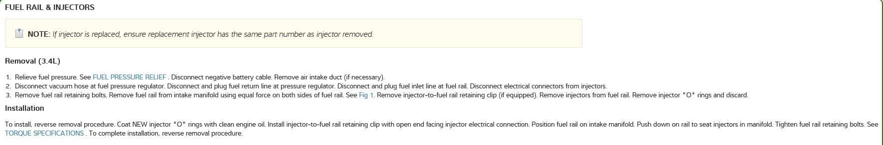

Here are the instructions. Note: On 3.4L, fuel pressure regulator and fuel rail are serviced as an assembly only. Do not remove pressure regulator or pressure regulator cover from fuel rail.

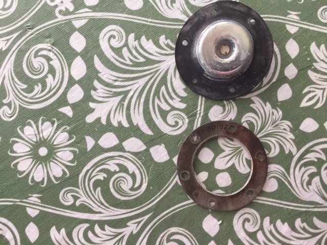

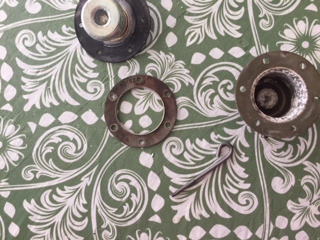

One other question: In the pictures I sent there are three parts; the diaphragm, the housing, and this washer looking thing. The washer has a raised lip on the inside of the hole. Does that lip "trap" the diaphragm against the housing or does the lip face away from the rubber diaphragm?

No to the rail pressure test. If you block off the return, you should have the same pressure you had at the filter.
It appears to be that way with the lip.
Sep 12, 2018 at 1:46 PM
DOUG42190
  • 23 POSTS
So the lip "traps" the diaphragm against the housing?
Sep 12, 2018 at 2:01 PM
Looks to be that way. I have never had one apart. I always did the rail.
Sep 12, 2018 at 2:06 PM
DOUG42190
  • 23 POSTS
Well, I finally got it. The order of assembly seems to be diaphragm, then housing, and then the "washer" goes over the housing. Therefore the bolts go through the "washer," through the housing, through the diaphragm and then screw into the fuel rail. Pressure went from 30 to 43 psi.
