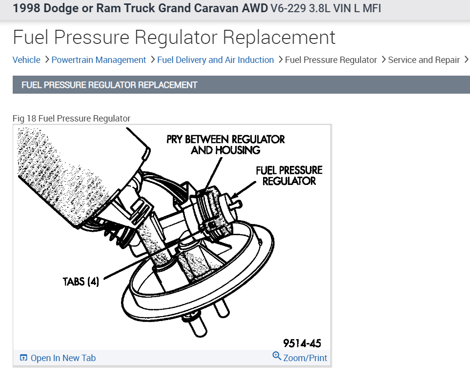

what's the fuel pressure supposed to be at the schrader valve on the fuel rail?
1998 DODGE GRAND CARAVAN
361,000 MILES • 3.3L • V6 • 2WD • AUTOMATIC
SANDSTORM58
  • 16 POSTS
brand new fuel pump (bosch) because old fuel pump showed signs of a problem but not getting but 12-14 psi at the rail (schrader valve) with the key in on position. i had to replace the outbound fuel line from pump to filter after finding a leak, replaced with rubber fuel injection hose instead of nylon tubing.
what's the fuel pressure suppose to be at the schrader valve on the fuel rail. i thought it was to be at 49 psi which is what my book calls for.
the reason why i ask is because prior to changing the fuel pump the pressure was dropping below 42 psi and gradually but immediately at that then i found the fuel leak.
what could be causing such low fuel pressure after a new fuel pump w/new was installed fuel filter is less than a year old, new injectors, new spark plugs, new o2 sensor upstream (this is when everything began coding when changing the sensor), and a few other fuel related items. i need help on this one‼

Here are the fuel pressure specs as you requested.
Fuel Pressure
Key On, Engine Off .................... (approx.) 338 kPa (49 psi)
Note: Using the DRB Scan Tool, access ASD Fuel System Test. The ASD Fuel System Test will activate the fuel pump and pressurize the system.
CAUTION: When using the ASD Fuel System Test, the ASD relay and fuel pump relay remain energized for 7 minutes or until the test is stopped, or until the ignition switch is turned to the Off position.
You must have a bad fuel pump because even the fuel pressure regulator is inside the fuel pump module, check out the diagrams below. I would get an AC Delco unit for it from Rockauto.com.

I actually have fuel pressure at the pump and higher than 50 PSI. I tested it to see if the fuel filter might be defective or semi-clogged and that seems to be the case here. I'm changing the fuel filter then will retest the system once I have it all back together. Suspect someone dumped crap into my tank so when I had it down last week, I emptied it and cleaned the tank out.

Installed a new fuel filter unit and put it all back together. Not getting full pressure at the rail so had a helper turn the key to "on" while I was under the car. Every fuel pump I've ever had that's in-tank hums at that position, but this brand-new pump stops after a couple of seconds very abruptly like a thud. I put my hand on the top ring and felt it abruptly stop after keying "on". Am I right by saying I have a defective pump? Pressure only went to about 14 PSI and stopped within a couple seconds. I checked the Fuel Pump Relay and it's running fine.
Aug 31, 2022 at 4:45 AM
  • 55,433 POSTS
Yep, good call, I would get a Motorcraft pump for it, it costs more but you won't be doing the job again.
