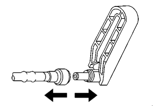

The feed line is leaking where you connect to fuel rail. The one closest to back of car.

Hi and thanks for using 2CarPros.com. I have attached the directions for removing and replacing the coupler. Once you have it apart, check to make sure the o-ring between the two components is good. Check for cracks, nicks.
Here are the directions. It does require a special tool. The attached pictures correlate with these directions.

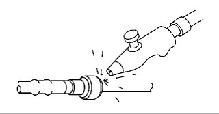

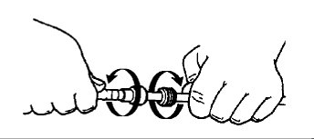

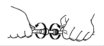

Grasp both sides of the fitting. Twist the female connector 1/4 turn in each direction to loosen any dirt within the fitting.
Blow dirt out of the fitting using compressed air.

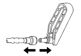

Choose the correct tool from J 37088-A for the size of the fitting. Insert the tool into the female connector, then push inward to release the locking tabs.
Pull the connection apart.

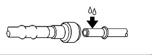

CAUTION: In order to reduce the risk of fire and personal injury, before connecting fuel pipe fittings, always apply a few drops of clean engine oil to the male pipe ends.
This will ensure proper reconnection and prevent a possible fuel leak.
During normal operation, the O-rings located in the female connector will swell and may prevent proper reconnection if not lubricated .
Apply a few drops of clean engine oil to the male pipe end.
Push both sides of the fitting together to cause the retaining tabs to snap into place.

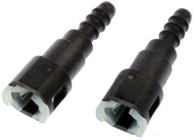

I completed the procedure. However, the fitting is loose and there is still fuel leaking out of the fuel rail. Do I have to replace the whole line? Also, my connection is nylon not metal. Does that make any difference?
May 22, 2018 at 10:19 PM
  • 110,240 POSTS
Hi again. You should be able to purchase a new o-ring as well as the clip that holds it together. However, if you would rather, they make a replacement fitting. I attached a picture of what one looks like for a GM vehicle. It helps eliminate the replacement of the entire fuel line. I believe the Dorman part niumber is 800-080. Confirm that is the correct part for your vehicle, but I believe it is. If you call a local parts store, just tell them you want a replacement fitting made by Dorman and you believe the part number is 800 080. Then have them confirm it is the correct one for your vehicle.
