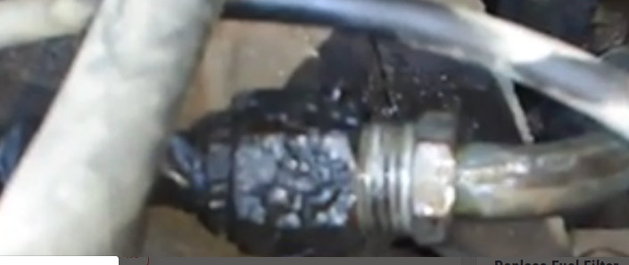

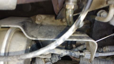

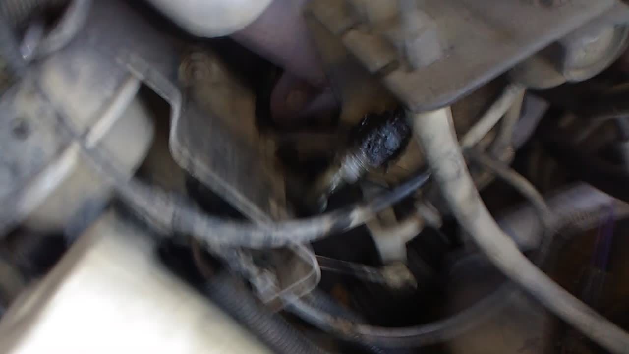

Had a hard time turning on the car a minute ago, then I smelled gas on the 8 mile trip home. Got home and opened the hood and smelled more gas and saw the coupling on the metal gas line leaking. Attached video. How can I order this or possible fix? Im thinking my motor mounts are soo worn it crimped the leaky line.

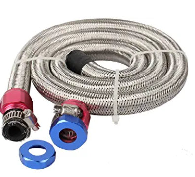

It is hard to tell where that line is leading but if it were me, I would just get a female connector and flexible fuel line and run a new line. I would spend the money on a replacement line when you can get flexible steel braided line for cheaper then most hard replacement lines. Plus this way you don't need to worry about pinching any more.
