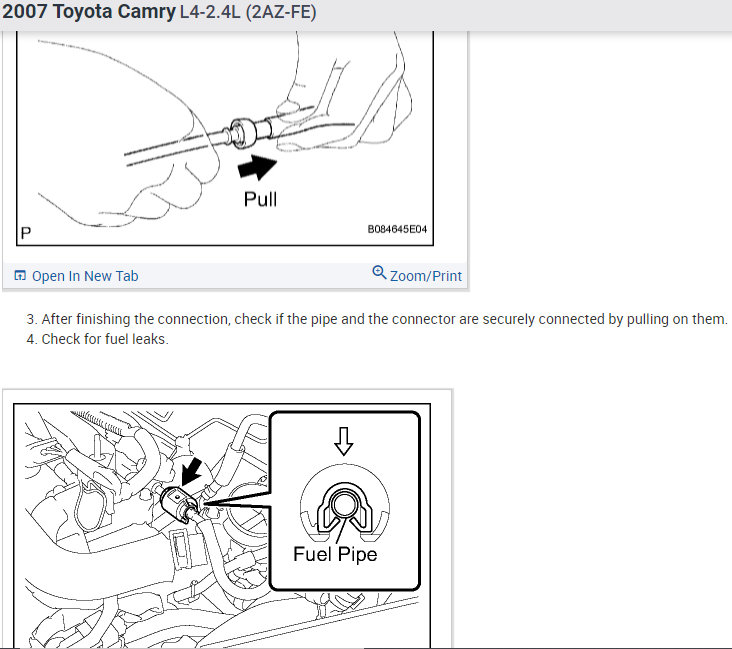

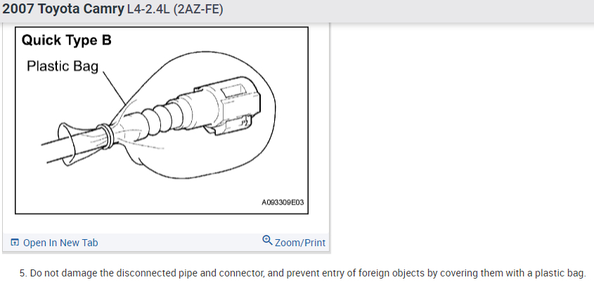

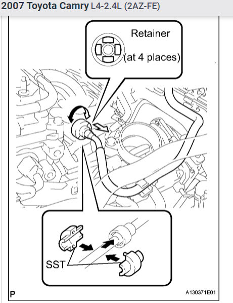

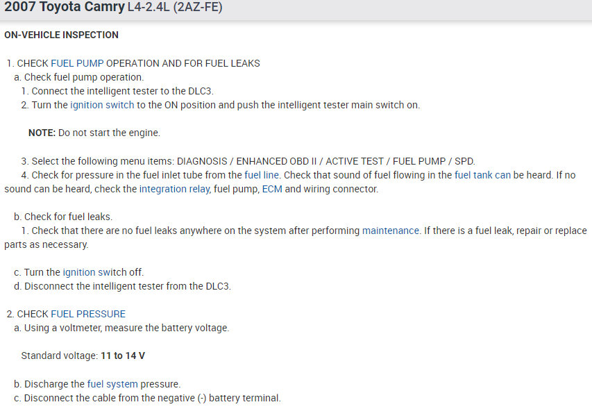

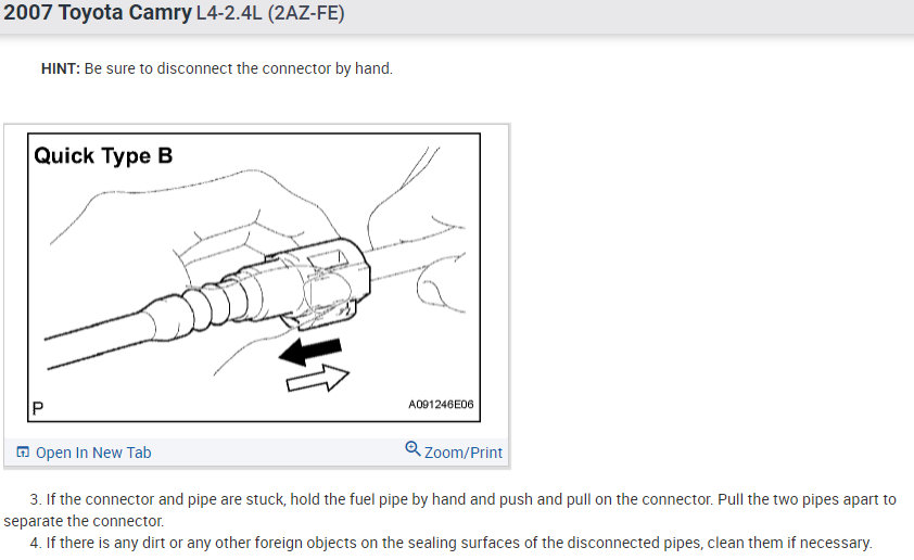

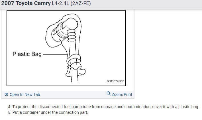

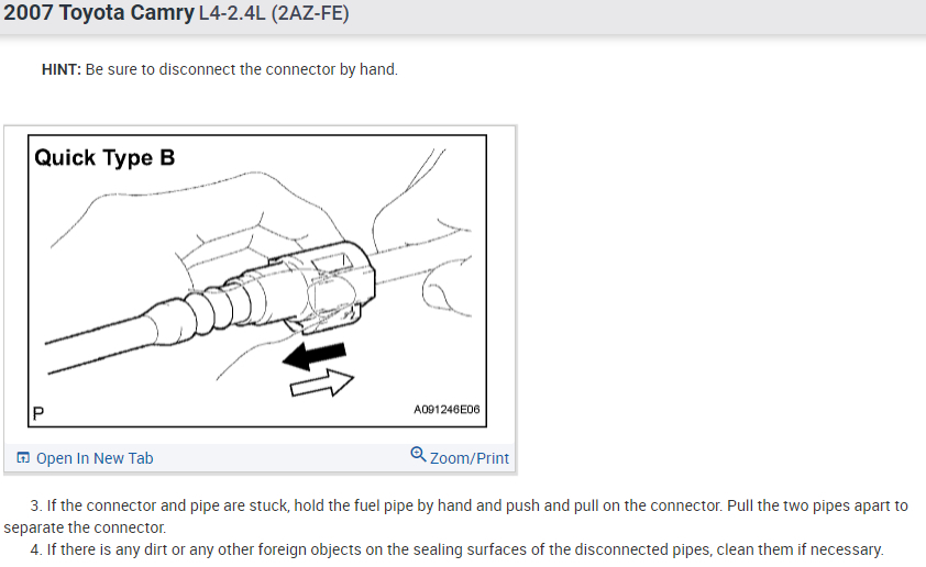

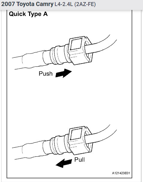

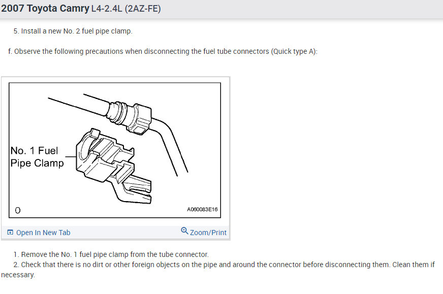

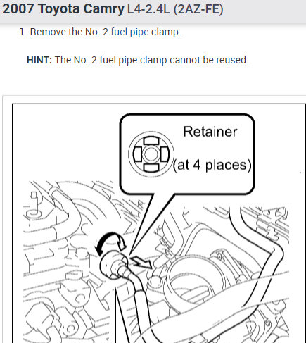

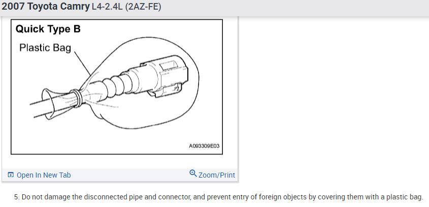

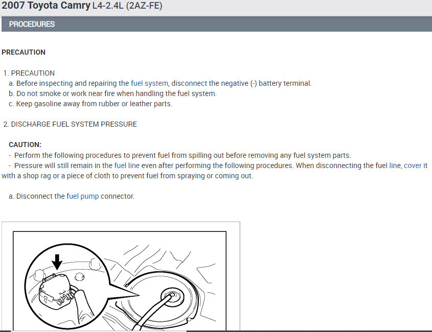

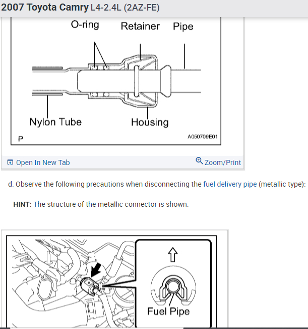

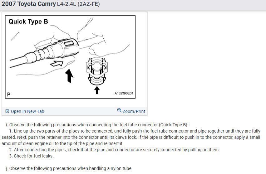

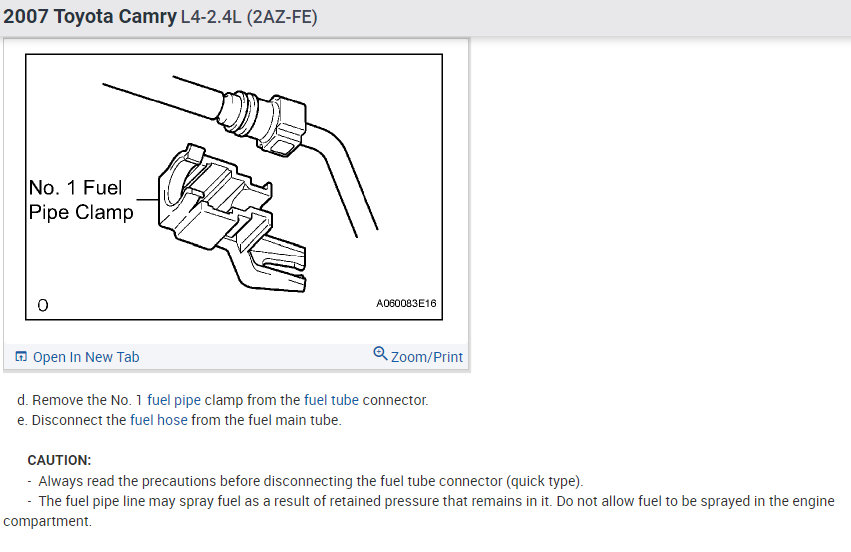

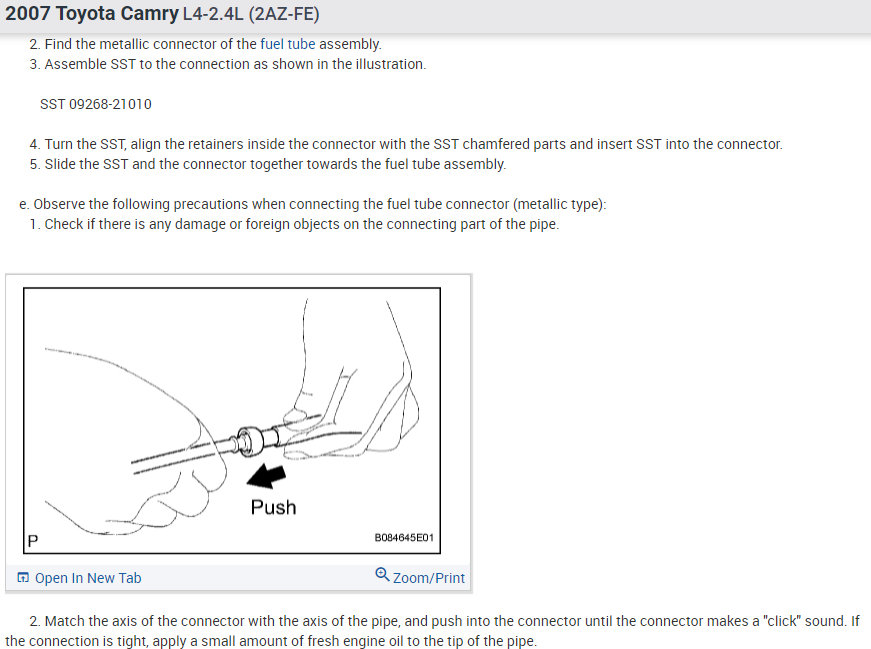

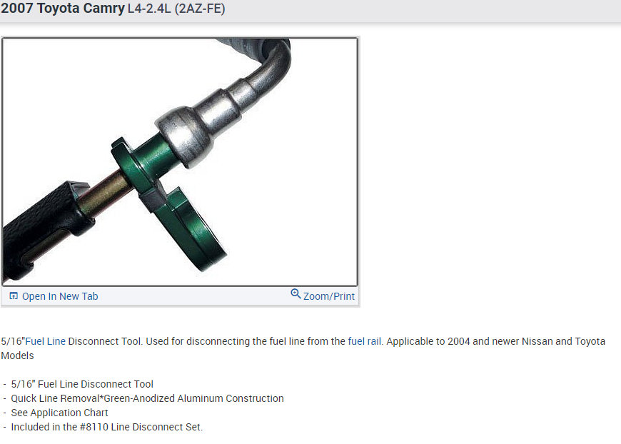

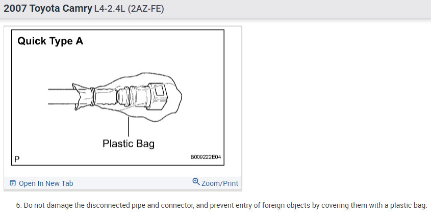

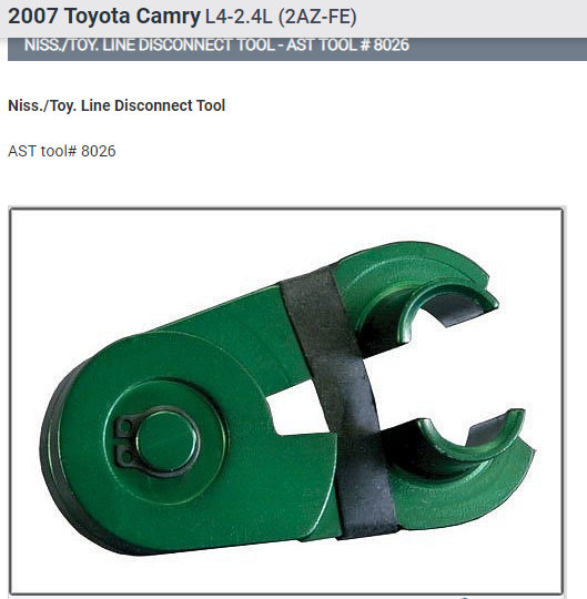

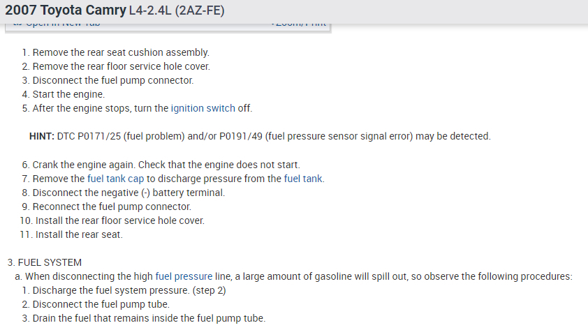

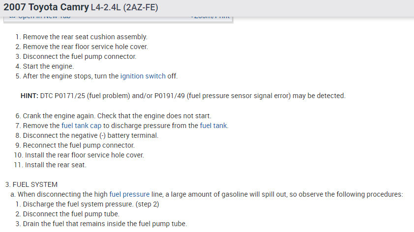

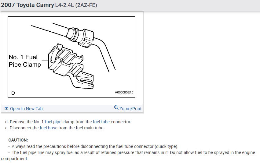

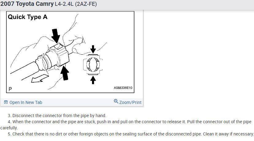

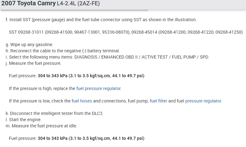

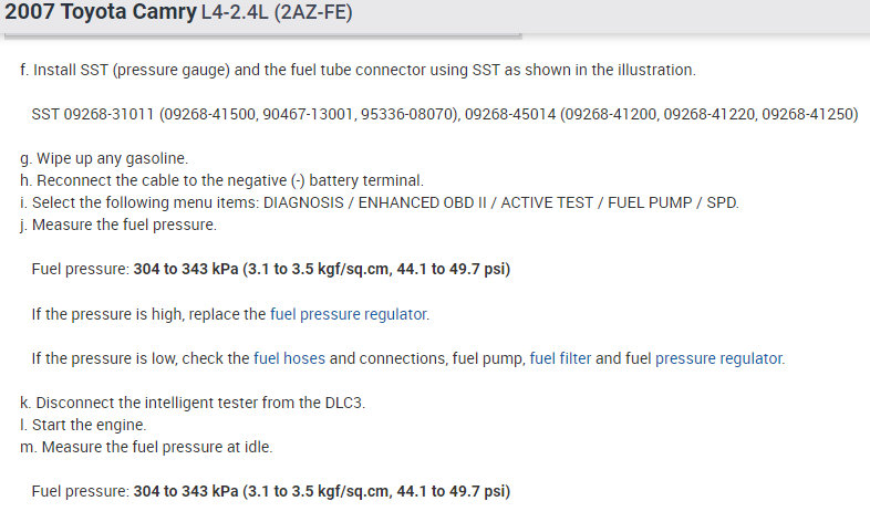

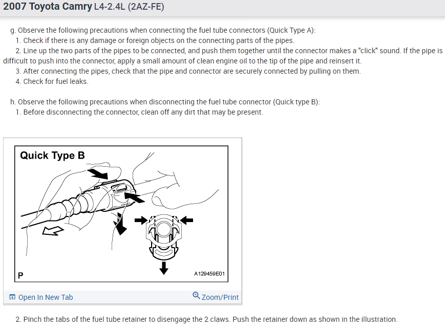

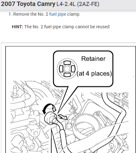

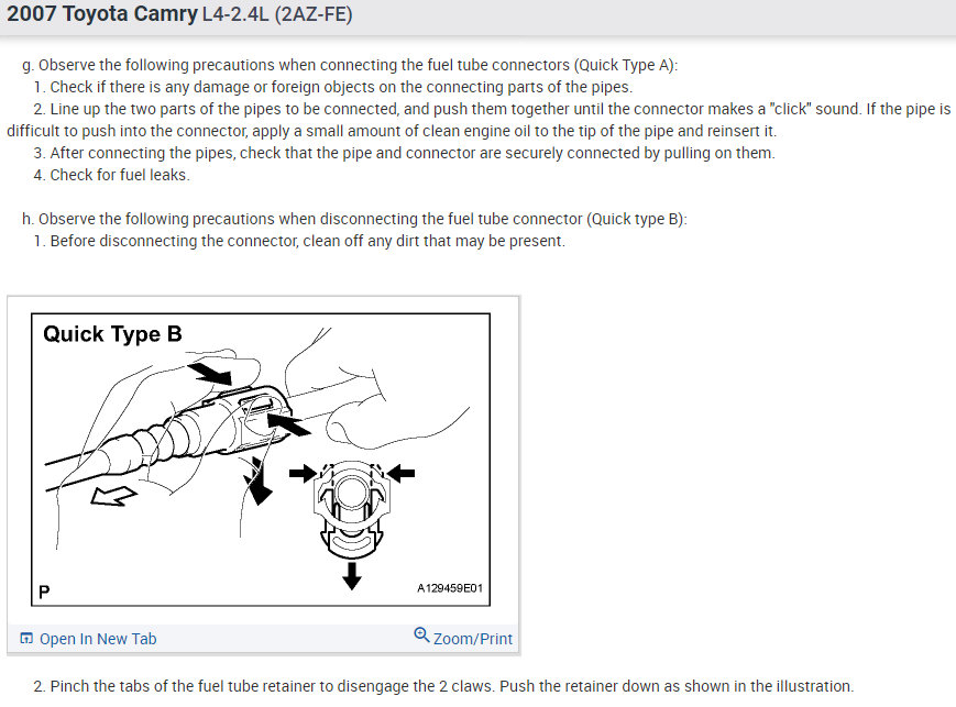

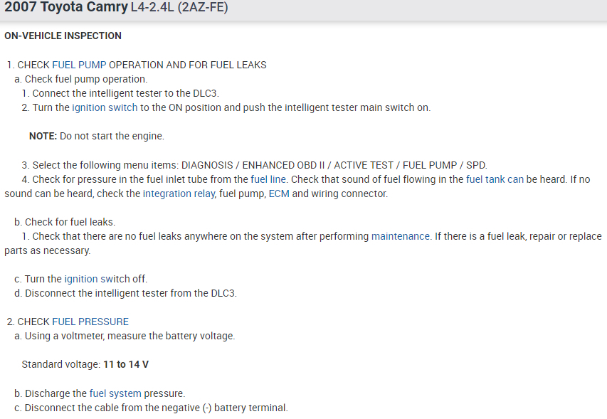

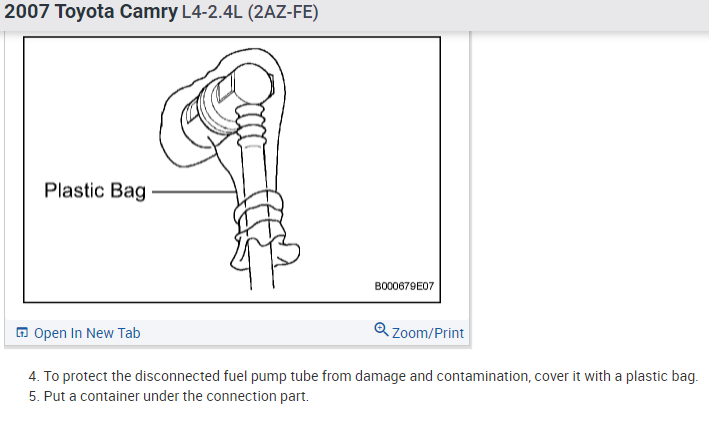

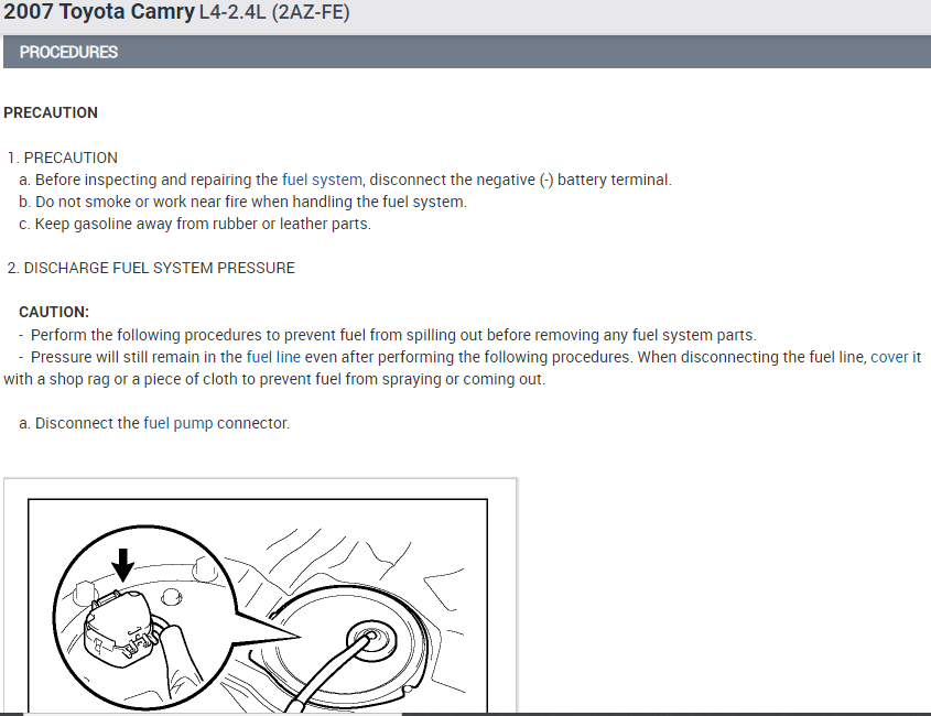

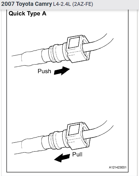

i would like to check the fuel pressure how do i disconnect the fuel line can you send me pictures do i pull the fuel line apart?
Oct 26, 2016 at 12:52 AM
SQM
  • 6,383 POSTS

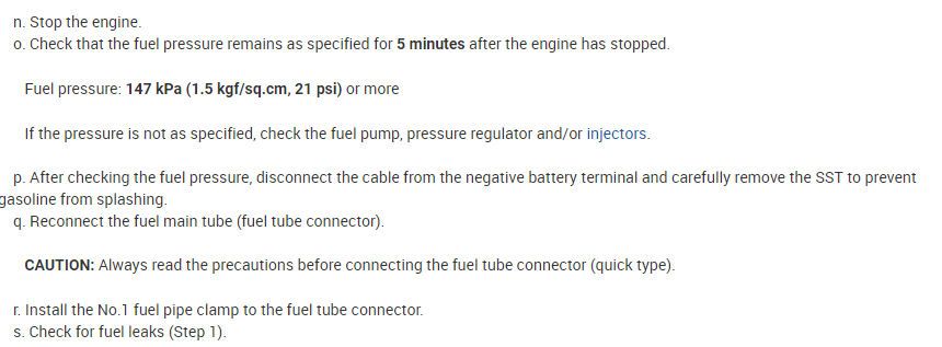

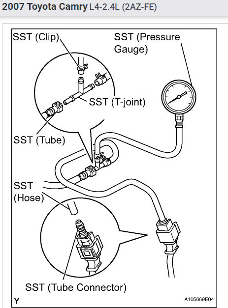

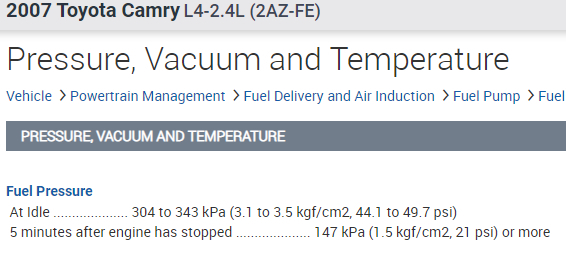

This is the fuel pressure of your vehicle:
Fuel Pressure
At Idle .................... 304 to 343 kPa (3.1 to 3.5 kgf/cm2, 44.1 to 49.7 psi)
5 minutes after engine has stopped .................... 147 kPa (1.5 kgf/cm2, 21 psi) or more
Here is a helpful article of how to test fuel pressure:
I have also attached the fuel pressure procedure for your vehicle as well as complete fuel line disconnect and repair procedures.
Let me know of any questions.
