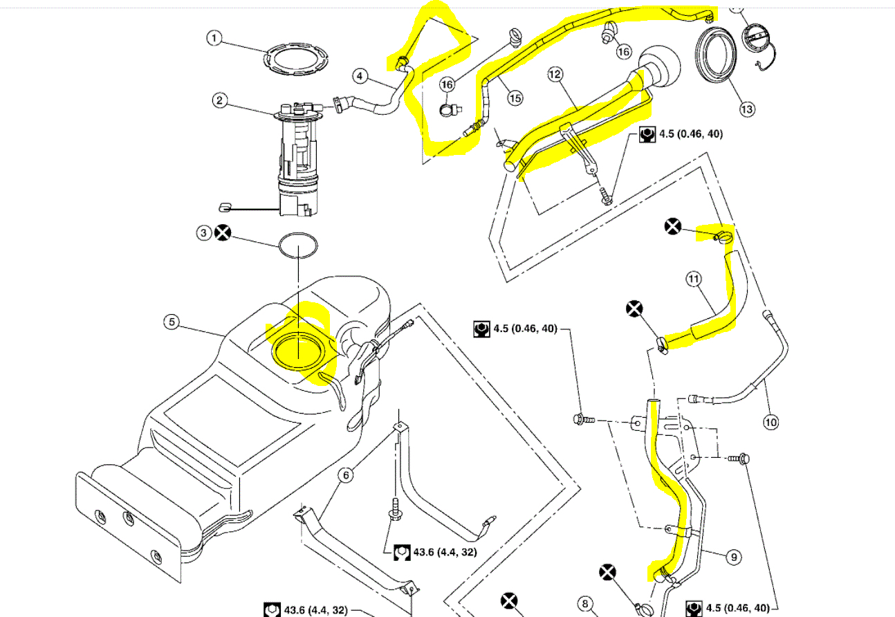

Have been smelling slight fuel smell couple weeks.
No hiss upon opening fuel cap, replaced new one, still no hiss.
Today overfill tank a little.
Driving couple hours for delivery, I smelled stronger odor, but no visible leak. Looked at my fuel gauge, and I had used little more than 1/4 tank in 39 miles.
Has to be leak, but where?

That could be many things. I attached a pic of the fuel tank below and highlighted areas that could be leaking. Note that the fuel filler tube, vent tube, steel fuel lines, fuel tank, and so on could be rusted and leaking.
I guess where we should start is by trying to identify where the smell is strongest. Is it in the front of the vehicle (engine compartment), does it seem to come from under the vehicle (center), or in the rear where the fuel tank is located?

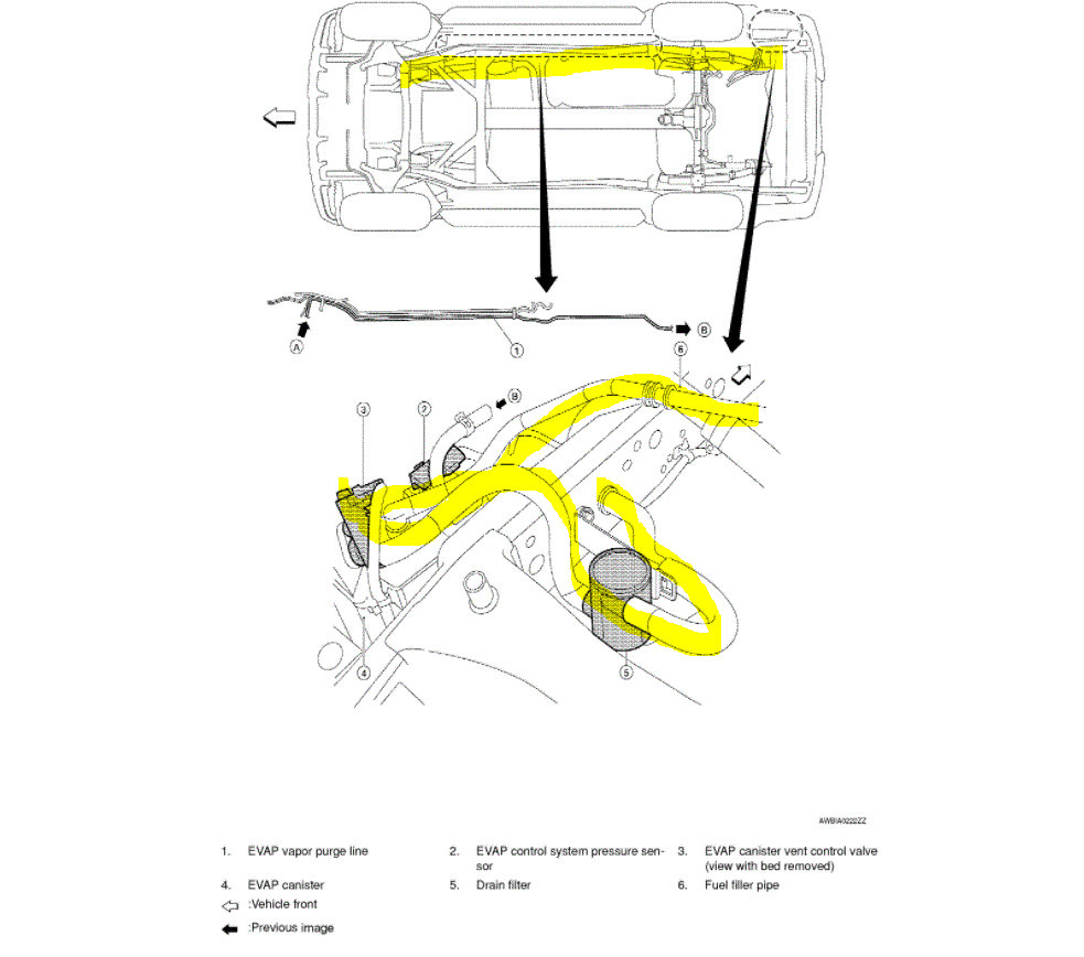

Try to pinpoint a location so I can tell you what to look for. Also, take a look at the pic below. I highlighted several hoses, lines, and so on that can cause it. So, craw under the rear of the vehicle and inspect as much as you can. If fuel leaked, there should be a stain or something indicating where it came from.

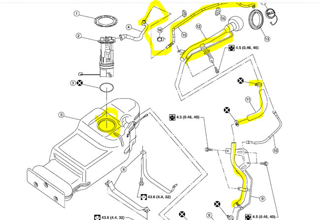

One other thought. If it was related to the fuel supply line to the engine, it would be spraying out under pressure from the pump. Also, chances are you would notice a drivability issue. So, I'm suspecting it is the tank itself (likely on top), the filler tube, or the vent. Something that is preventing pressure to build naturally in the tank.
See pic below.

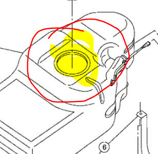

Based on that location, I suspect it is near or at the top of the fuel tank. If you safely lift and support the left rear wheel, it will help you gain access to see what is happening. What to do is this. With the engine off, have a helper turn the key to the run position while you check for anything near the tank or along the frame rail (where the line runs) that is leaking. When you turn the key from off to on (engine off), the pump will run a second or two to build pressure. At that point, you should be able to see if there is a leak.
If you are uncomfortable doing that, you can check fuel pressure and pressure drop off. With a fuel pressure gauge, simply connect it to the fuel system, start the engine, and then turn the engine off to see how quickly the fuel pressure drops. It should hold pressure for a good bit of time. If it drops off right away, we know there is an issue.
Here is a link that explains how to check fuel pressure:
Most parts stores will lend you the pressure sensor.
Also, I circled a section of the tank where the fuel pump module is located. There are several points in that area that can leak. If you do remove the tire to gain access, make sure it is secured with safety jack stands.
Let me know what you find.
See pic below.

Make sure it isn't an EVAP component that you aren't getting a smell from. But that wouldn't explain the loss of fuel. Regardless, since the tank is out, make sure there are no disconnected hoses or damaged parts, specifically the charcoal canister.. See pic below.
