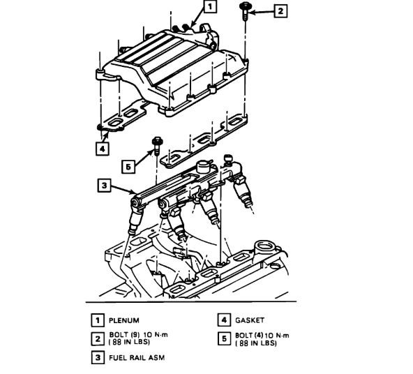

My car cranks but will not start. I noticed fuel leaking into the Air Cleaner housing. I assume the fuel regulator is not working, but I cannot find it on the vehicle, even after looking at diagrams. Is it hidden under the metal cover over the engine?

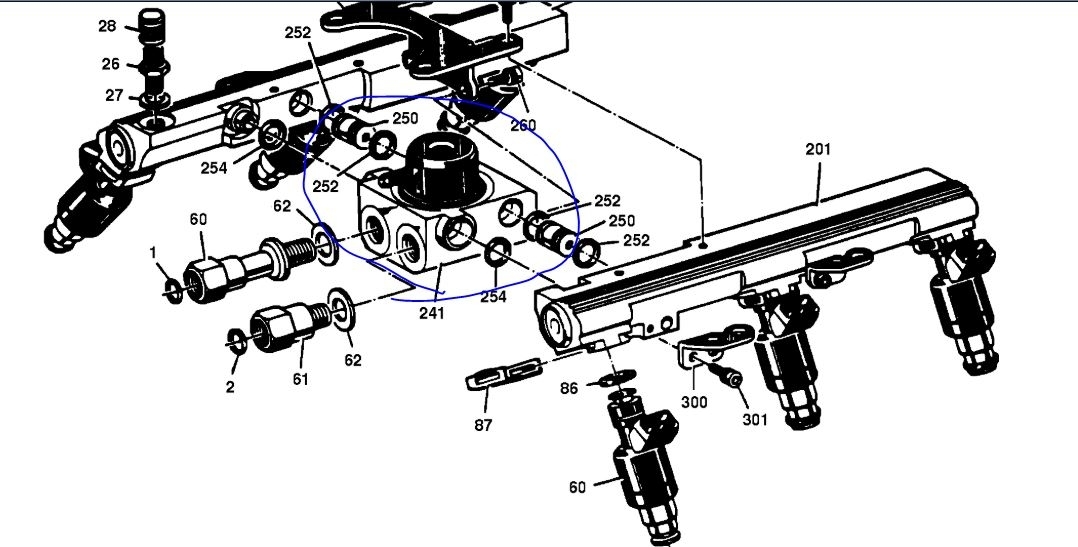

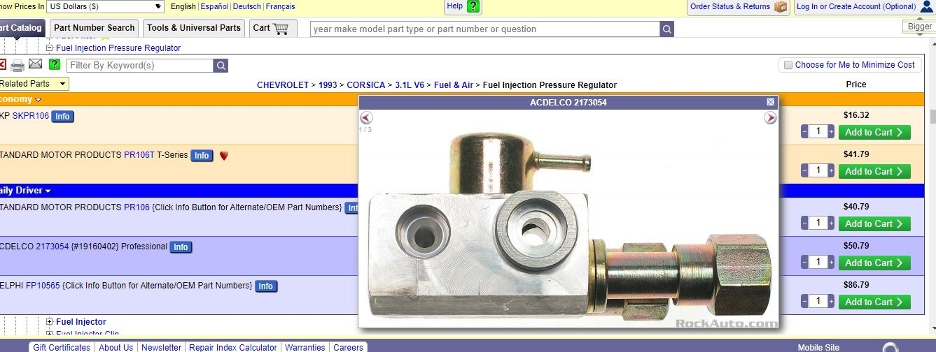

The regulator is on the fuel rail. I attached a picture for you to view. I also attached the part for you as well.
It is between the fuel rails with a vacuum line attached.
FUEL RAIL ASSEMBLY
An eight digit identification number is stamped on the left hand fuel rail (fueling even cylinders 2, 4, 6), as shown. Refer to this number if servicing or part replacement is required. Part names appear in the numbered list on the disassembled view.
NOTE: Use care in removing the fuel rail assembly, to prevent damage to the injector electrical connector terminals and the injector spray tips. Prevent dirt and other contaminants from entering open lines and passages. Fittings should be capped, and holes plugged, during servicing.
CLEAN: Before removal, the fuel rail assembly may be cleaned with a spray type engine cleaner, GM X-30A or equivalent, following package instructions. DO NOT soak fuel rails in liquid cleaning solvent.
REMOVE OR DISCONNECT:
1. Negative battery terminal.
2. Relieve fuel system pressure.
3. Intake manifold plenum.
4. Fuel line bracket bolt.
5. Fuel lines at rail. Use a back-up wrench on the fuel rail fittings to prevent them from turning.
6. Fuel inlet and return line O-rings (1, 2), and discard.
7. Vacuum line at pressure regulator.
8. Rail retaining bolts.
9. Injector electrical connectors.
10. Fuel rail assembly.
DISASSEMBLE:
Injector O-ring seal from spray tip end of each injector. Discard seals.
ASSEMBLE:
Lubricate new injector O-ring seals with clean engine oil, and install on spray tip end of each injector.
INSTALL OR CONNECT:
1. Fuel rail assembly in intake manifold. Tilt rail assembly to install injectors.
2. Fuel rail attaching bolts. Tighten fuel rail attaching bolts to 10 N-m (88 lb. in.).
3. Injector electrical connectors.
4. Vacuum line to pressure regulator.
5. New O-rings (1, 2) on fuel lines.
6. Fuel feed and return lines. Tighten fuel line nuts to 23 N-m (17 lb. ft.). Use a back-up wrench on the fuel rail fittings to prevent them from turning.
7. Negative battery terminal.
8. Fuel filler cap.
9. Turn ignition switch to the "ON" position for two seconds, then turn to the "OFF" position for ten seconds. Again turn to the "ON" position, and check for fuel leaks.
10. Intake manifold plenum.
11. Perform the "Idle Learn Procedure." The ECM will need to relearn the IAC valve pintle position following battery reconnect.
