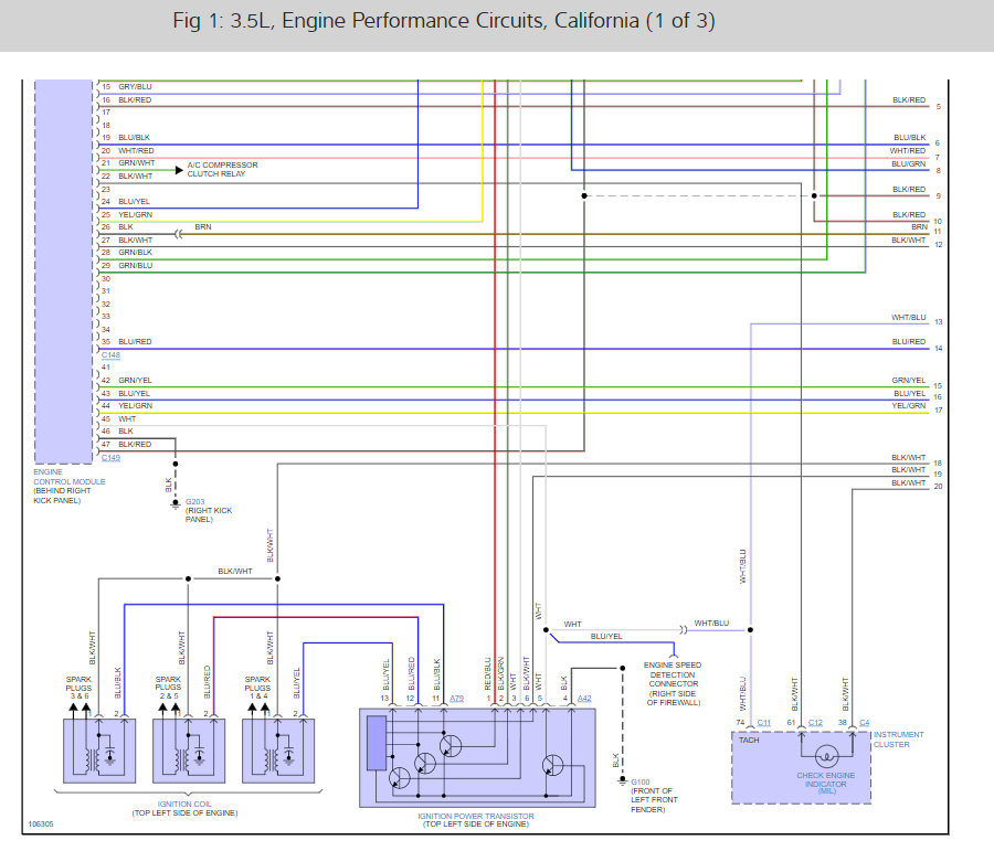

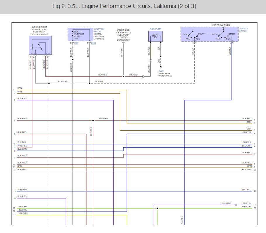

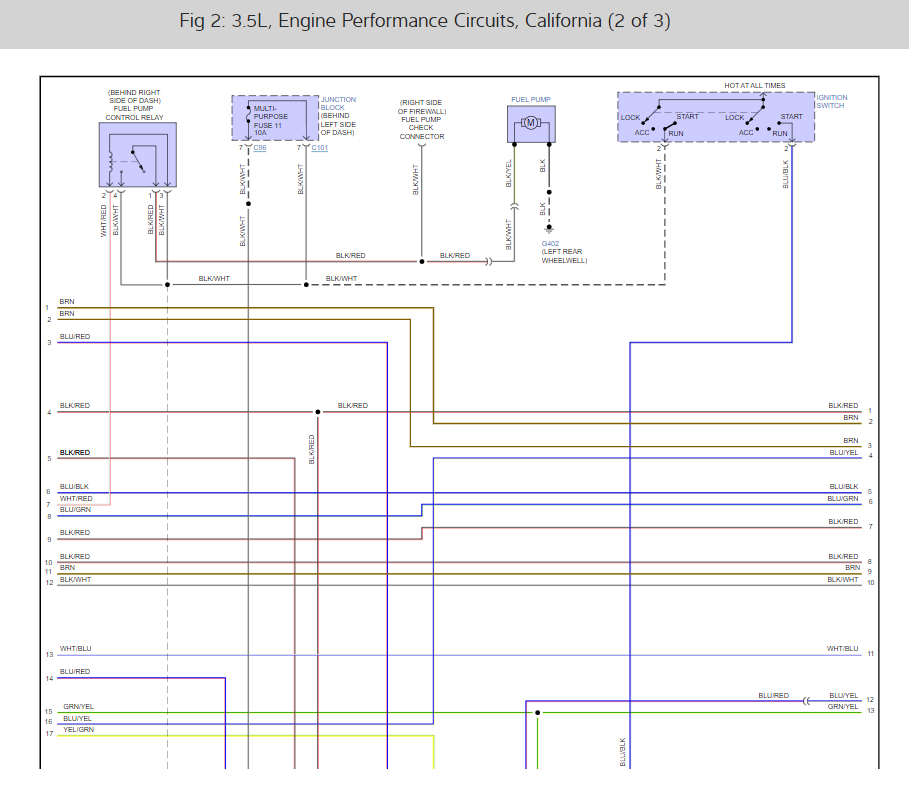

The car just got a new battery and starts but shuts off straight away and won't idle. I can't hear the fuel pump kick in when I turn the key, so I'm wanting to check the fuel pump relay/fuse before I order and replace the fuel pump itself.
Can someone tell me where the relay might be and what It looks like?

Ken, thanks for the Tip. I'm certain that the fuel pump is the issues as I can't hear it operating when my mate turns the key. I simply want to check the electrical side of the system to see if the pump is getting power before I have to pull the tank out and replace the pump.

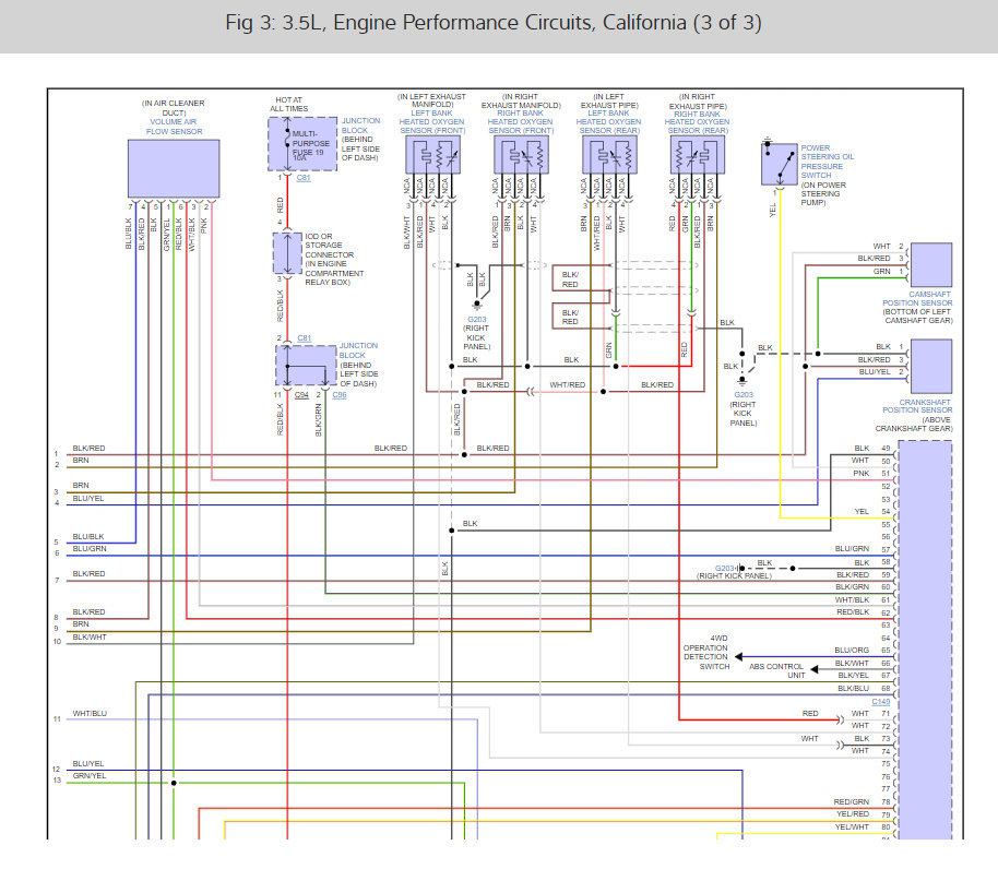

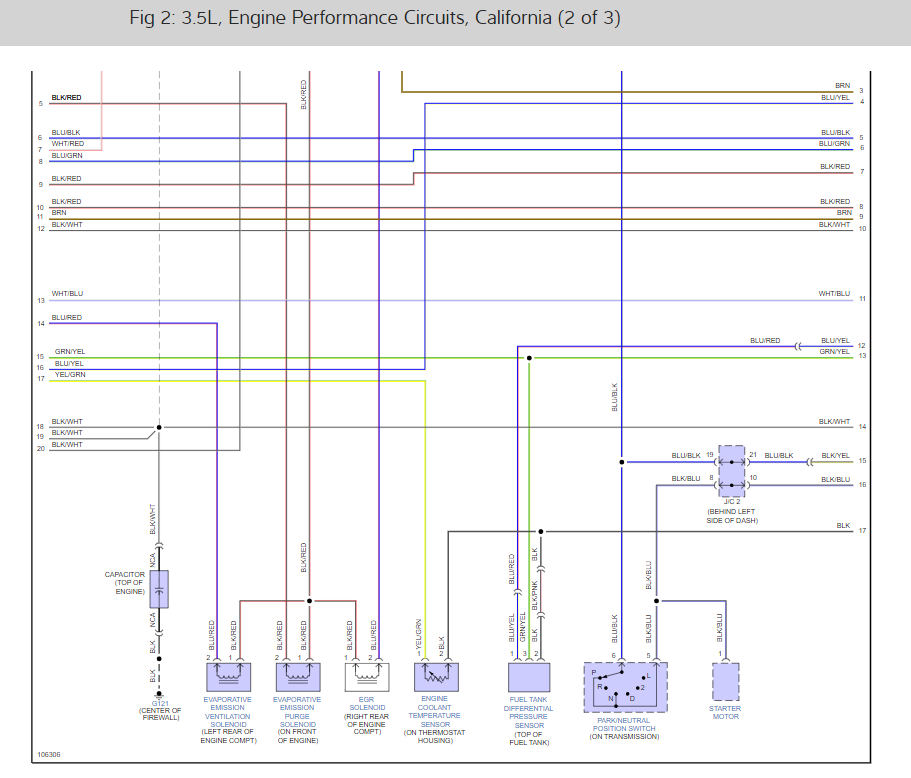

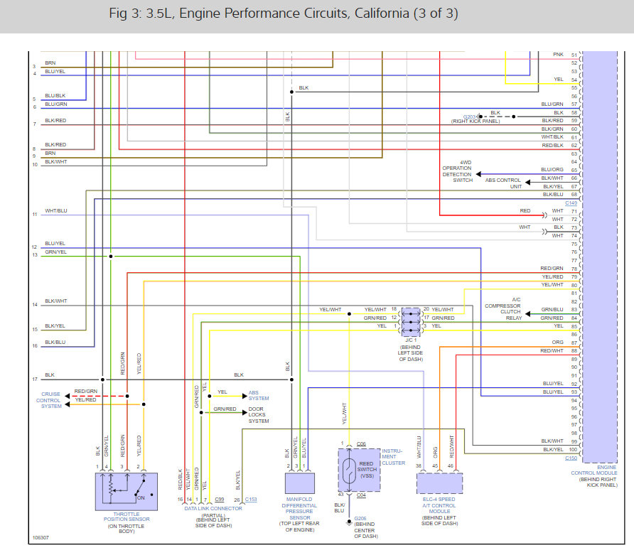

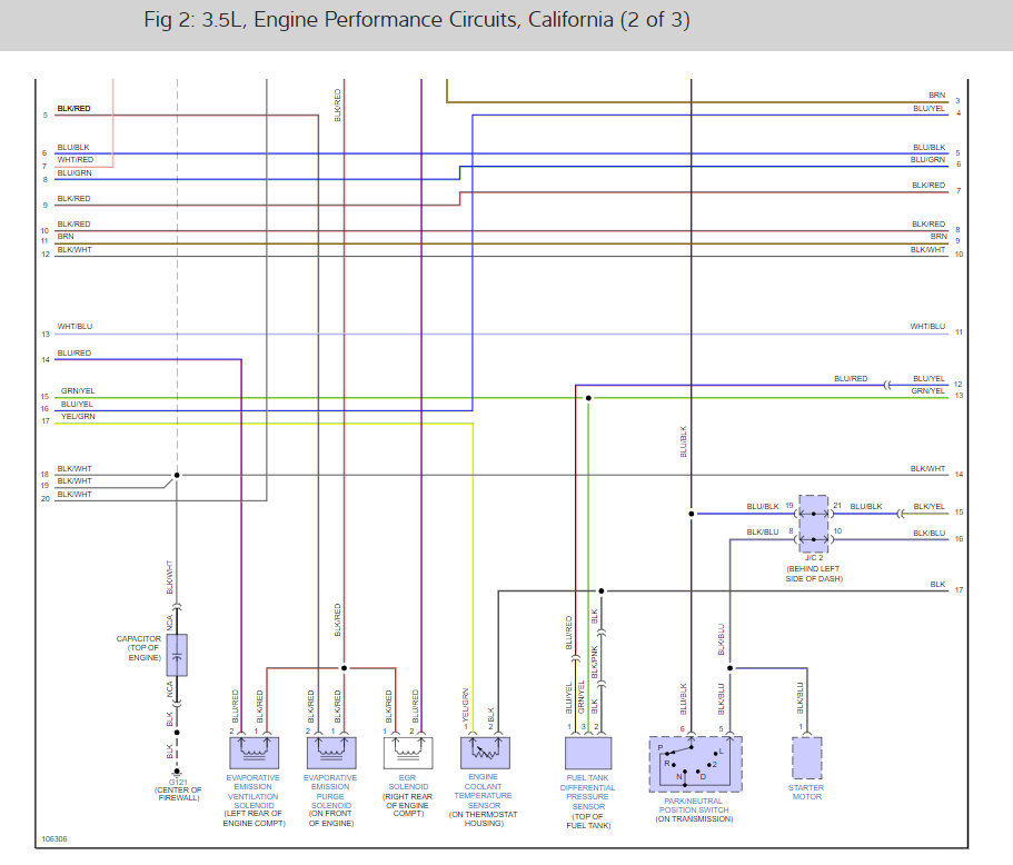

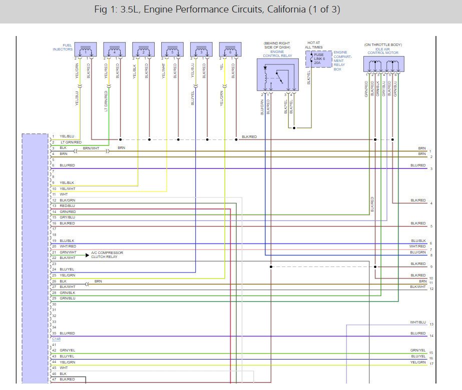

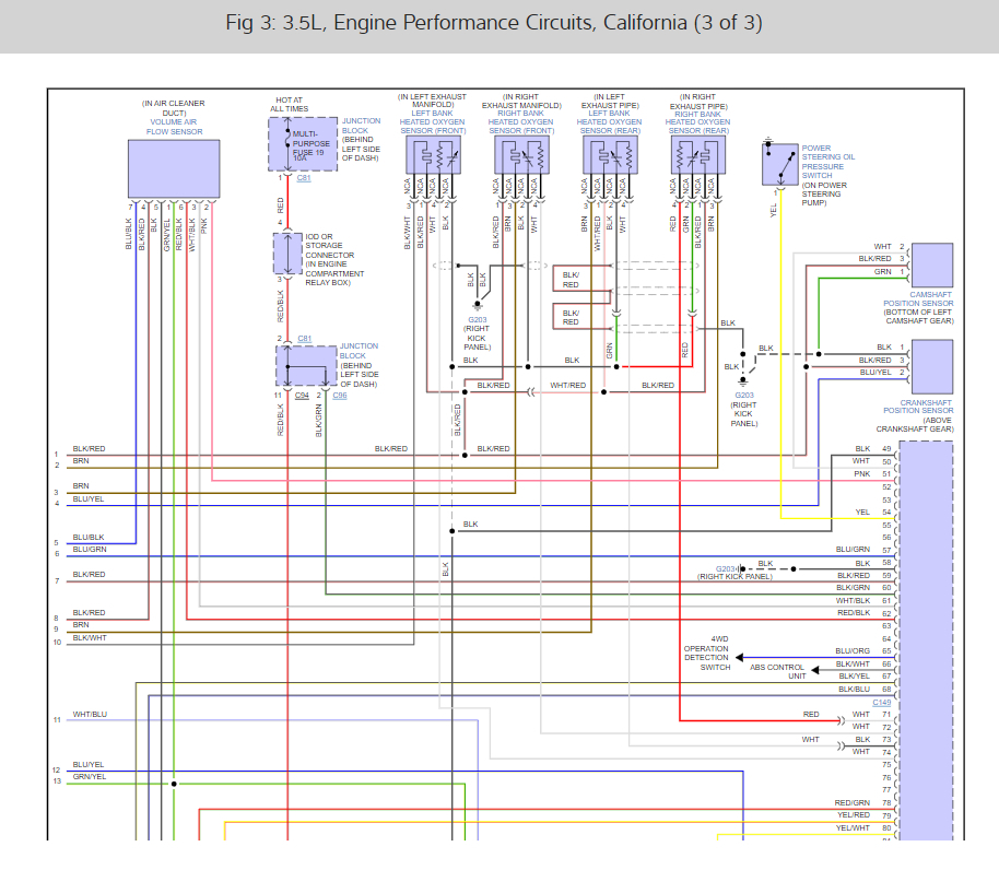

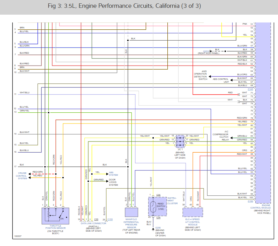

Yes, here ae the engine wiring diagrams and a guide to help you test the connections:
