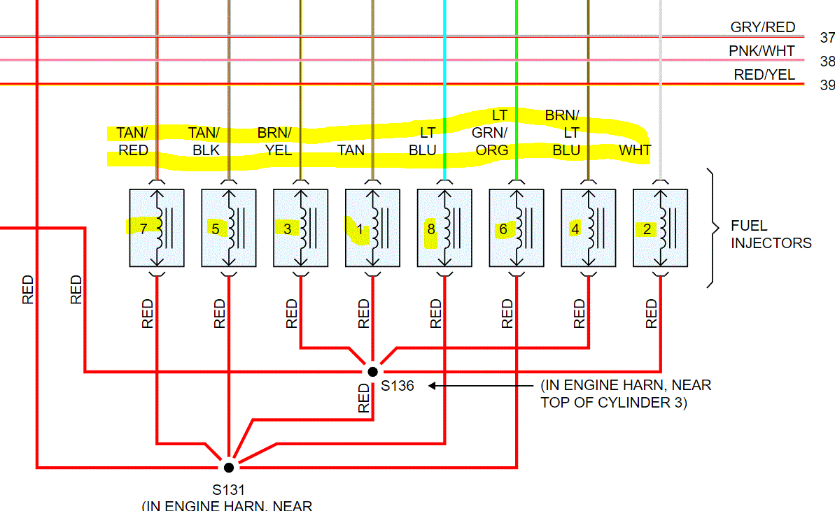

Hello, I had a leaky fuel injector plus they were getting old, so I replaced all eight, the truck was running great prior to me changing the injectors other than a rich code, now that I have replaced them, I have the most violent idle misfire I have ever witnessed sputtering bucking absolutely no power if you have any opinions, please let me know.

Have you scanned the computer again to see if there are new codes? Are there any fuel leaks? Have you confirmed the wiring connectors are to the correct injectors? If you look at the pic below, it shows each fuel injector wire color to the PCM and the cylinder. Make sure they weren't mixed up.
Next, there is a splice to power near cylinder 7. It's in the engine wiring harness. That is where all the red wires which power all the injectors are spliced together. Make sure that wasn't damaged.
Let me know what you find or if you have questions.
See pic below. Also, if possible, record the engine cranking and then running and upload it so I can hear what it's doing.

Okay, sorry it has taken me so long to get back with you. after tinkering around tonight with it I realized that when I pushed the pig tail hard with pressure the engine would actually idle smoothly until I let go. so, I took all the injectors out and put all the old back in it and it's running like a brand-new truck now. thank you so much for all your time and help through these past few days. The pig tail clicked into place after realizing that they weren't connecting fully to the new injectors. the old ones clicked right into place.
