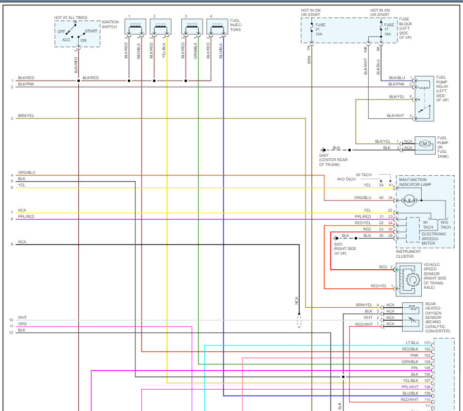

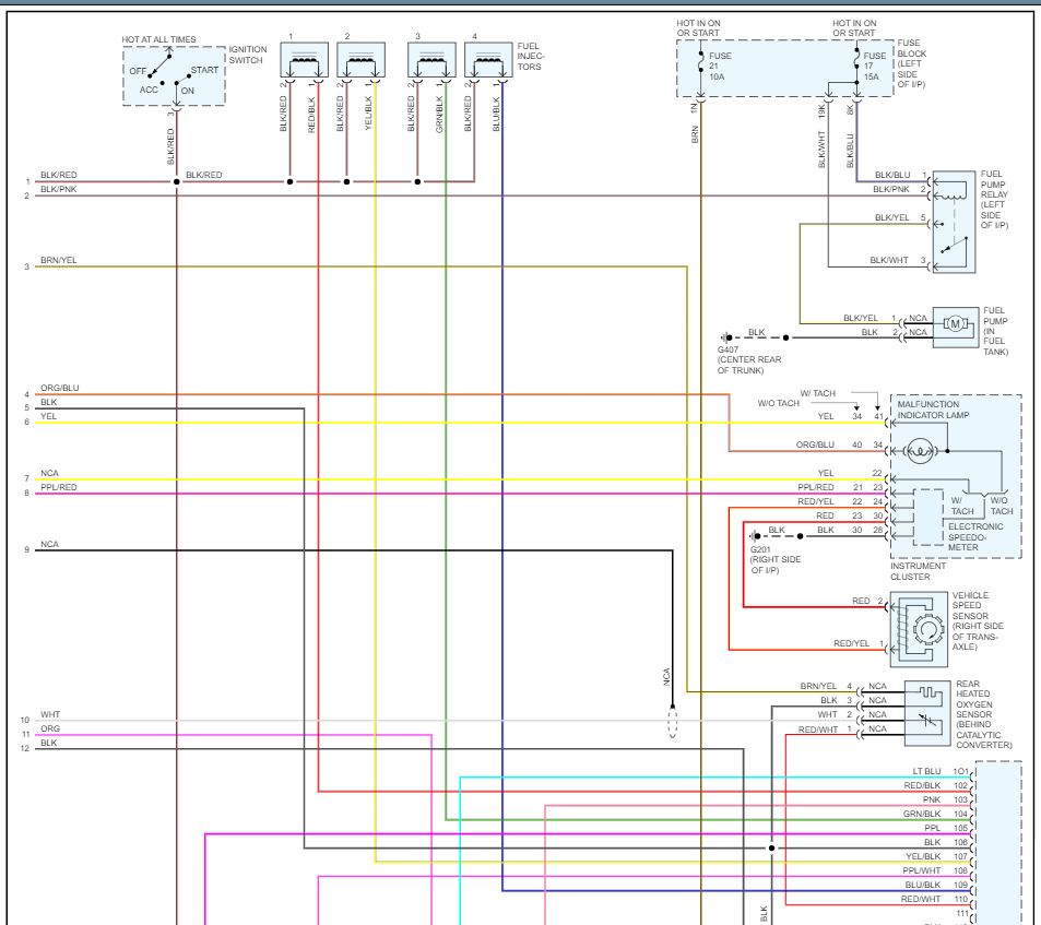

When the ignition switch is turned on fuel injector negative turns to positive?
1997 NISSAN SENTRA
174,401 MILES • 1.6L • 4 CYL • 2WD • AUTOMATIC
CHINNEE
fuel injector problem.
Aug 17, 2023 at 12:00 AM
  • 55,456 POSTS

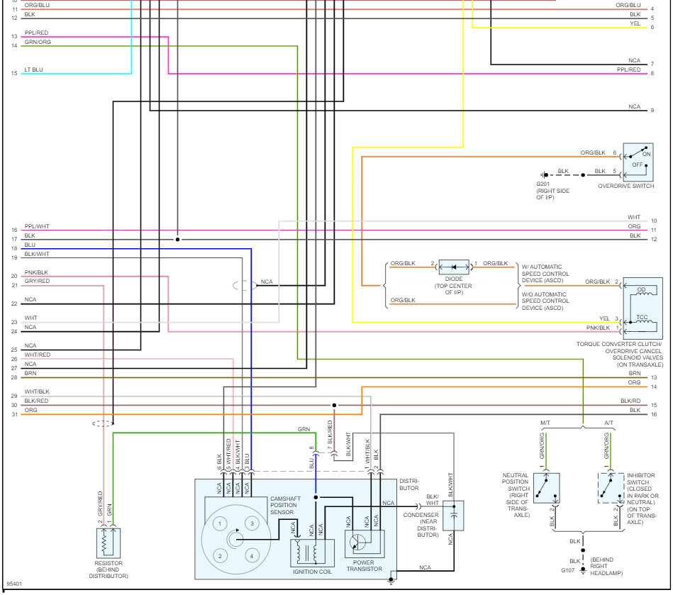

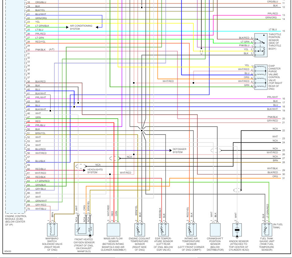

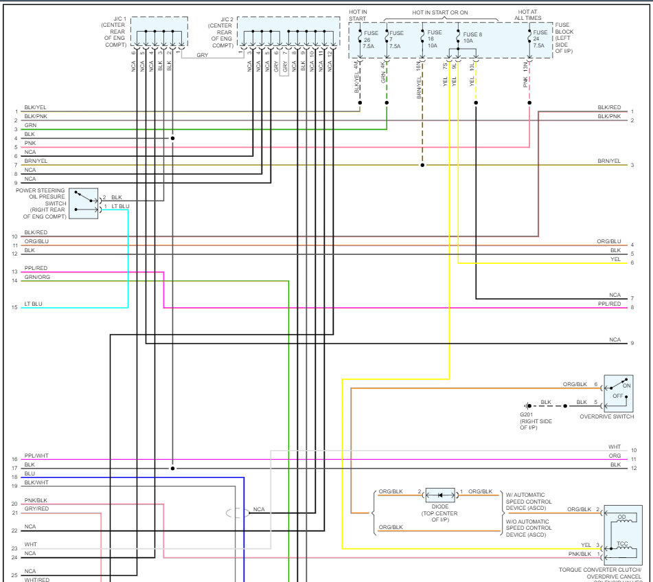

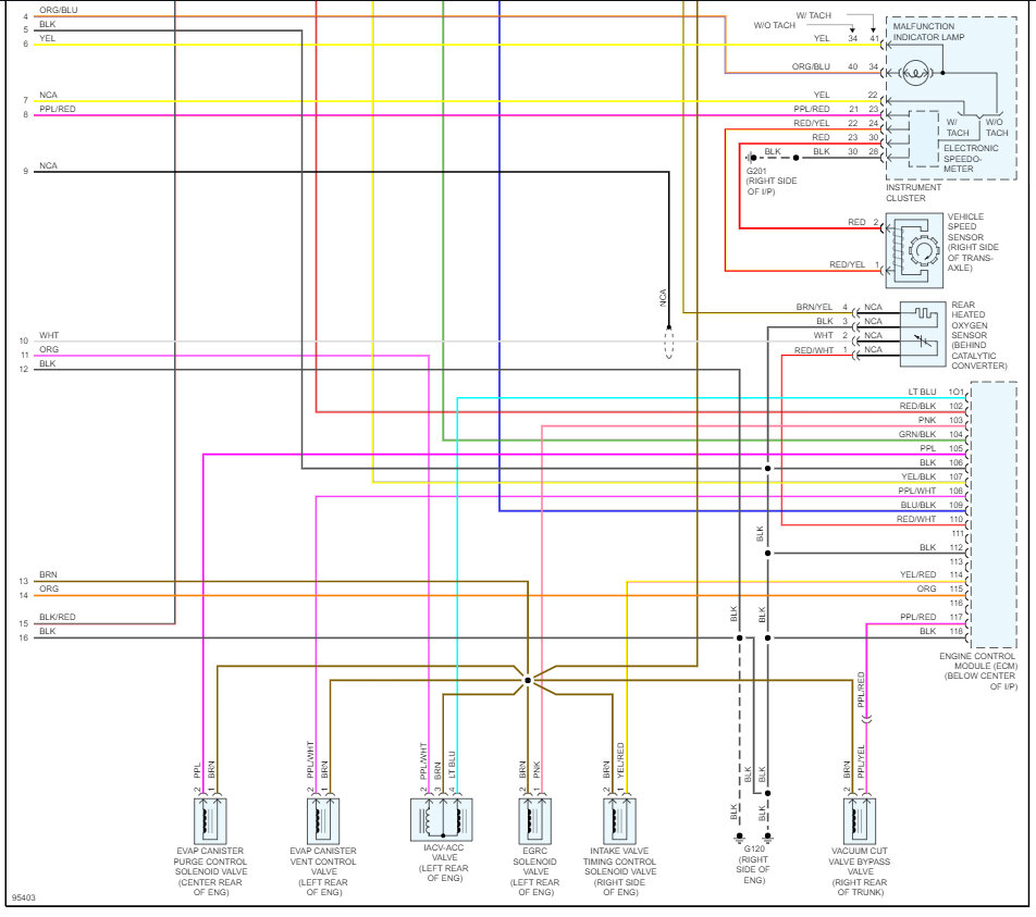

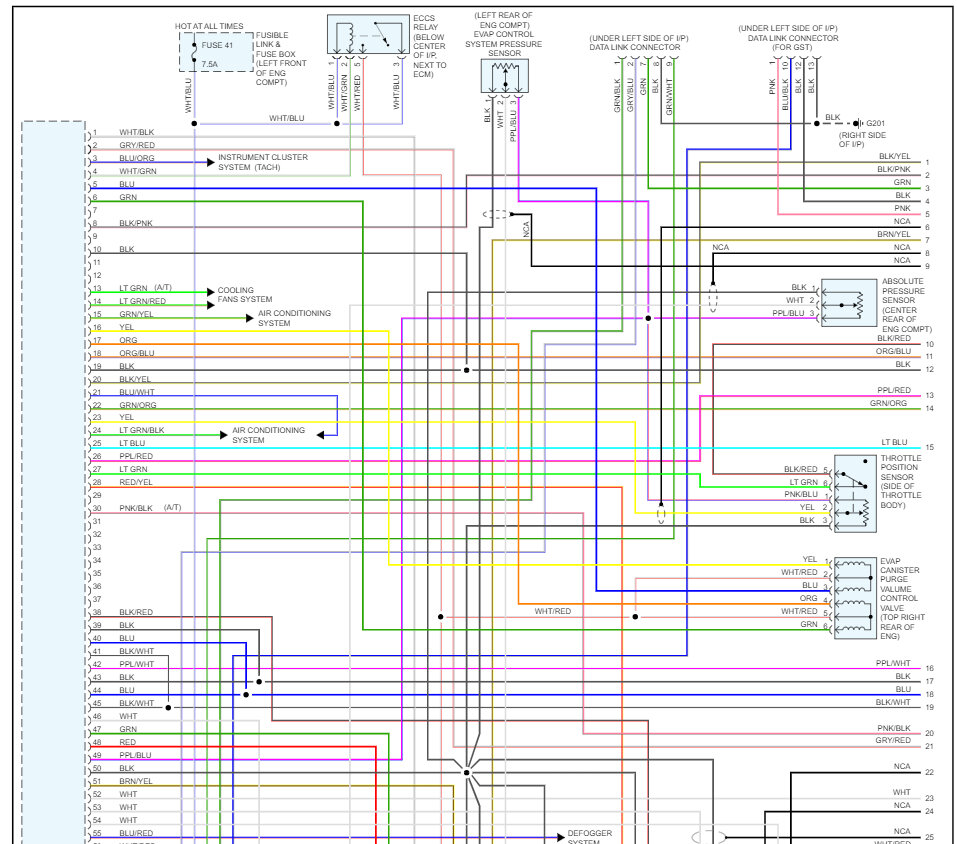

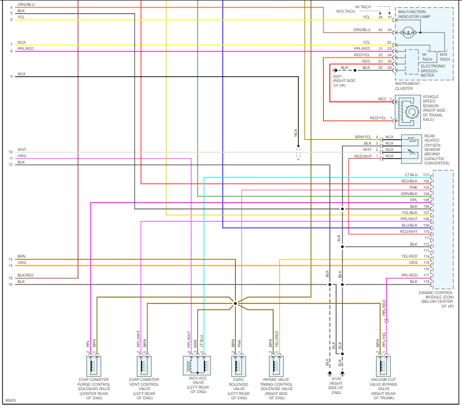

This happens when the fuel injector is not getting power or the PCM is shorted out. I would check all fuses and grounds to start. Also, the fuel injectors get their power from the TPS sensor. Here are the engine and fuel injector wiring diagrams so you can see how the system works and which fuses to check. This guide can help you:
Check out the images (below). Please let us know how it goes.
