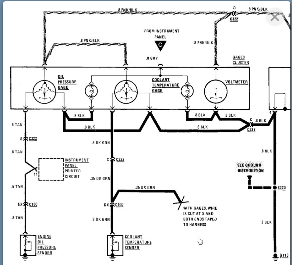

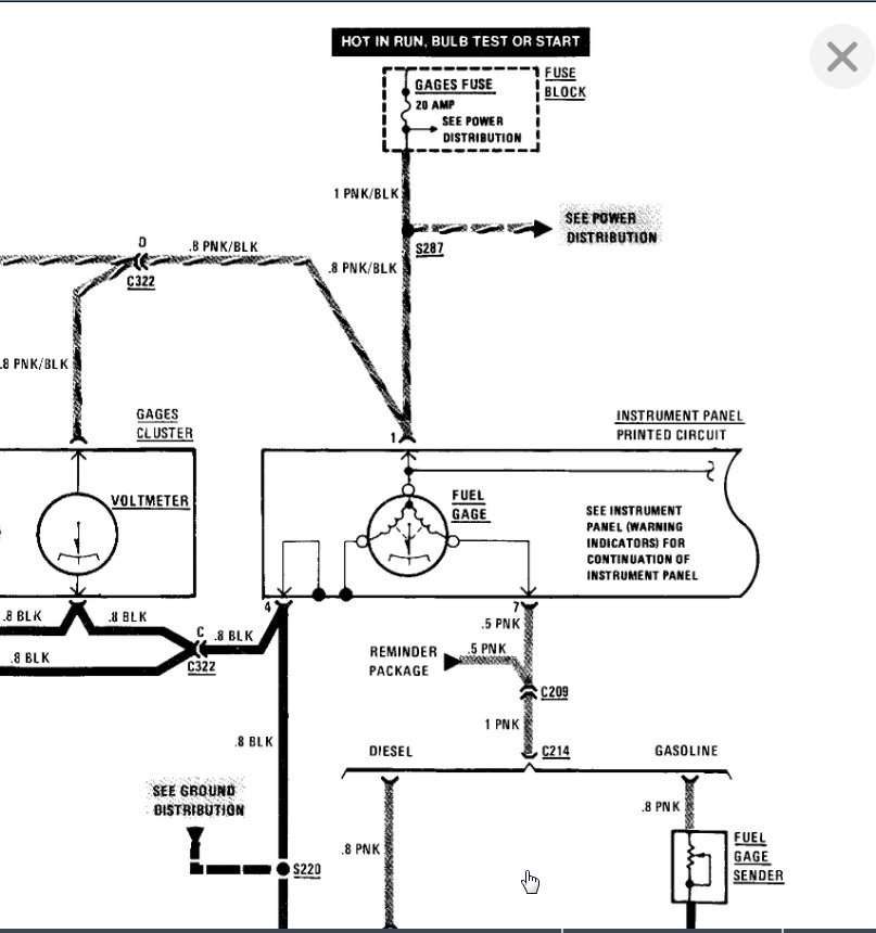

Fuel gauge stopped working, fuel sending unit replaced. gauge replaced still not working. it is a 3 stud gauge. pulled out cluster did not have a meter so I checked with a test light. looking at dash post on left was hot key on bottom was ground right post hole nothing. was told left is gauge right is 12 volt bottom is ground. any help?

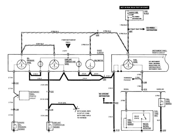

Here is the wiring diagram you requested. Here also is a tutorial showing how to test wiring:
I've attached the diagram below. Hope this helps and thanks for using 2CarPros.

picture is hard to read kind of fuzzy.

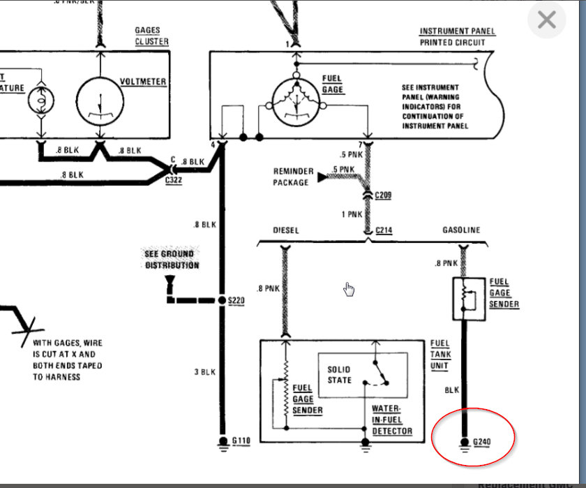

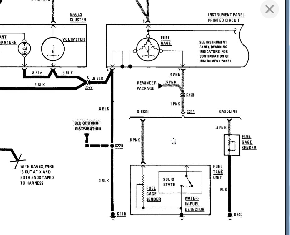

I broke it into sections for you which should show up a little better. Thanks

Does the ground wire on the tank sending unit if it comes loose or if there is not one can this cause a malfunction?
Feb 24, 2021 at 11:39 PM
In short, yes this will cause an issue. Basically if there is no ground, it will either not respond or act erratically if it is able to find a ground through another part. This is called back feeding so clearly this ground shown below needs to be intact.
