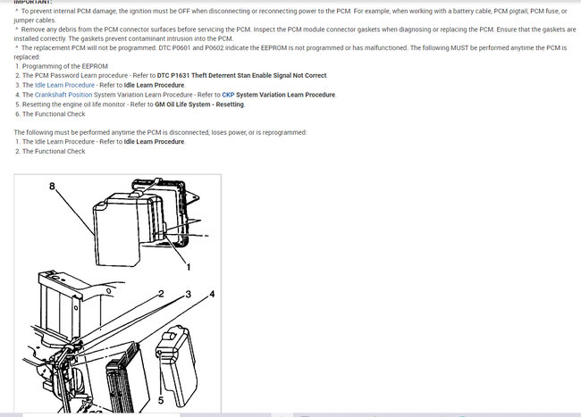

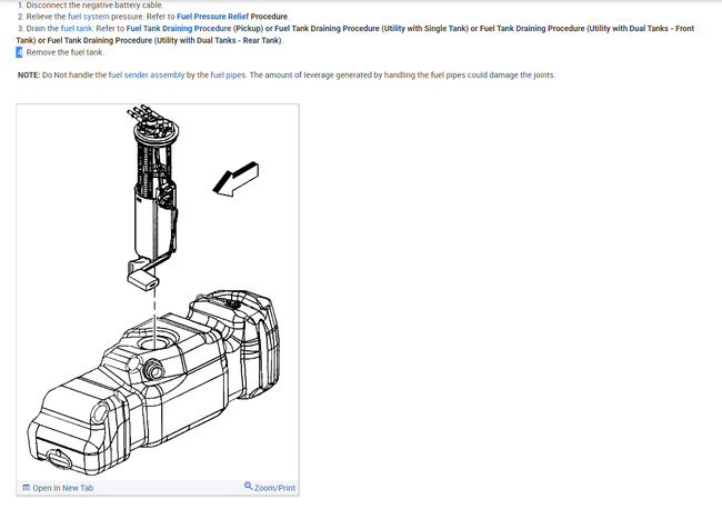

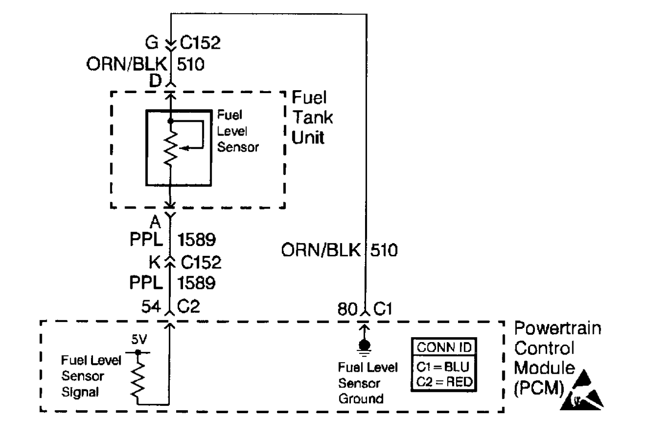

I have changed instrument cluster, fuel pump and sending unit, and new ECM. Also tested a new body control module and cannot get the fuel gauge to respond. I have even hooked up the old pump assembly and moved the float manually still didn't read. I'm at a complete loss.

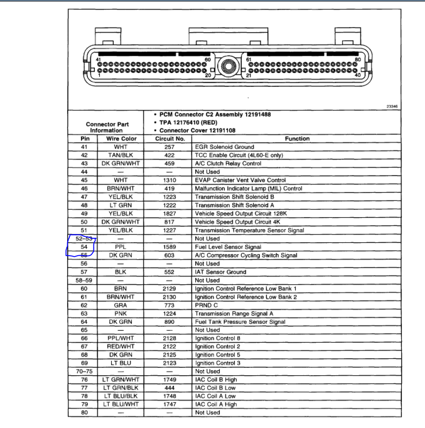

Good morning,
I attached a wiring diagram for you below for the sender unit. You need to test for voltage at the connector and the ground. You should have 5 volts at the purple wire.
Use your voltmeter and put both leads into the connector and tell me the voltage.

Unplugged at the pump I don't get any voltage across the orange/black and purple wires with the key on.

Check just the purple wire for power and ground the other lead to the body.

.01 volt (set at 20v on multimeter) unplugged at fuel pump with key on.

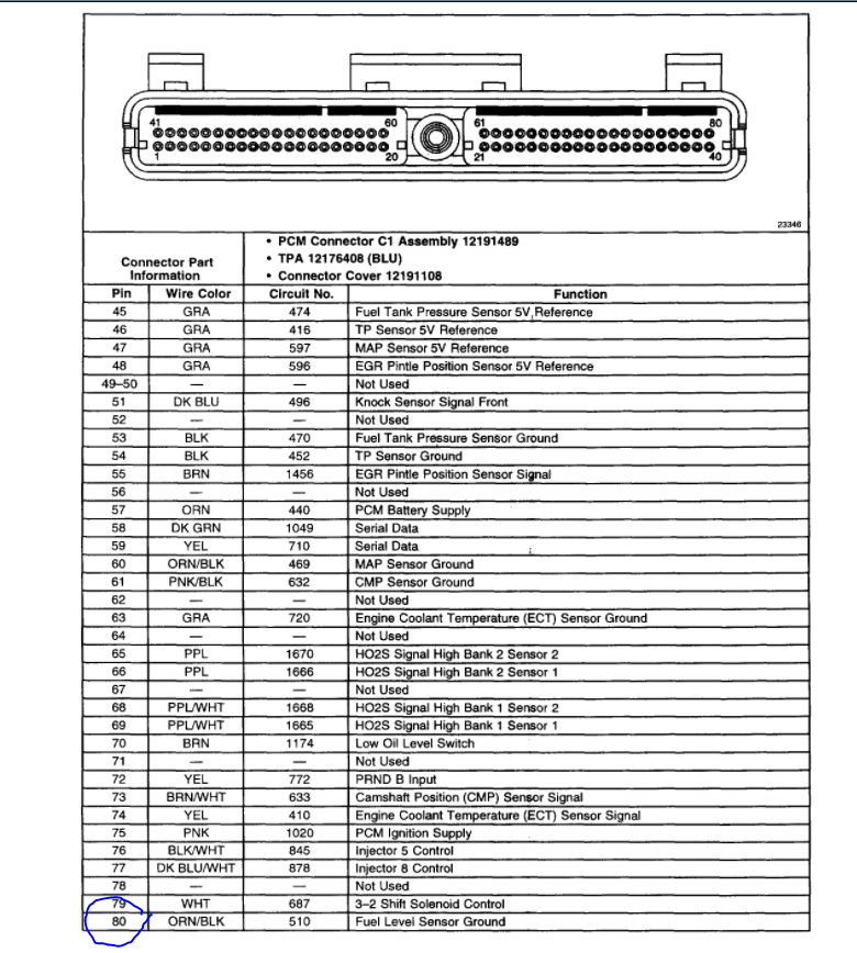

I attached the wiring diagram for you at the ECM. The blue connector contains the power output to the sender. It should be 5 volts.
The other is the red connector pin 80 is the ground.
Jul 21, 2021 at 8:48 PM
SSROBERTSON
  • 80 POSTS
Same voltage as the rear. And verified ground on pin 80 as good.

From the ECM? The purple wire?

If you have no voltage from the ECM, the ECM is the issue.

I just replaced the ECM yesterday. This was the exact same problem the old one had. Could it be the signal going to the ECM?

Was the ECM new or used?
No, the signal is generated by the ECM out to the sender and then comes back on the return side. The fact you have no 5-volt reference tells me you have a bad ECM.

Remanufactured ECM.

Can I just use a 12 volt to 5 volt driver to resolve this issue? It's the only problem I'm having with the ECM and it's starting to get expensive just throwing parts at it.

You should have a warranty for your ECM.
No, the signal has to come from the ECM.
