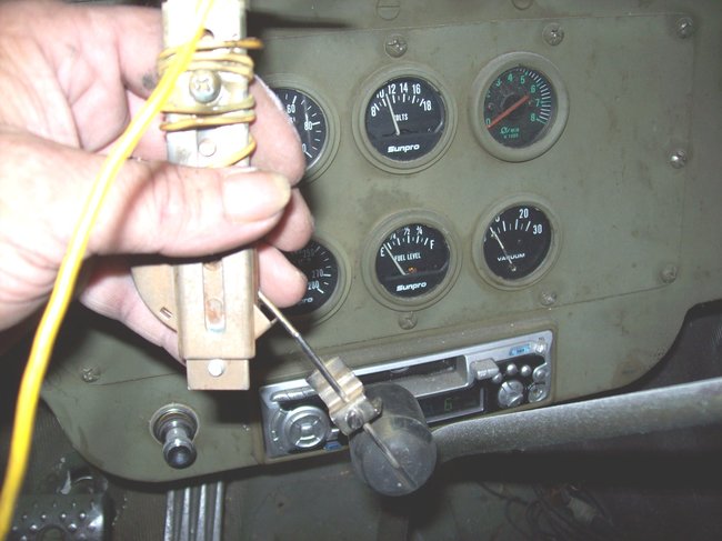

Insure your sender wire (pink) has a good connection to the sender.
Now really look this part over before you proceed.

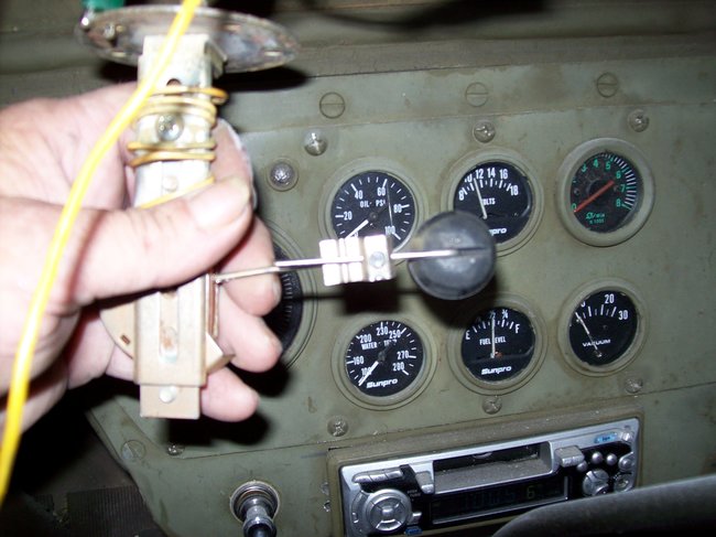

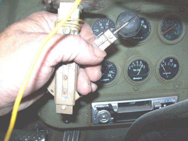

The float swings in/on a pivot hole. On either side of the swinging arm is a a "bendable" (limiter) tab. Look good!
With some needle nose pliers, bend (either the full side tab or the empty side tab) carefully and slightly to allow a little more movement (and be able to put it back, if need be!).
This will increase or decrease what the gauge reads (and may increase or decease the floats travel).

Lacking good pics of my '77 CJ-5s sender---I have included a few from my '46 Willy's sender and gauge.
