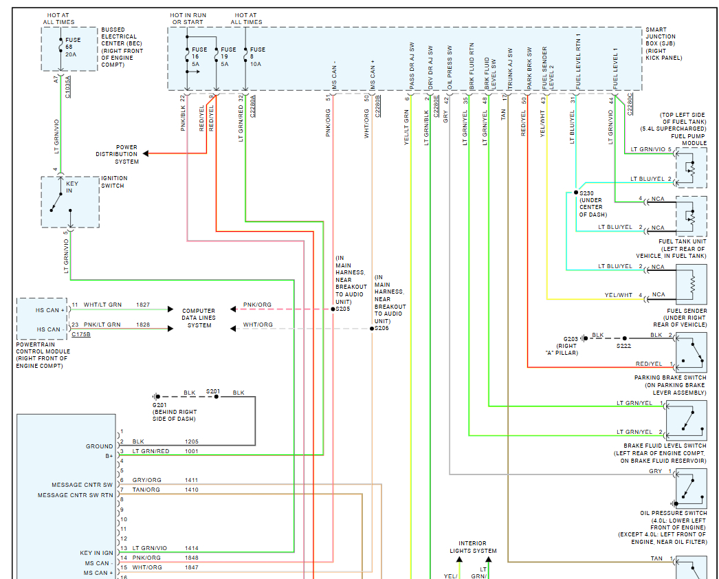

Have a 2008 GT500 with about 2,500 miles. I have several code issues, which I have resolved. We have brand new fuel pumps, assembly, checked sending units. Everything checks out. The car runs fine, but as soon as the car starts or turn the key gas gauge goes to empty. It also says zero miles to E. For a brief second it went to 1/2 full then E. Both sides of the tank are full as we just had to pull both sides under the rear seat! Any ideas on this fuel issue? Currently no codes right now.

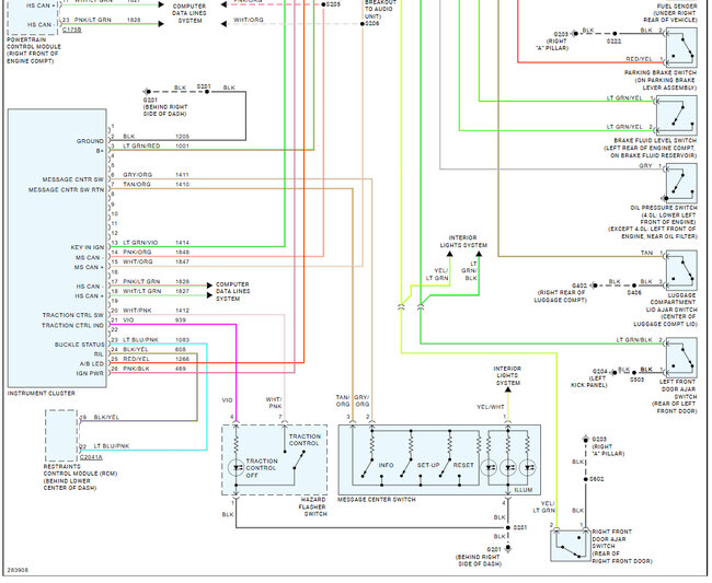

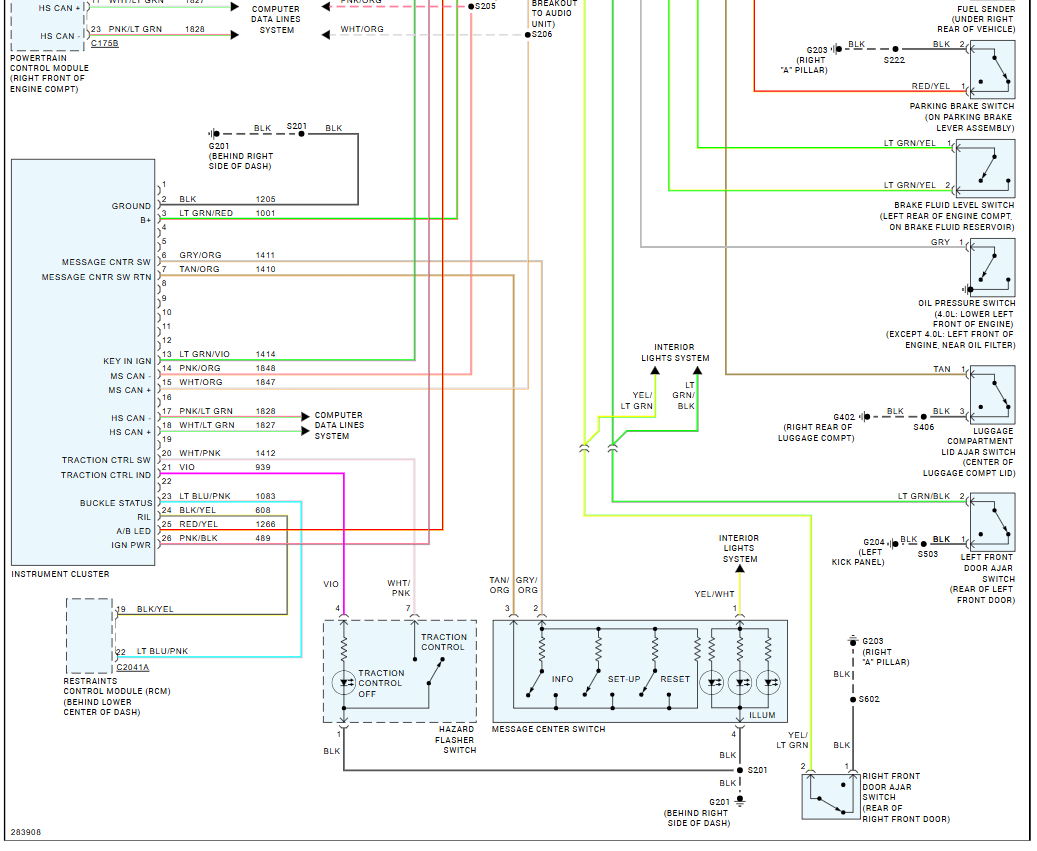

It looks like the wiring for the fuel senders goes through the SJB and then to the cluster. We should do a CAN scan to see if these components have any codes. You can get a CAN scanner (Controller Area Network) which will work on most cars from Amazon.
https://youtu.be/u-4syLc-ifQ
Here are the fuel gauge wiring diagrams so you can see how the system works; it sounds like we have a connection problem or the circuit board in either the smart junction box or the cluster is bad.
Here is a guide to help you test the wiring:

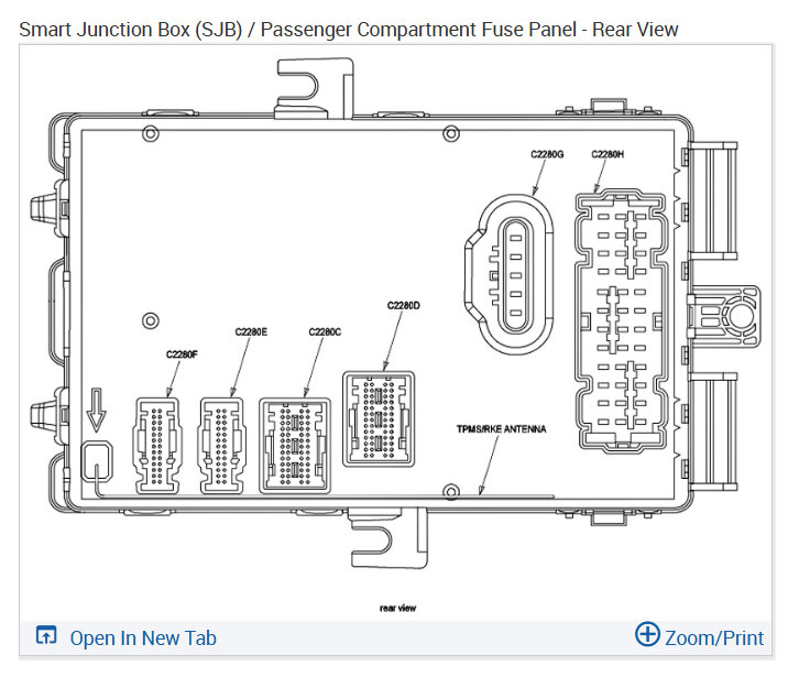

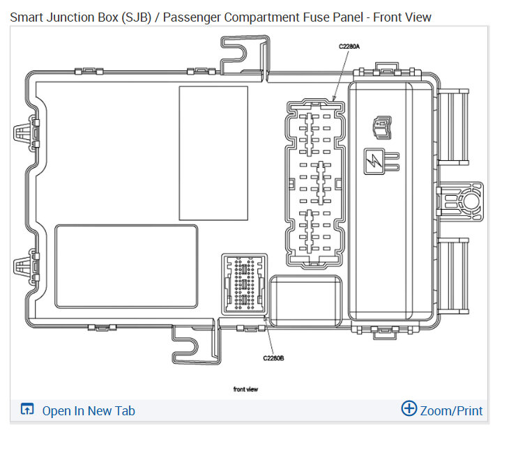

I see that both of the fuel level senders go through the SJB which is at the right-side kick panel, I would remove it to check the connections for corrosion which is common when the car is in wet weather. The only thing between the senders and the gauge is the wiring and the SJB. Here is the location of the SJB so you can check it out. If everything looks okay and the wiring is good, I would replace the SJB. Check out the images (below). Please let us know what happens.

the SJB has circuit boards/processors inside of it. You can check the wiring between the level sensors and the SJB by following the post above.
