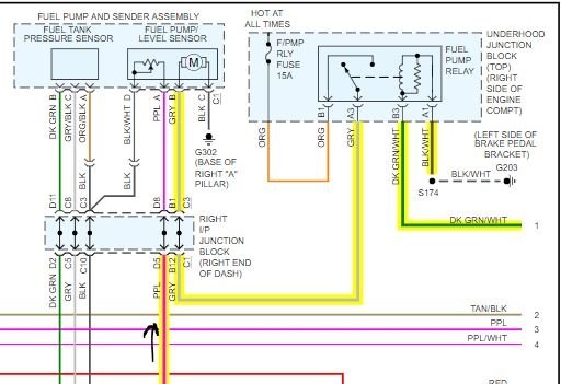

Fuel gauge still reads empty. new step motor, new fuel pump assembly.
Aug 7, 2019 at 10:31 AM

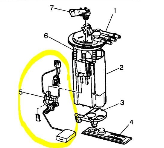

When you replaced the fuel pump assembly, was a new fuel level sensor also installed or is that what you are referring to as the step motor?
I circled the component I am referring to in the picture below.

Complete assembly and float assembly and step motor in dash for gauge.

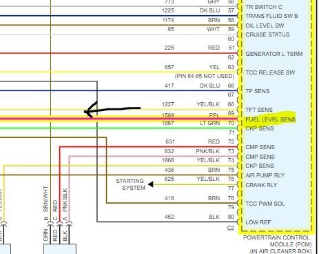

Once it starts with starting fluid, does it run normally after? And as far as the gauge, it could be an issue with the PCM. Have you checked for corrosion or damage to the pin in the connector? Take a look at the two pics. The first shows the level sensor in the tank. The ppl wire comes direct from the PCM. Have you checked it for power? The second pic is the other end of that wire at the PCM.
Also, confirm ground for the level sensor. It is part of a splice which may have failed. You can see it in picture 1.
