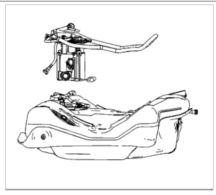

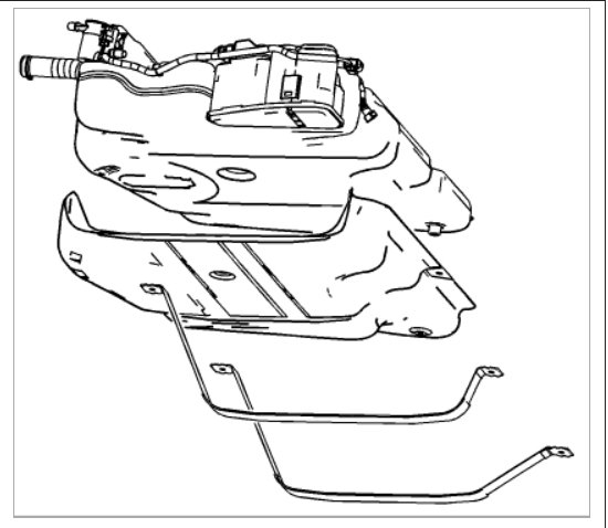

Hi I need to change my fuel filter can you help me?
Sep 7, 2016 at 11:41 AM
SATURNTECH9
  • 30,868 POSTS
The fuel filter is in the tank here is a guide to help you see what you need to do to change it out with diagrams below to show you on your car.

How do you take off the fuel filter cover? I unloosen the gas line and the bracket screw, but it still won't come down.
Jun 11, 2019 at 7:08 AM (Merged)
HMAC300
  • 48,601 POSTS
that is all part of the pump module assy. and the tank has to beremoved to get that best to leave alone.

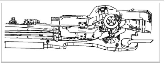

BUCSFAN5
  • 68 POSTS
IM trying to change the fuel filter on my 04 Malibu but want2make sure IM @the right spotoh & i want 2make sure i pull the right fuse
back by the fuel tank in the front.
compare the new filter to the old one to be sure.
BUCSFAN5
  • 68 POSTS
Okay, so if where I'm looking would it be behind the tank? do i have to move the gas tank it kind of looked like i may or it would be easier.
no, it is in front of the tank. no, you do not move the tank, it is tight, just take your time.

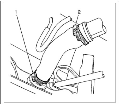

GENICE
I've bought the fuel filter and the little tool to make replacing it easier. Just can't seem to figure out how to get the filter off. Do I have to remove the gas tank to get to it?
Relieve fuel system pressure. Refer to Fuel Pressure Relief Procedure.
Raise the vehicle. Refer to Lifting and Jacking the Vehicle.
Disconnect the quick-connect fitting at the inlet of the fuel filter. Refer to Quick Connect Fitting(s) Service (Plastic Collar).
Disconnect the threaded fitting at the outlet of the fuel filter.
Drain any remaining fuel into an approved gasoline container.
You will need a 13/16 open end wrench, a 5/8 line wrench and a good pair of pliers.

2003 Chevy Malibu 143000 miles
I need to know how to get the clamp off of the fuel line side of the filter, that is without breaking it off? I can get it open, but can't figure out how to get it off.
BLUELIGHTNIN6
  • 16,542 POSTS
You have to use a back-up wrench to remove fuel line from filter. Then disconnect quick-connect fitting from filter and remove fuel filter from mounting bracket.
