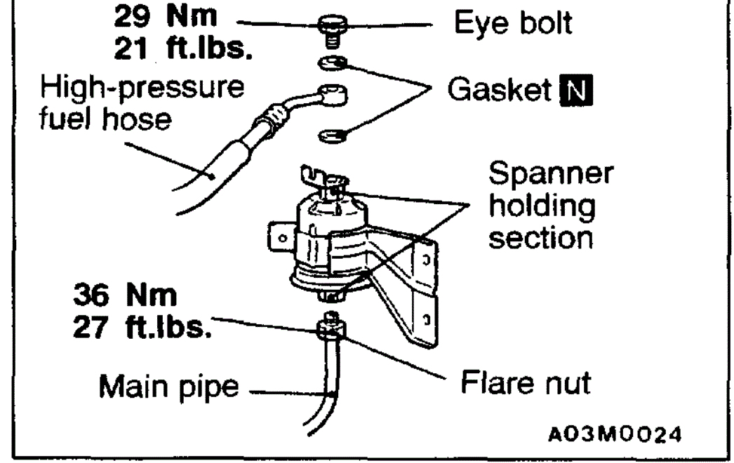

I need help finding the fuel filter and electrical fuel pump. Not the in-tank filter, and not the micro filter in the high pressure fuel pump, but the one that should be mounted on the rail. My fuel sender module in the tank does not have a pump, but i can hear that there is a pump working, need help finding that as well.

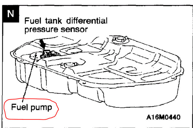

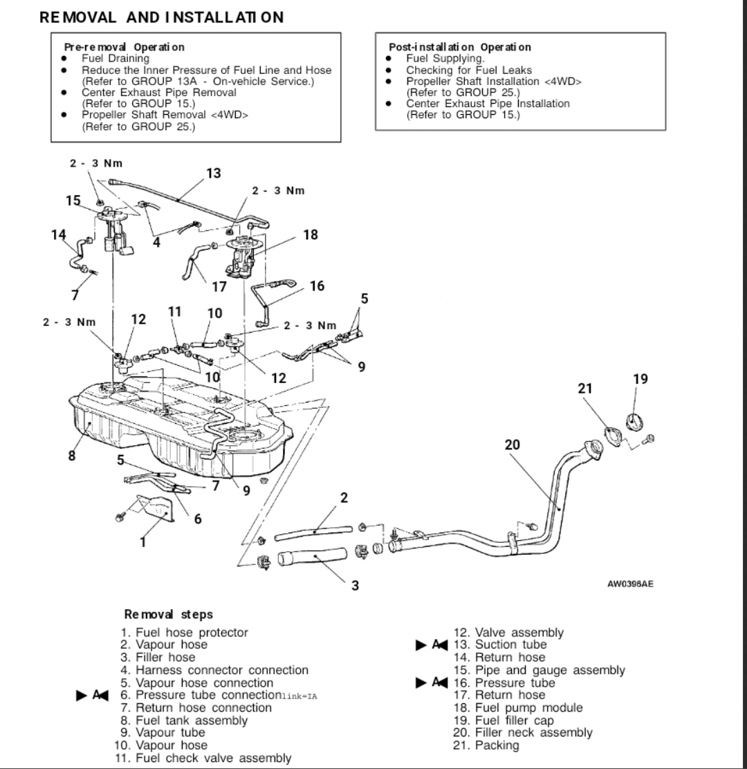

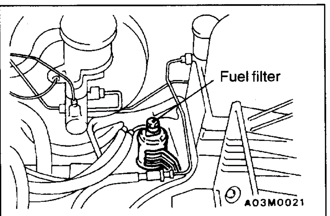

This vehicle isn't offered in the US, so my technical information is extremely limited. However, I believe it is the same as the Mitsubishi Mirage. I attached two pictures below for the fuel filter on the Mirage. See if it is the same on your vehicle. Picture 3 indicates the pump is in the fuel tank.
Let me know if this helps.

Thanks for the answer. Its not the same though. The "pump" inside the tank does not have a pump, its a net filter on a pipe that connects to a hose above the module and a fuel level floater next to it, i suspect the pump is mounted above the tank. But i can't imagine the filter to be so hard to access.

I managed to find out that this car is special care with two connected tank modules one on each side of the tank, with one of them having a pump built in. I will add a picture if someone else have the same problem. So i found the pump, took it out and cleaned the filter bag, put it back. And now the car will only crank but not start. Guessing it was half-dead and didn't like to be touched. :/
