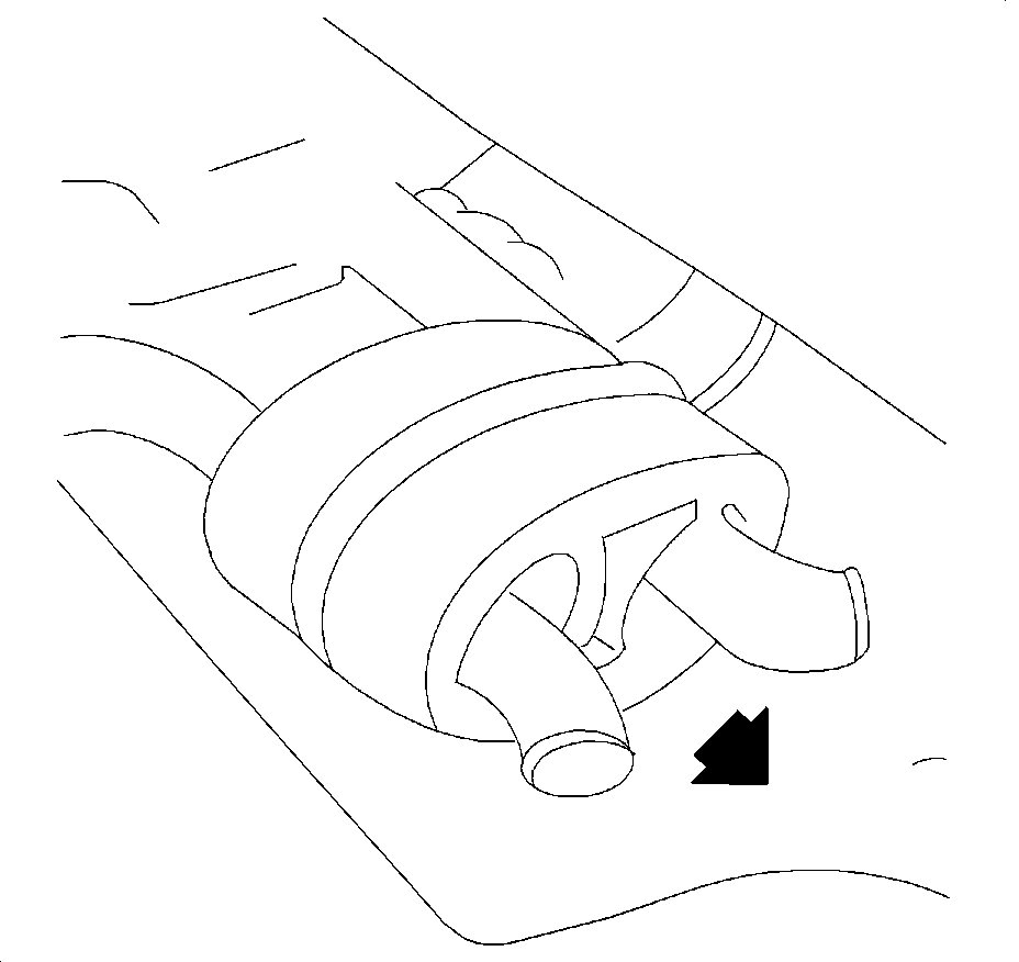

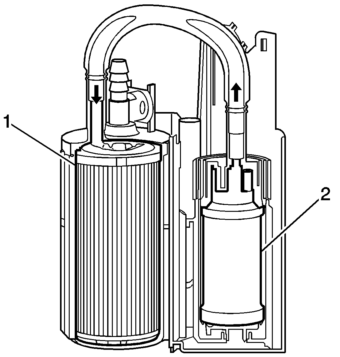

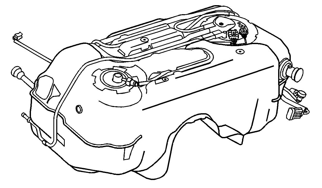

I have purchased a fuel filter for my car. I went to three different companies until I found one in stock. They all showed the same part. I have been told my car has an in-line fuel filter that is supposed to be located right inside the chassis, near the rear drivers side tire. There is nothing there. I see the fuel lines that lead into a black box that is sealed (about the size of a small shoe box). Help! Where is this filter? Everyone has been saying it is inline but I’m not finding it. I certainly hope it is not in tank, because then nobody has the part correct.
Jun 20, 2019 at 2:04 PM
  • 110,248 POSTS
Welcome to 2CarPros.
The fuel filter is located in the primary fuel tank module. Thus, the tank needs removed. See picture 1 for fuel filter picture.

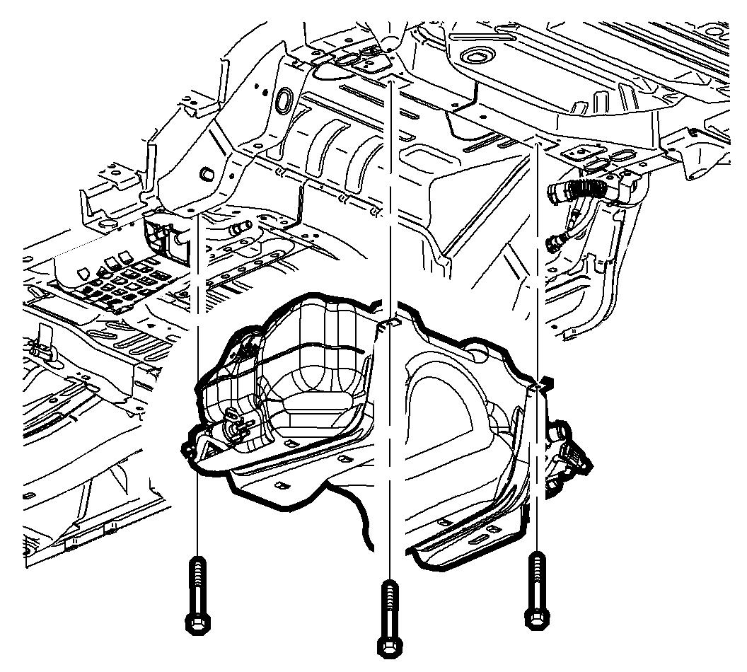

Here are directions for removal of the primary fuel tank module. In picture 2, I circled the module needing removed.
FUEL TANK MODULE REPLACEMENT - PRIMARY
TOOLS REQUIRED
J 45722 Fuel Tank Lock Ring Remover
REMOVAL PROCEDURE
1. Remove the fuel tank.
CAUTION: Whenever fuel line fittings are loosened or removed, wrap a shop cloth around the fitting and have an approved container available to collect any fuel.
NOTE: Clean all fuel pipe and hose connections and surrounding areas before disassembling to avoid possible contamination of the fuel system. Spray the fuel pump module cam-lock ring tang with penetrating oil prior to attempting removal.
2. Remove the secondary fuel pump module.
pic 2
3. Disconnect the electrical connectors from the primary fuel pump module and fuel tank pressure sensor.
4. Use the J 45722 and remove the fuel pump module retaining ring.
NOTE: To prevent retainer damage, do not attempt to remove the retainer with a 12 in. or shorter ratchet/breaker bar.
5. Disconnect the fuel feed and vent lines from the fuel tank.
6. Remove the primary fuel pump module assembly.
NOTE: To prevent bending of the sending unit float arm during removal, lift the pump module up slightly to disengage the orientation tabs in the tank and rotate the module 45 degrees.
7. Discard the fuel pump module-to-tank seal.
IMPORTANT: Always replace the fuel pump module-to-tank seal, O-ring, when the fuel pump module is removed.
8. If the fuel level sending unit is being replaced, remove the fuel level sender.

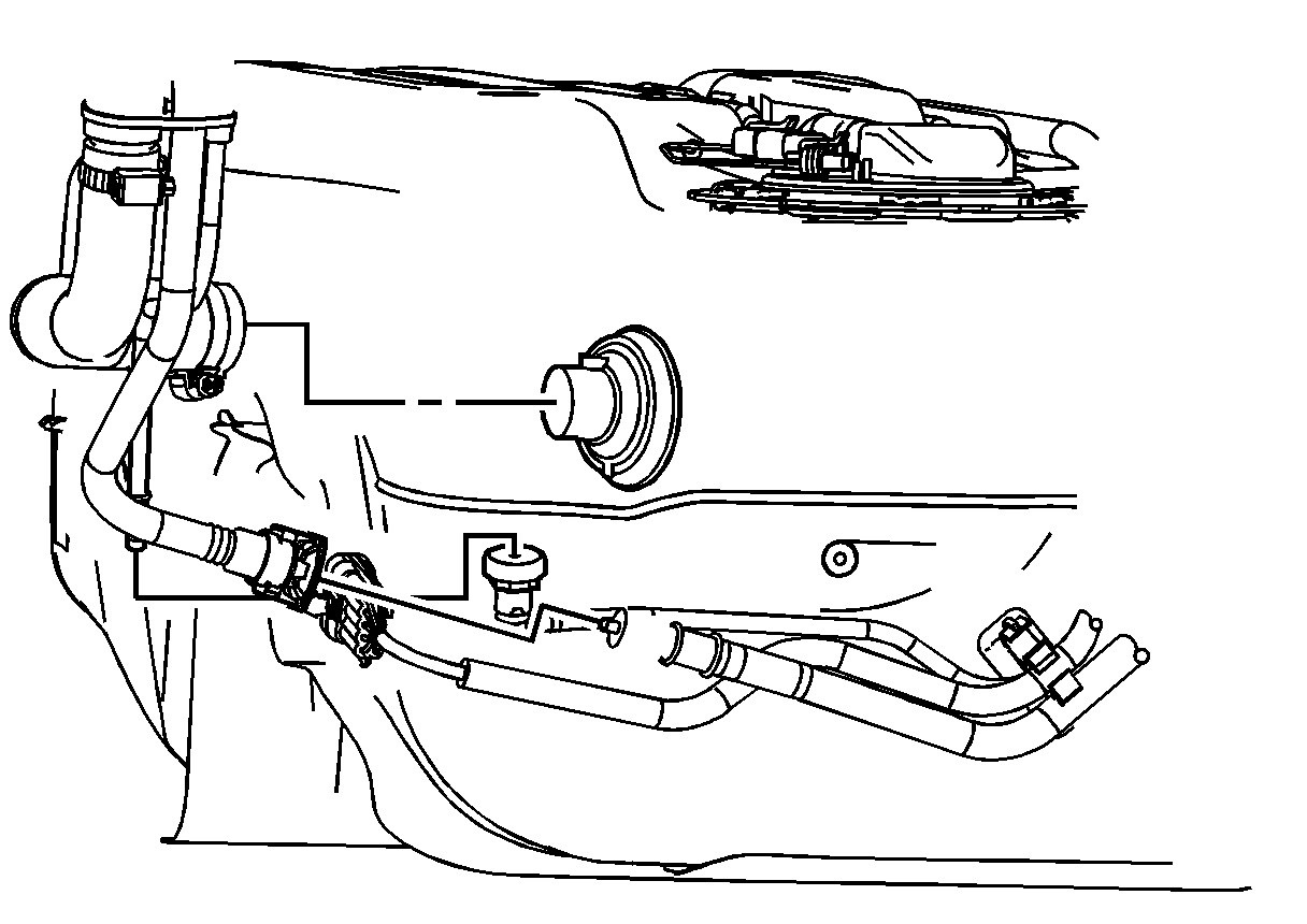

7. Disconnect the evaporative emission (EVAP) canister vent and fresh air hoses:
1. Grasping both sides of the quick-connect fitting, twist the female connector 1/4 turn in each direction in order to loosen dirt within the quick-connect fitting.
2. Blow any dirt out of the quick-connect fitting using compressed air.
3. Squeeze the plastic retainer release tabs.
4. Pull the connection apart.
5. Inspect both ends of the quick-connect fitting for dirt and burrs.
NOTE: Clean all fuel pipe connections and surrounding areas before disconnecting the fuel pipes to avoid contamination of the fuel system.

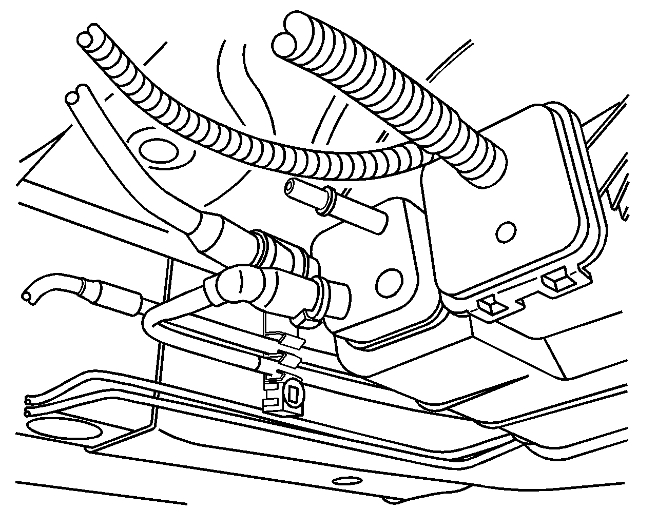

pic 6
8. Remove the fuel filler pipe, EVAP vent hose, and fresh air hose from the fuel tank.
9. Disconnect the chassis fuel supply line from the tank.
CAUTION: Whenever fuel lines are removed, catch fuel in an approved container. Container opening must be a minimum of 300 mm (12 in) diameter to adequately catch the fluid.

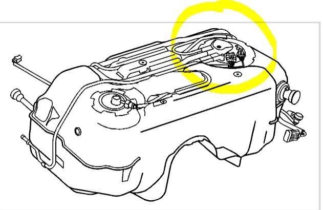

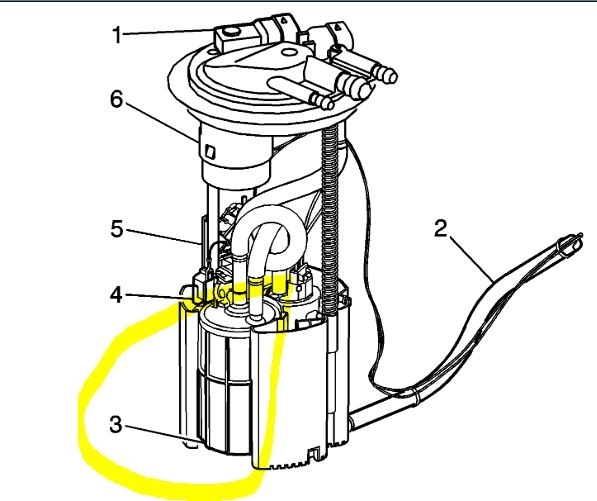

If you look at the last picture, it shows the fuel pump removed. I circled the filter and yes, this is all attached to module 1. One last thing, I would also recommend replacing the fuel pump strainer at the same time the pump is out. The fuel strainer attaches to the lower end of the primary fuel tank module. The fuel strainer is made of woven plastic. The functions of the fuel strainer are to filter contaminants and to wick fuel. The fuel strainer normally requires no maintenance. Fuel stoppage at this point indicates that the fuel tank contains an abnormal amount of sediment or contamination.
Let me know if any of this helps or if you have other questions. As far as an inline filter, it doesn't exist or at least it didn't come from the manufacturer with one.
