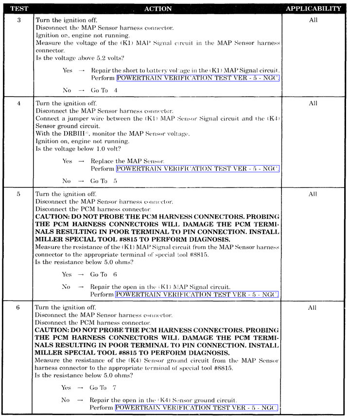

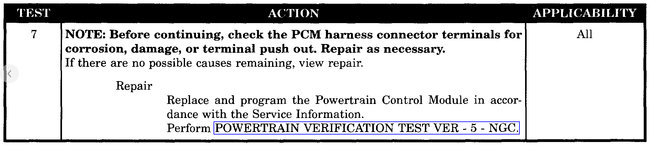

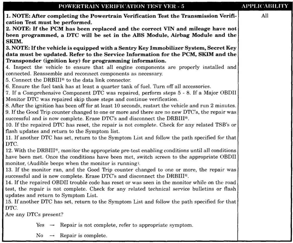

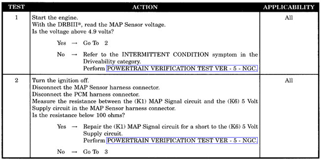

This is the pinout for the MAP. If you look at the MAP socket for the plug it should be an oval with 1 prong on top, 1 prong one each side and 2 prongs on the bottom. with the 2 prongs pointing at you left to right is, 5v power, Ground, MAP signal. The Grn/Rd is Map signal, black is ground and the last is power.
Here are the troubleshooting steps for a P0108 (Bottom images):
SYMPTOM
P0108-MAP SENSOR HIGH
WHEN MONITORED
Engine speed between 600 to 3500 RPM. TP sensor voltage less than 1.2 volts for greater than 1.7 seconds. Battery voltage greater than 10 volts.
SET CONDITION
The MAP sensor signal voltage is greater than 4.92 volts. One trip fault.
POSSIBLE CAUSES
- MAP sensor voltage above 4.9 Volts
- (K1) MAP signal circuit shorted to (K6) 5 Volt supply circuit
- (K1) MAP signal circuit shorted to battery voltage
- MAP sensor internal failure
- (K1) MAP signal circuit open
- (K4) sensor ground circuit open
- PCM
Let me know how it goes. Rich
