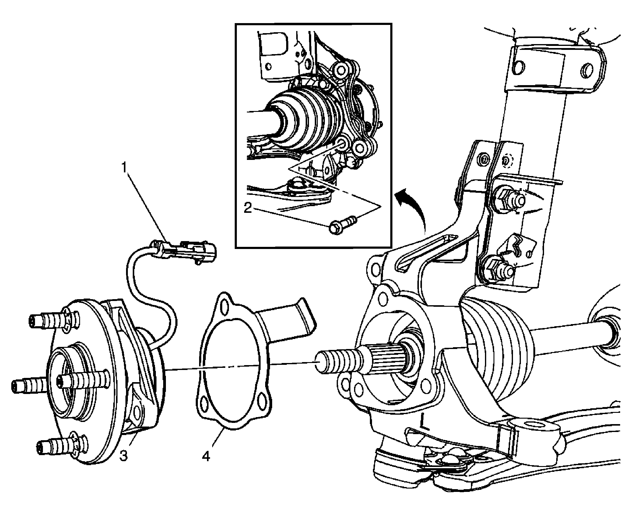

I am curious if I will need to compress any springs or need any special equipment to replace a wheel bearing? I saw a YouTube video on how to replace it and it seemed straight forward until someone mentioned I might need to compress some suspension springs to do it? Any advice you can give?

Standard or automatic transmission?

Automatic.

This is what the hub assembly on a Cobalt with an automatic looks like. I do not see any springs that need compressing.

This is exactly my problem! Someone said I would need special equipment to do this job as a novice and I would need to compress the suspension springs, but I literally do not see a need for it. Is there anything I should be aware of in terms of doing this replacement? It seems like a really straightforward repair.

Just to add to this one. it is a very straight forward repair. rent an axle socket to remove the axle nut.
