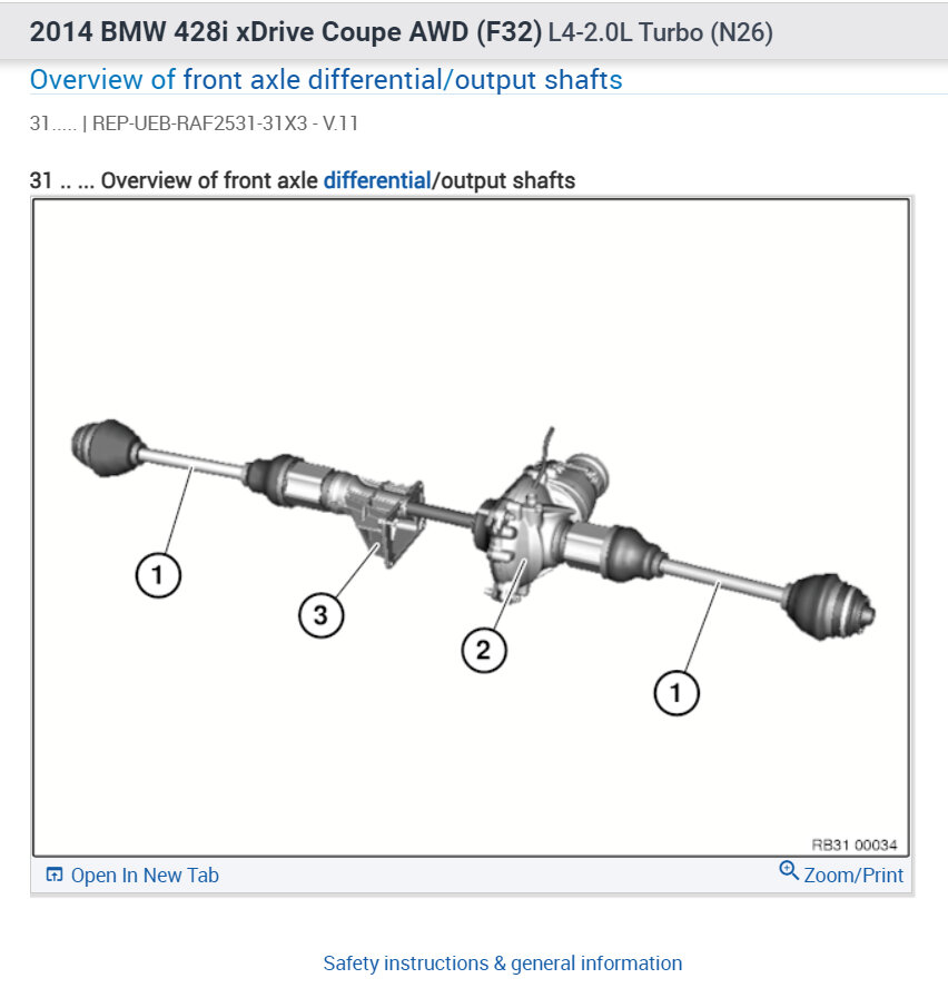

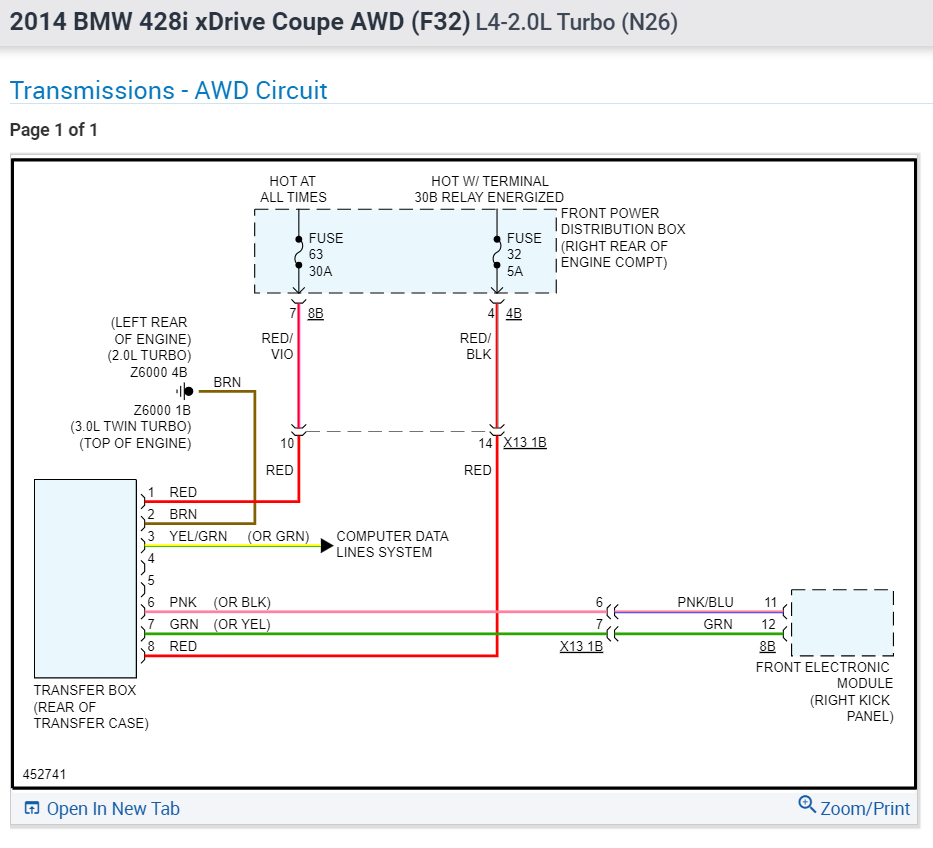

I bought this car with this issue where the front kind of hops on low speeds like it stutters, this is a 14 428i x drive, but i didn't see an option for it. How can i convert it to a 2wd to see if it's the transfer case or axle issue? No clicking from any of the axles.

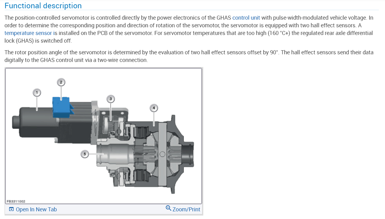

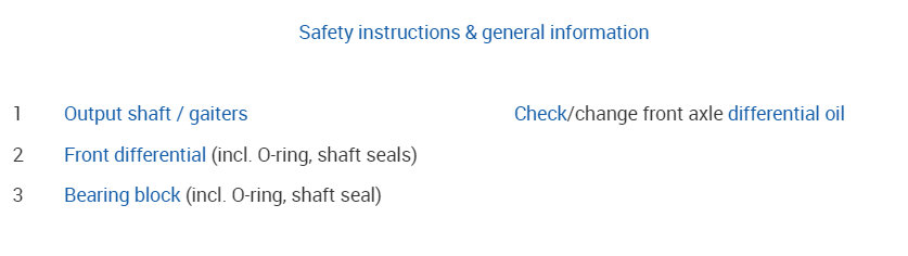

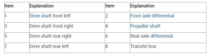

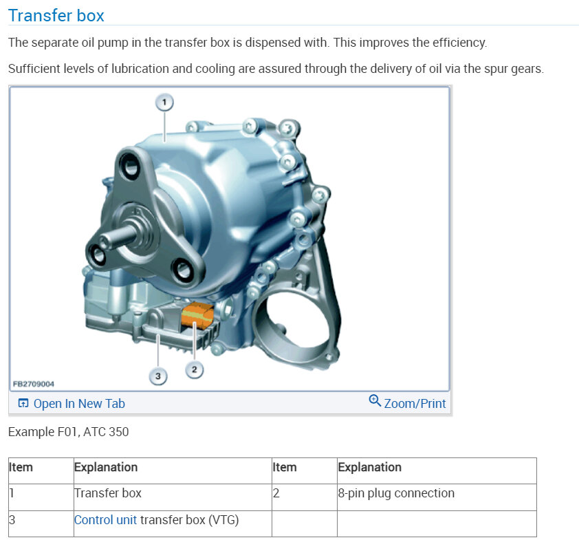

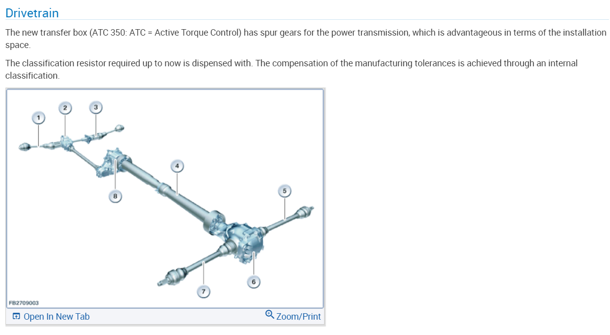

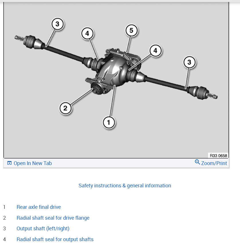

The only way to make it into a 2wd is to remove the front driveline, but I would raise the front of the vehicle to spin the front tires, if they spin in the same direction the differential is no good, also do the same for the rear, either differential can cause this issue. Here is information on the system, also you should do a CAN scan. You can get a CAN scanner (Controller Area Network) which will work on most cars from Amazon.

Move it by hand, you are working the spider gears to see if they are locked up.

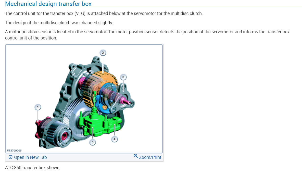

Jacked it on all 4, turned one front wheel to the front the other side turned back.
Sep 11, 2023 at 2:19 AM
BHAMDOC1973
  • 2,007 POSTS
Removed front shaft and all is good. So am guessing either fluid in transfer case needs changing or assembly is bad.
Sep 11, 2023 at 3:22 AM
  • 55,256 POSTS
Yep, that is what it sounds like.
