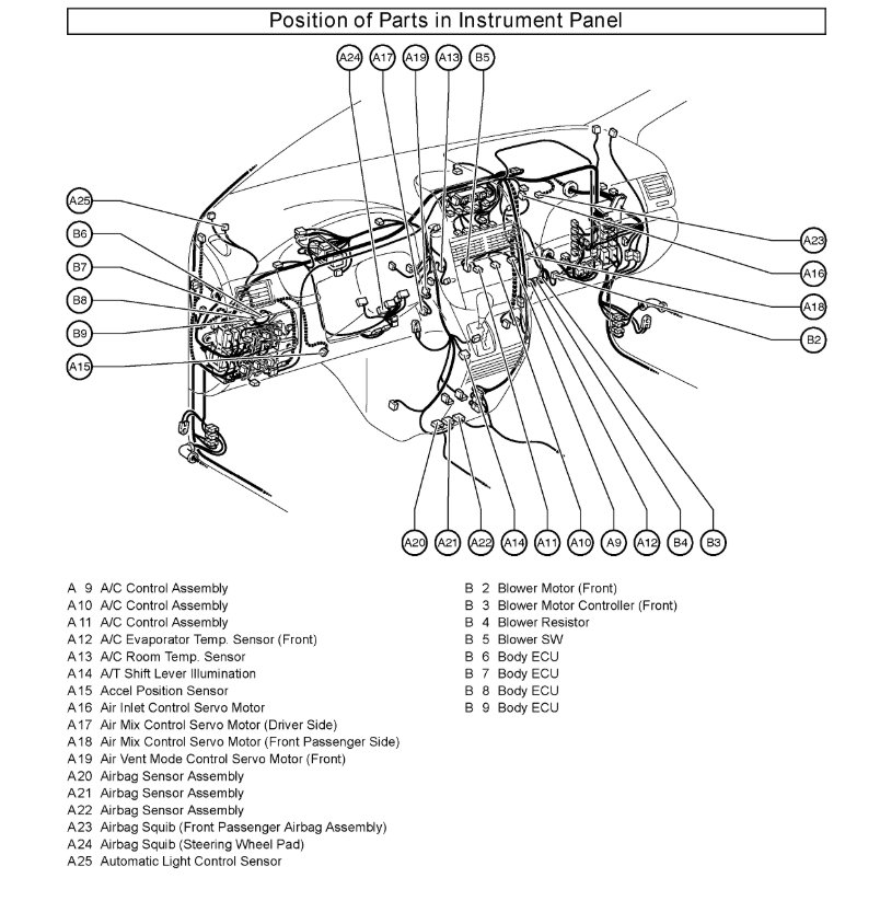

Driver's side blows hot air and passenger side blows cold air.
Sep 18, 2019 at 10:50 AM
  • 54,832 POSTS
Can I ask which side is working correctly? It sounds like the opposite side needs a bled door actuator which is common. here are the instructions on how to change it with a guide to walk you through the steps:
Check out the diagrams (below). Please let us know what you find. We are interested to see what it is. Can you please shoot a quick video with your phone so we can see what's going on, that would be great. You can upload it here with your response.
