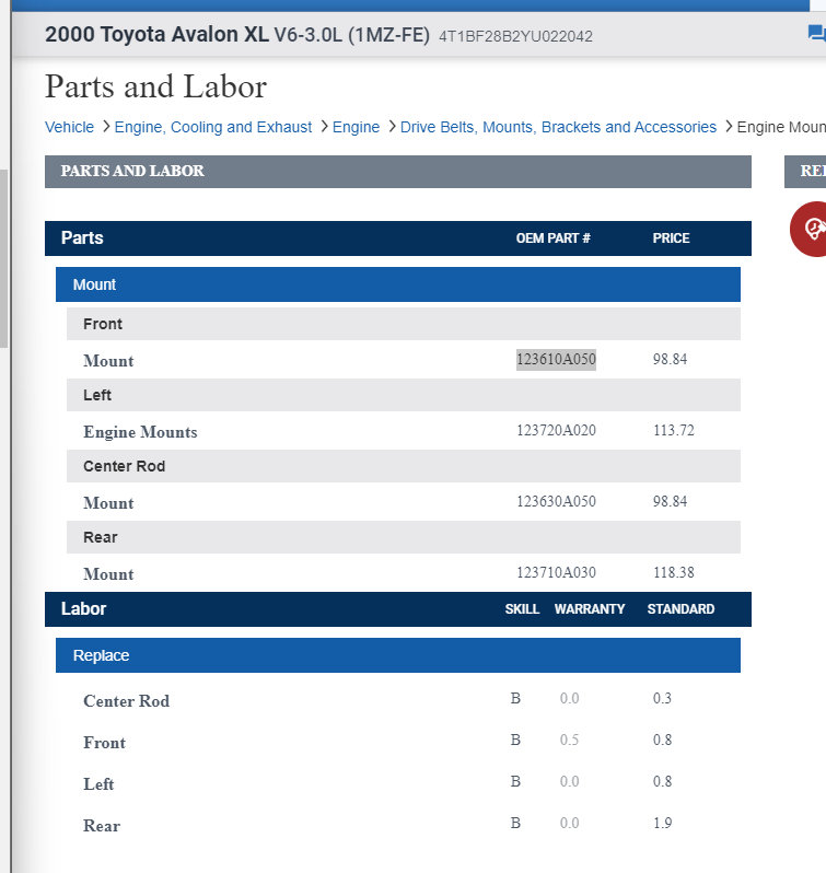

Please tell me this:
VIN: 4T1BF28B2YU022042

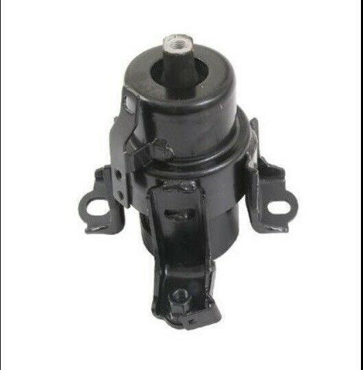

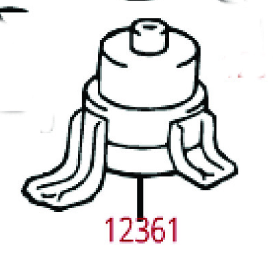

Is there or is there not a vacuum fitting
on the Toyota Part No.12361-0A050
Insulator, engine mounting, front.
(that is front motor/engine mount?)
Online search results are confusing. They show me two similar front mounts,
with and without Vacuum Fitting, that fit my 2000 Toyota Avalon.
Toyotapartsdeal.com does not give that explanation online either.
So please help me to avoid this confusion.
Albert
Jan 22, 2017 at 1:02 PM
Take a look at the picture below. This engine mount does not include a vacuum fitting. Most engine mounts do not have vacuum fittings. There are some out there that are hydraulic or vacuum activated mounts but this vehicle does not have that option.
