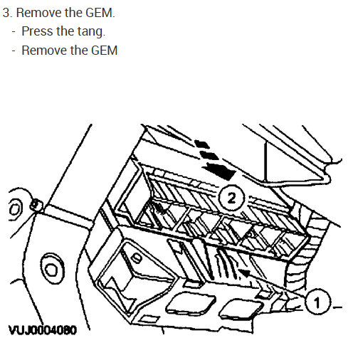

Only the parking lights and passenger side headlight worked when I bought the car. The turn signals were working but while I was looking behind the drivers headlight I think I might have crossed some bare wires because the headlight and everything started flashing on and off and then they stopped flashing, Now the turn signals and drivers side along with High beam lights are not working. Is there a fuse that could have blown when the wires crossed that I can change and get my turn signals and also the Drivers side head light
working again?
I looked in my book that came with the car and don't see a fuse called out for turn signals or headlights. What am I missing ?? I thank anyone for any help you can provide. Thanks

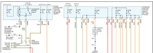

Yes, the car could have a bad fuse.
Here is a guide to help check fuses:
Does this car have the trailer tow package? If the fuses are okay this car has a GEM module that can go out and cause this issue, but I would repair the wiring before replacing it, so it does not blow out again. Here are the fuses and the location of the GEM which is under the dash so you can check it out. The GEM is plug and play so there is no programming needed. Check out the images (below). Let us know what you find.
