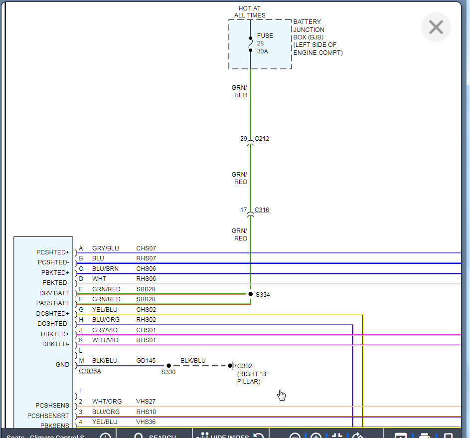

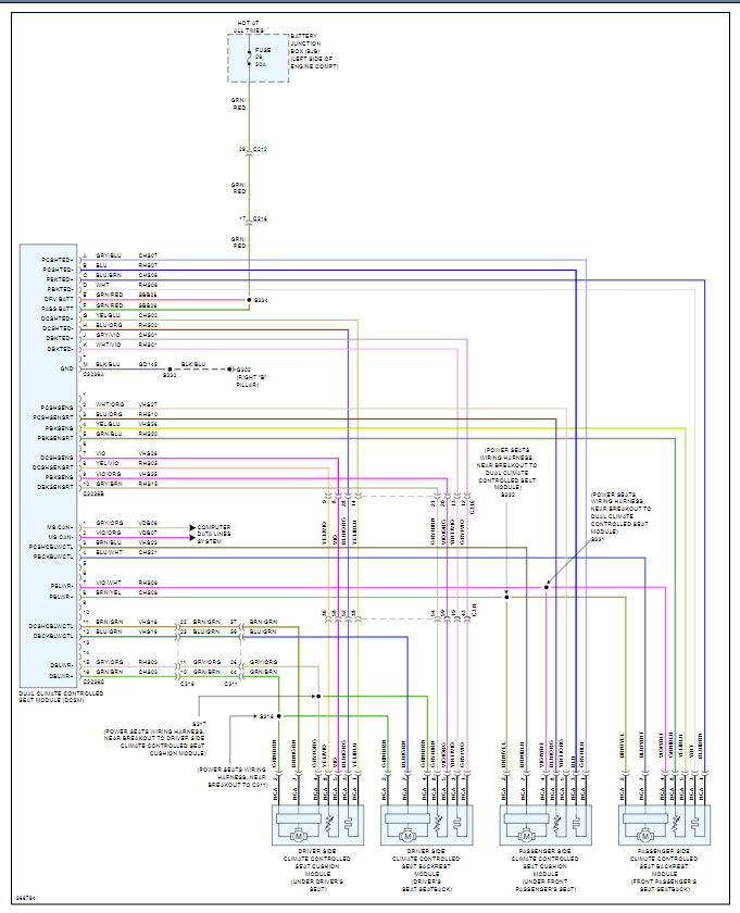

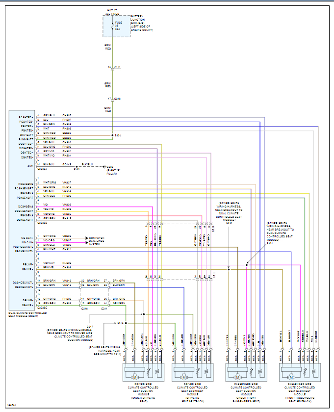

My heated and cooled front seats stopped working, my heated steering and rear heated seats still work. When I click to turn them on it says they are on but nothing happens. Not quite sure what the issue is checked fuses and they are all good. Any ideas appreciated.
Feb 14, 2021 at 12:54 PM

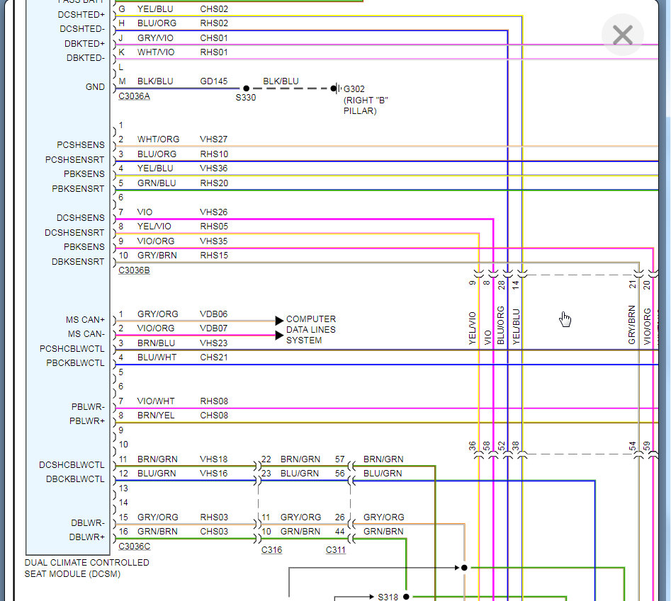

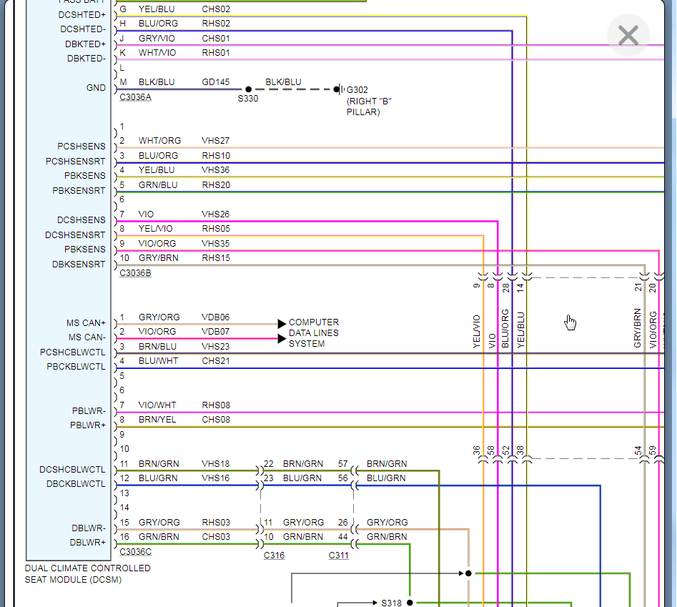

More than likely the issue is the Dual Climate Controlled Seat Module. This is what is responsible for turning both front seats on and if the button is showing they are on but they are not actually coming on then it would have to be something in common with them. We need to check the fuse for this module which is in the battery junction block fuse 28.
If this is okay then we are left with the module or all the elements which is highly unlikely that they would all fail at the same time. I would check the voltage at the elements in the seat and then go to the module and check the same wire. I suspect you will not find voltage on it which indicates the module has failed.
I attached the info below on this. Let us know if you have questions. Thanks

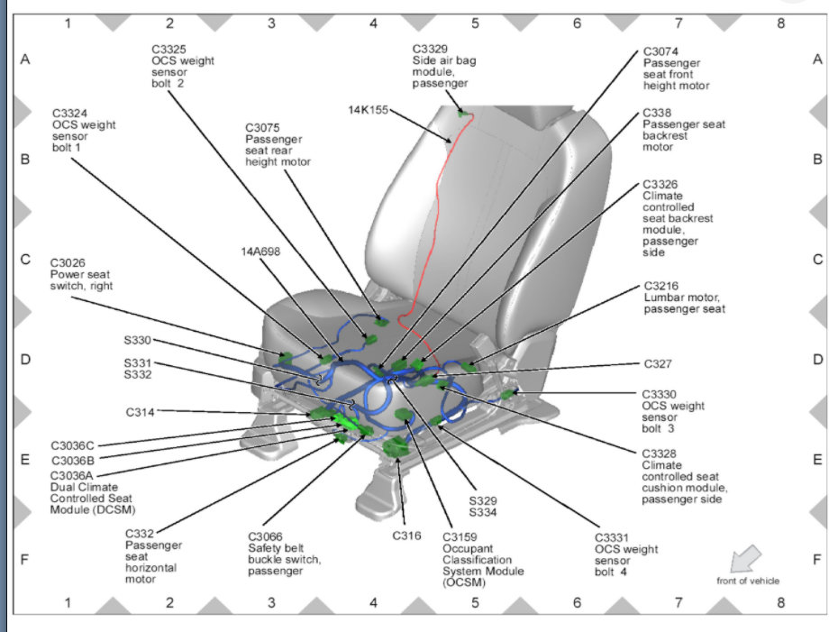

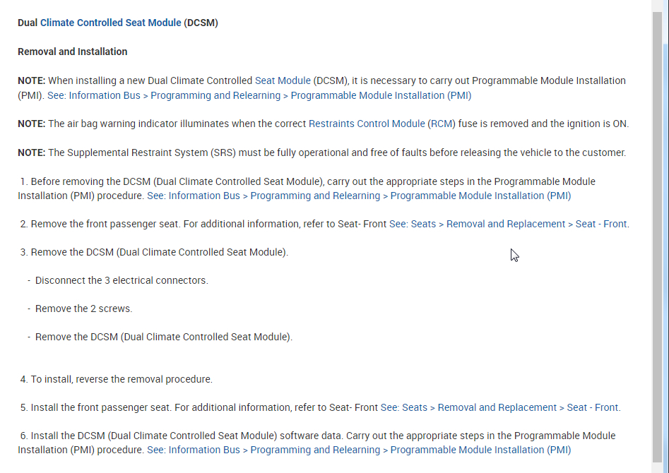

I checked the fuse and it’s good, also is the DSCM under the driver or passenger seat. I also ordered a new voltmeter because of course when I need it mine breaks, I will test the voltage when it comes in on Wednesday and let you know the results.
Feb 15, 2021 at 9:15 AM
It never fails. Whenever you need something it is either broken or lost.

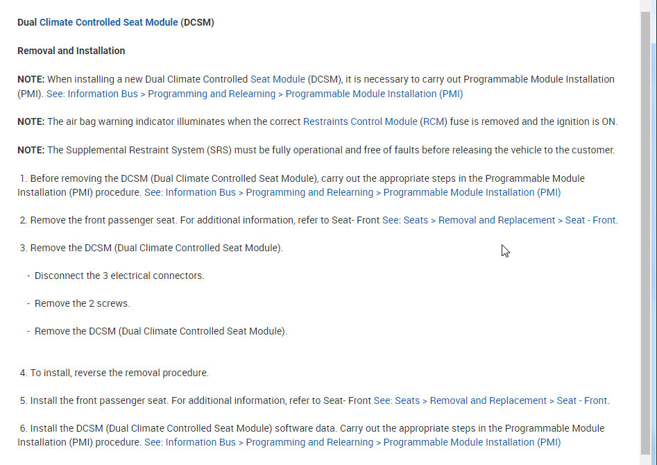

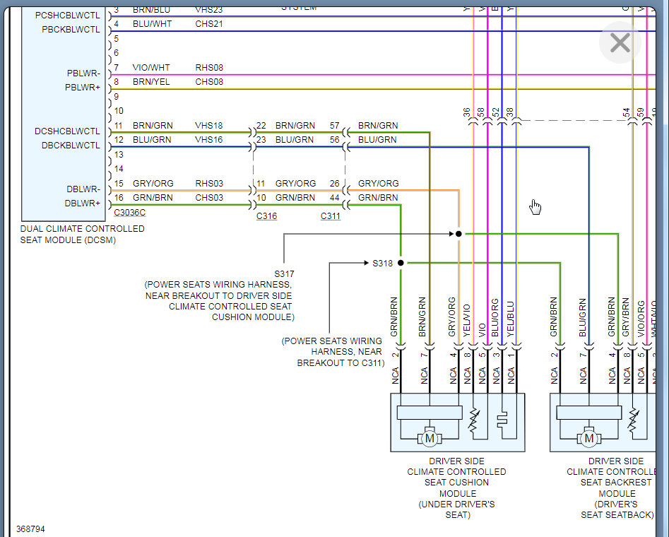

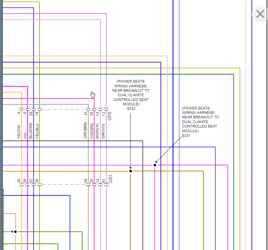

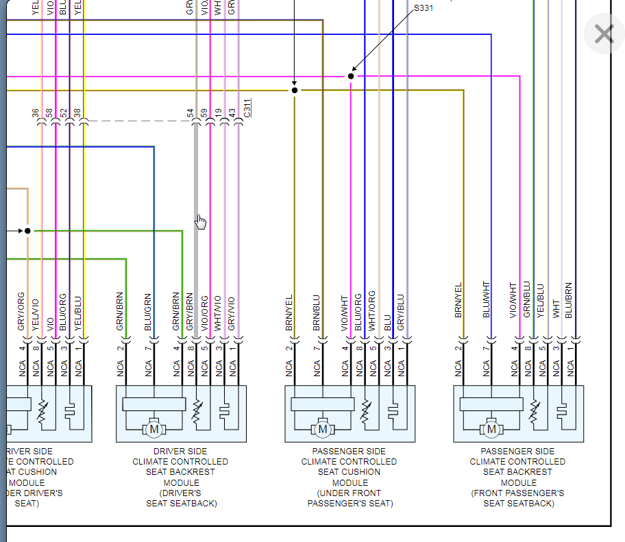

The last attachment was the replacement procedure in case you needed it. However, I attached it below again to make it easier, plus I added a view of the passenger seat that shows the connectors.

Sorry for the late response. I got under the seat and on one of the connectors on the DSCM is absolutely destroyed... any ideas/part links to fix this?
