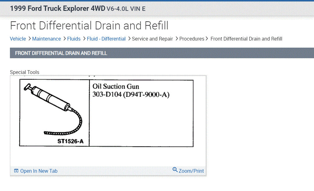

After using 4-wheel drive a week or so later I've noticed a whining noise up front even when the 4-wheel drive switch is in auto.
Feb 18, 2022 at 9:06 AM
  • 110,241 POSTS

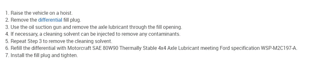

If it's coming from the front, have you checked the fluid in the differential? There is a fill plug on it. Remove the fill plug. The fluid level should be even with the bottom of the plughole.
Check that first. If it is low, you either should add to it or service it. I attached the directions below for the service.
Let me know if this helps or if you have other questions. Additionally, let me know if there is anything that changes the pitch or intensity of the noise. If it's loud enough for you to record, do that and upload it for me to hear.
