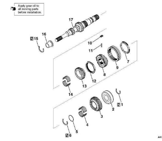

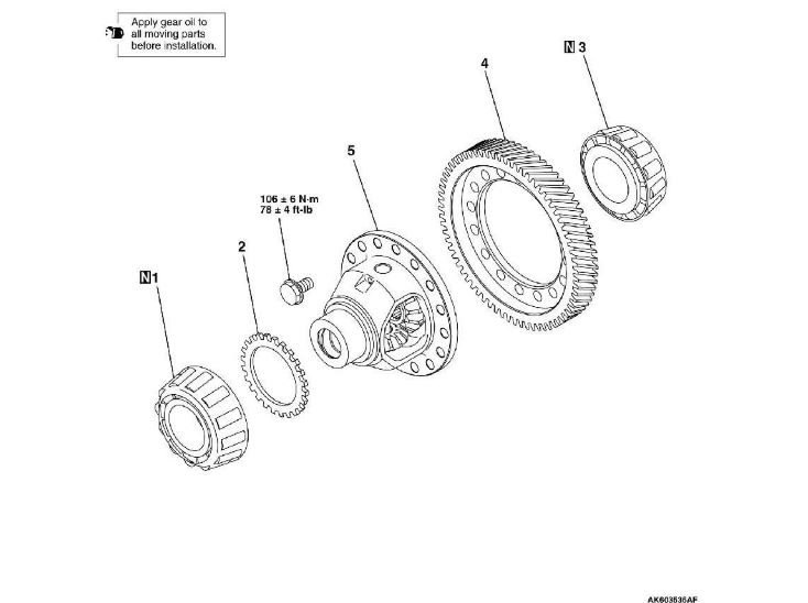

Could you please send to me exploded drawing related front differential?
Thanks
Apr 30, 2020 at 5:40 AM

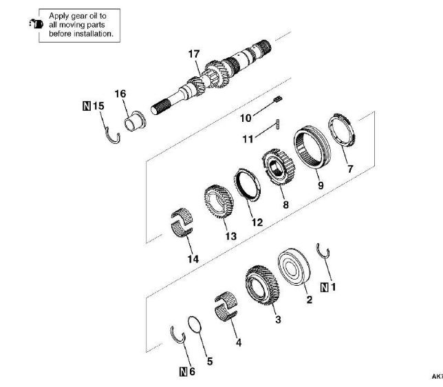

Good afternoon,
I attached pictures of the carrier assembly and the main shaft that has the pinion gear on it that goes against the ring gear.
What is the issue that you have?
