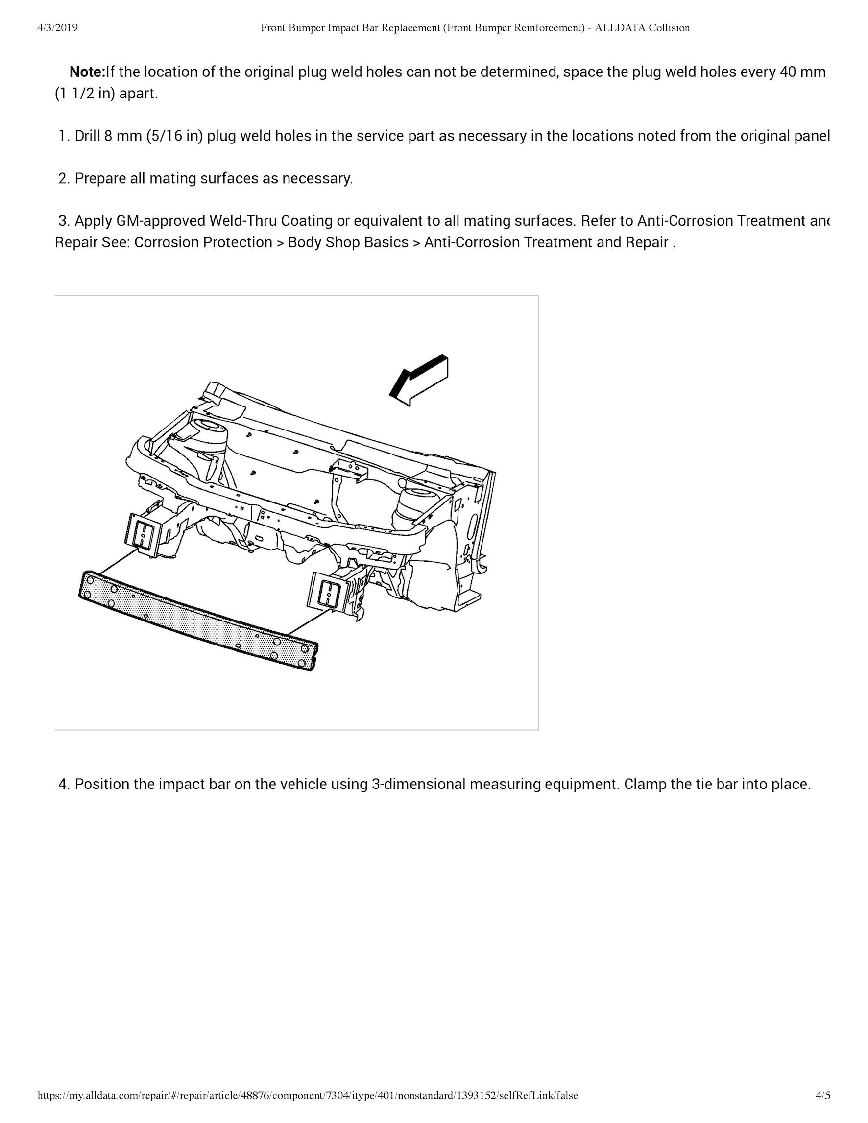

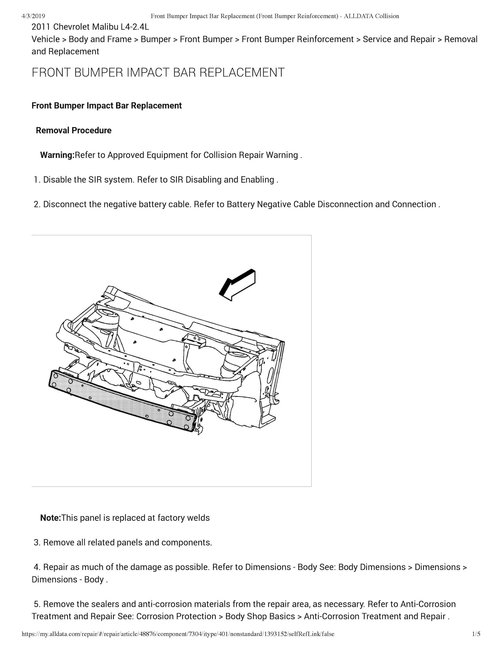

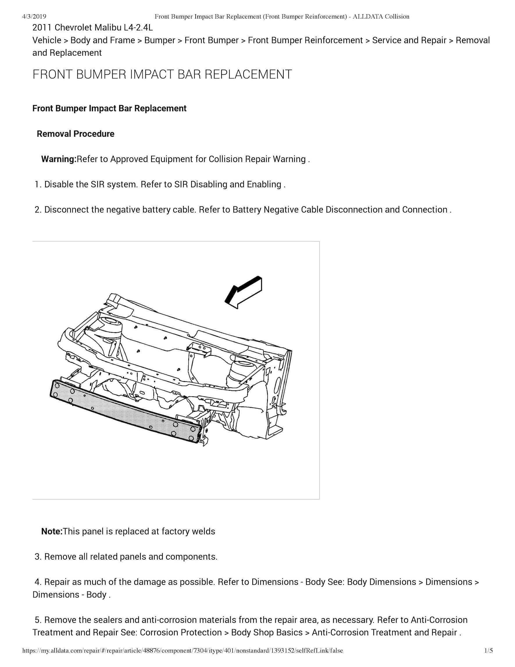

I was wondering how to remove the front bumper reinforcement bar which is bent. I am looking to replace it but can't remove it. I see no screws or bolts or nothing it looks like it is welded onto the car. Please help!

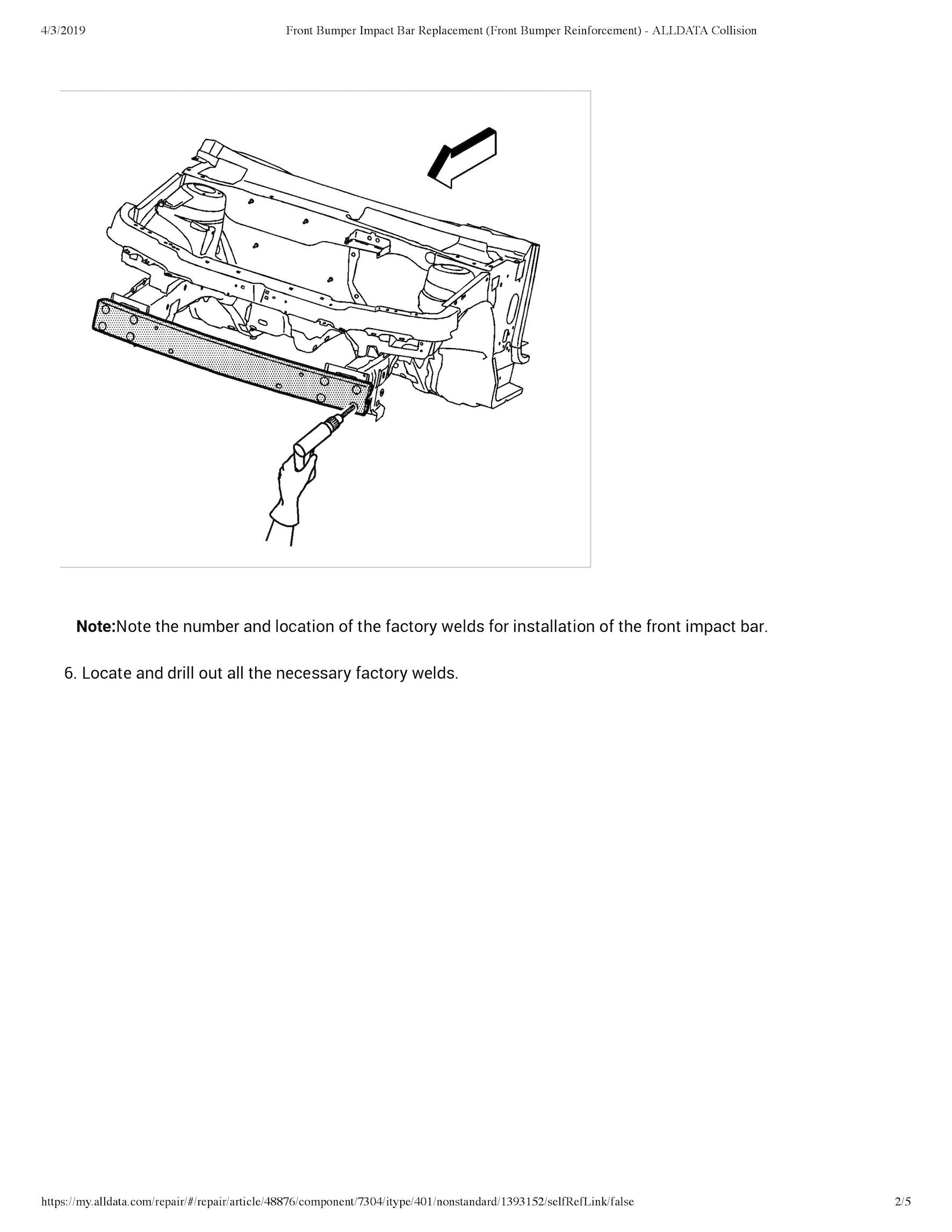

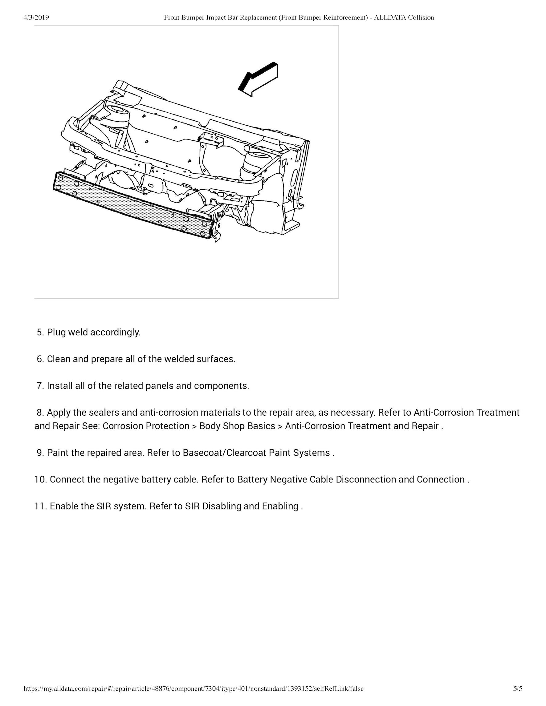

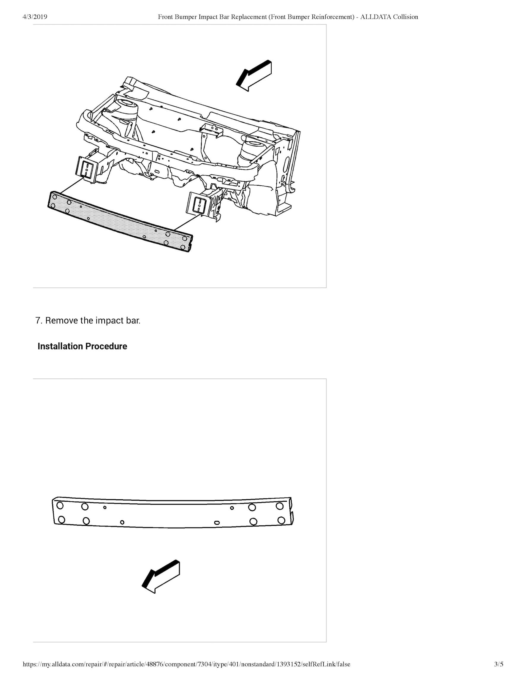

You are correct it is welded on.
You would have to drill out the welds and then weld on a new bumper impact bar.
I can provide you with the instructions if this is a job you are looking to undertake?
It is a part of the strengthening of the front of the vehicle so probably best carried out by a body shop.

No problem below are the instructions to replace the front bumper impact bar.
Let me know if you need anything else, it sounds like you already have the bumper removed? I can get you instructions for bumper removal also if you need.

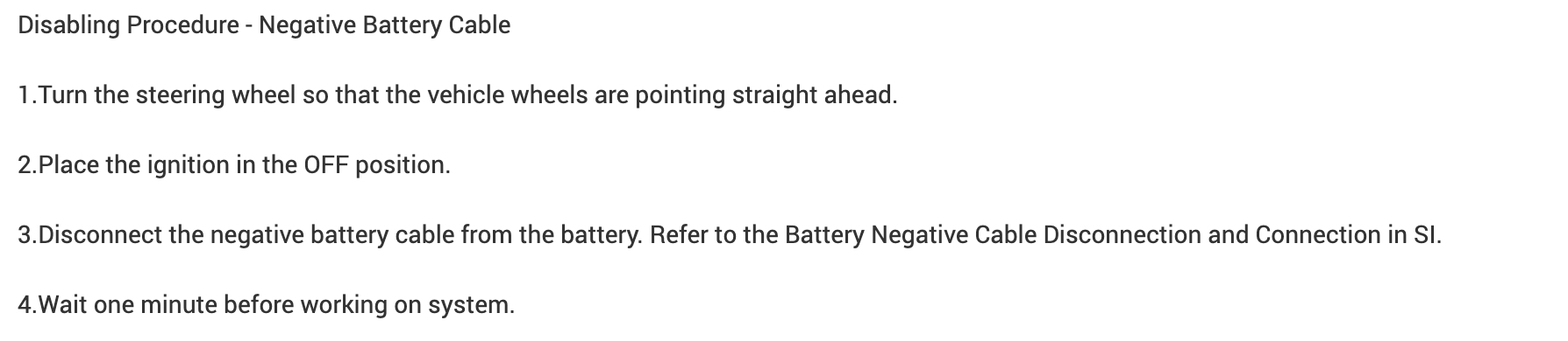

JOETECHPRO
  • 705 POSTS
Hey BCB. JAHHH,
The instructions to disable the SIR (supplemental inflatable restraint) are below.
Regards, Joe

The impact bar is spot welded on, you will need to locate these spot welds and then drill to remove them.
You can get specialized drill bits designed for removing spot welds whilst keeping as much metal as possible.
