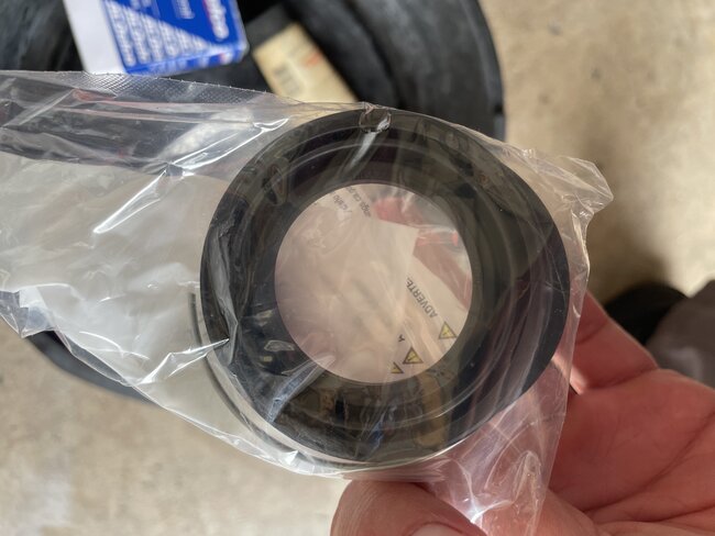

I was told to remove the caliper while one person is in vehicle continuously pressing the brake while the other person catches the piston when it comes out the caliper. Then applying thin layer around the piston after replacing dust boot cover etc.

First feel on the new dust boot if there's a hard metal ring embedded on the outer edge. If there is, you don't have to remove the piston. For a competent do-it-yourselfer, a nifty trick is to drill a small hole through the rubber and that metal ring, then thread in a wood screw. As it is tightened, that screw will pull the boot out. Then it's just a matter of pulling it off the piston and popping the new boot on.

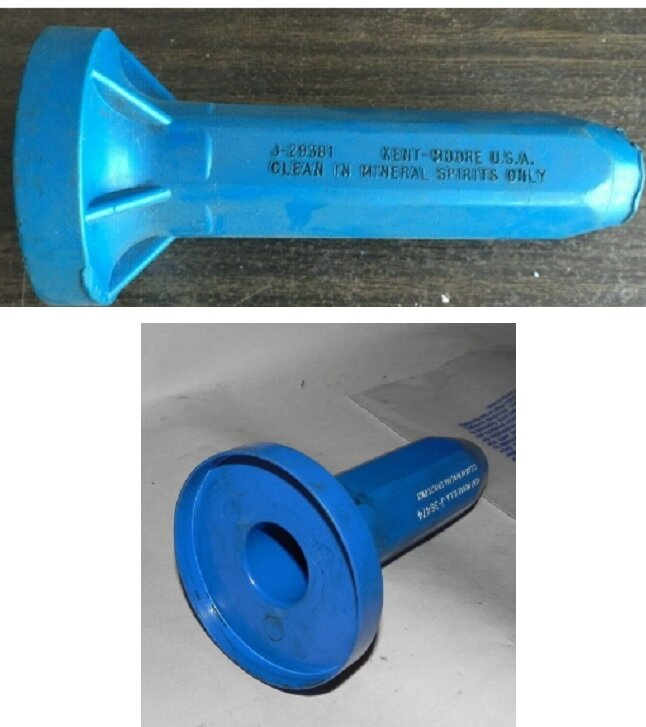

Pull the boot over the piston and engage it in the piston's groove. To seat the metal ring, there is a special tool that makes the job rather easy. The photo below shows GM's version. They love special tools, and with this design, you have to find the right diameter for your application. Mine is metal and has a half dozen cones in different sizes. You pick the right one, then screw the handle onto it. These tools ensure the metal ring doesn't become deformed and that is fully seated all the way around. The only problem is they might not work with the piston still in the housing.
The next alternative is to tap the boot in with a small hammer and a really wide flat-blade screwdriver. Tap the ring in a little at a time as you work your way around.
Older Fords and Chryslers used a different boot design where there was a lip molded as part of the boot, that went into a groove in the caliper housing. That groove had to be cleaned out really well for the lip to seat, otherwise it could prevent the piston from releasing freely. As soon as the piston was inserted a little way, it trapped that lip in the groove so it couldn't pull out. Chrysler boots went together very easily. For some reason, I always had a lot of frustration with Ford boots. If your new boot does not have a hard ring on the outer edge, it will have that rubber lip too. Then the piston will have to be removed.
