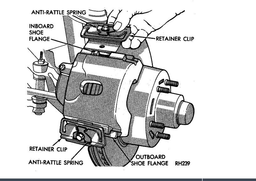

I cannot get the front driver side brake pads off. Is there a trick to it?

Good afternoon,
I attached the procedure for you to remove the caliper and the pads.
What is the issue? Can you upload a picture of the issue?
REMOVAL
1. Raise and support vehicle.
2. Remove front wheel and tire assemblies.
Retainer Clips And Anti-Rattle Springs
3. Remove caliper mounting bolts, retaining clips and anti-rattle springs.
4. Remove caliper by tilting it rearward and lifting up and off rotor.

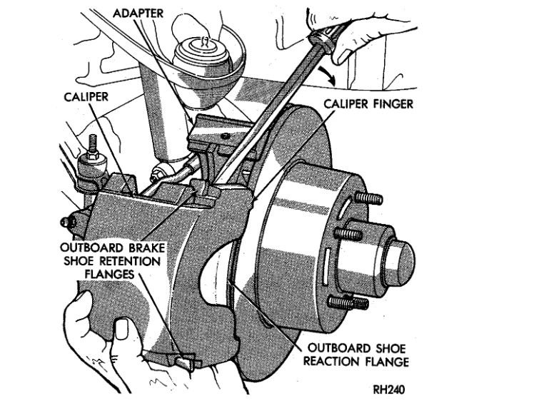

Removing Outboard Brakeshoe
5. Remove outboard brake shoe from caliper. Use pry tool to remove shoe from caliper if flanges are tight.

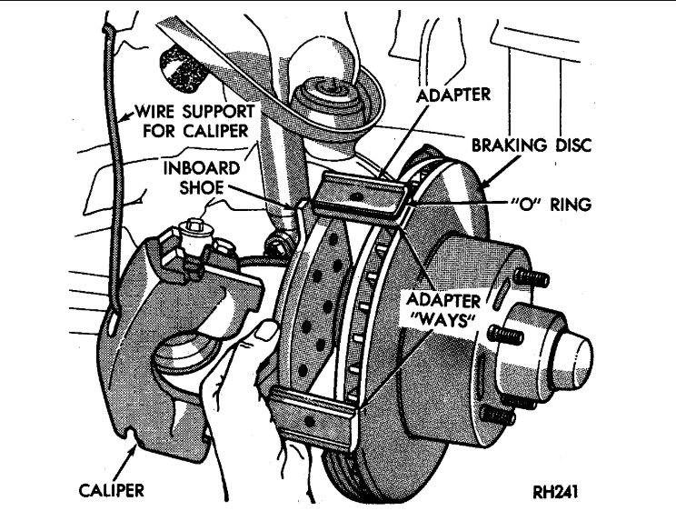

Inboard Brakeshoe
6. Remove inboard brake shoe from caliper mounting adapter.
7. Support caliper, do not allow brake hose to support weight of caliper.
8. Remove 0-ring from caliper adapter.
