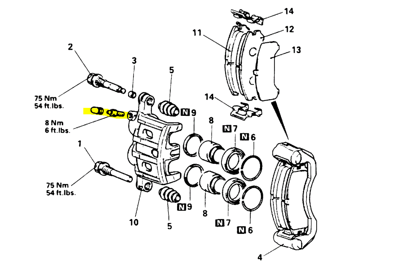

Just got a new set of rims for my vehicle listed above and everything seemed to be working fine. after a couple of months i got an alignment everything was fine. then i started to smell brakes now my driver's side wheel doesn't want to spin.

The idea that it is only one side makes this easier. Either you have a bad caliper (piston frozen), the slide pins need cleaned and lubricated, or the brake hose (rubber one) has collapsed internally and isn't allowing fluid to return the the master cylinder.
Do this first. Safely lift that wheel off the ground. When the wheel is locked, open the bleeder on the brake caliper and see if the brakes release. I attached a pic below showing the bleeder.
Do this and let me know what happens. Also, let me know if you have other questions.

The first thing to suspect is the pressurized brake fluid is being trapped somewhere and can't release back to the reservoir. To verify that, raise that wheel off the ground when it is locking up, and open the bleeder screw on that caliper. If that lets that brake release, we'll have to repeat the procedure by opening that hydraulic circuit in other places to determine where the line is blocked.
If opening the system works no matter where you open it, even all the way back to the master cylinder, it is likely the brake fluid has become contaminated with a petroleum product. That will cause all the rubber seals and all the other rubber parts that contact the brake fluid to swell. That gets to be a very expensive repair. A clue to petroleum contamination is when you remove the cap from the reservoir, the rubber bladder seal will be blown up and mushy, and you will find it very difficult to get the cap back on.
If opening the bleeder screw on the caliper does not let the brake release, that caliper is sticking. First inspect the mounting hardware for damage or rusted parts that are preventing the caliper from sliding freely. Use a large flat-blade screwdriver to try to pry the piston back into the caliper housing. Some force will be needed, but it should slide fairly easily by hand. If you can't retract the piston, even with the bleeder screw open, that caliper must be replaced or rebuilt. We always replace or rebuild both at the same time to maintain balanced brakes.

it seems that when i loosen the lug nuts it rolls a lot easier when i tighten them and it wont turn.

Thanks guys. it was definitely the caliber rebuilt that bad boy she runs like a champ.
